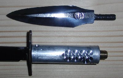

mini pneumatic ballistic knife

Hmm..a friend just pointed this out to me..
made out of plastic but still cool...
Hehe first thing I though when I saw it. Pretty nifty though.al-xg wrote:You wouldn't want to rest your head and lean on your elbow with that on

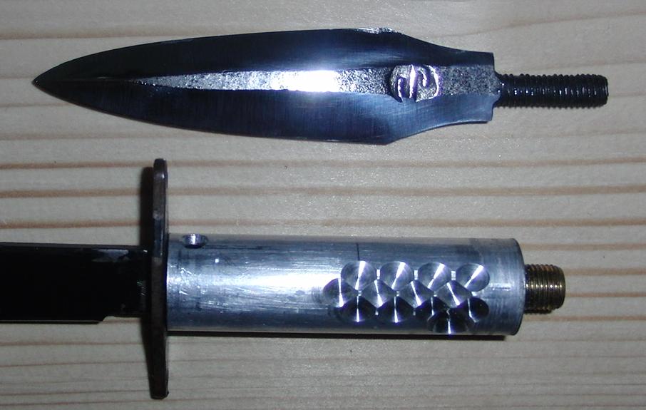

thats really cool. I love that the knife is the chamber basically. Im already working on a plastic version 8)

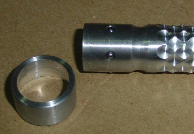

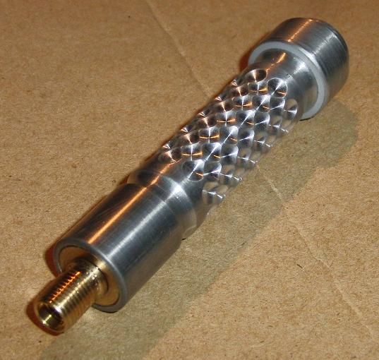

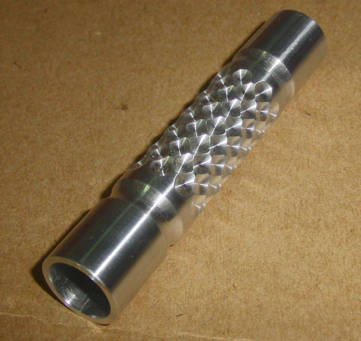

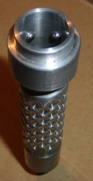

I've been thinking about the surface finish for the handle that I will use with jake's blade, I think a denser take on the "dimply" concept just might work...

Holy crap that looks amazing!!

woa thats incredibly nice!!!!
Cheers guys, really happy with how this is coming along

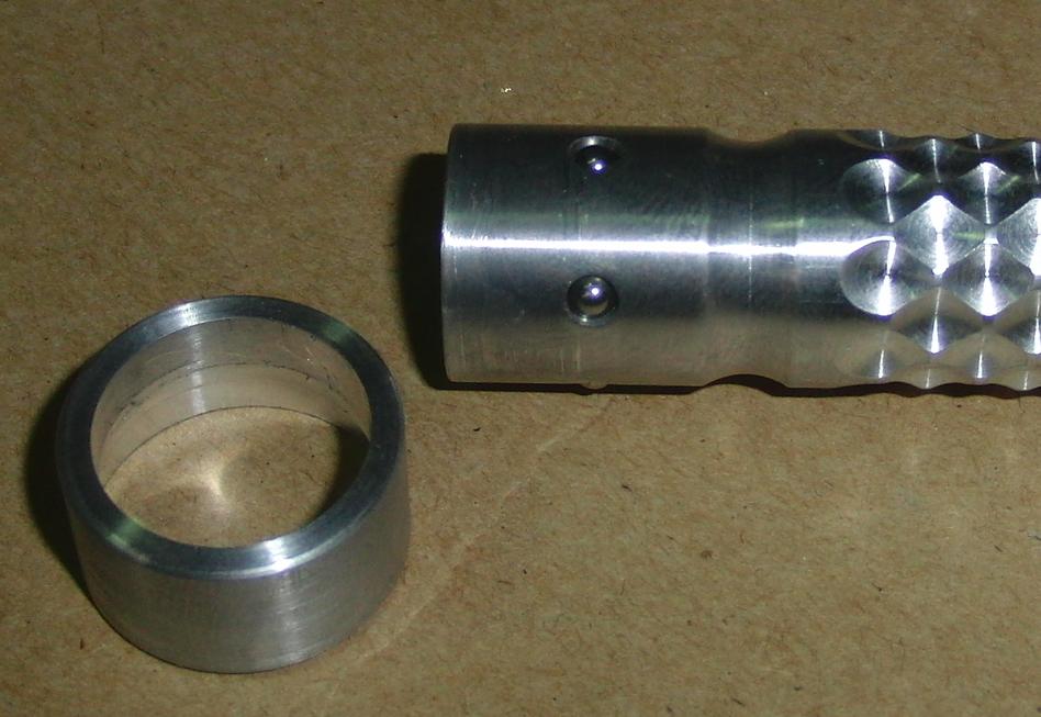

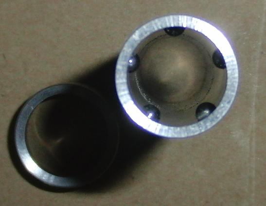

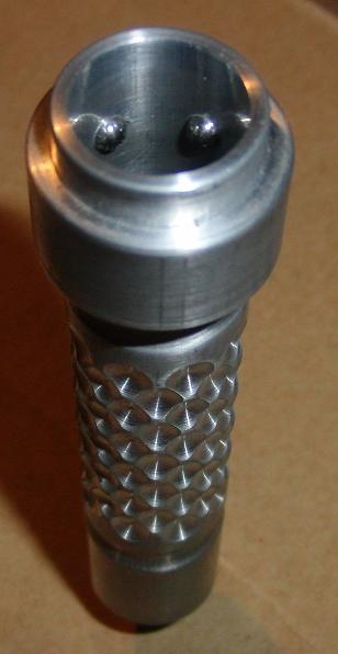

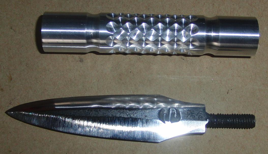

working on the firing mechanism, I've gone for a 5 point detent which should hopefully spread the load and make it a bit easier to trigger, as well as reducing wear on the "tail" section.

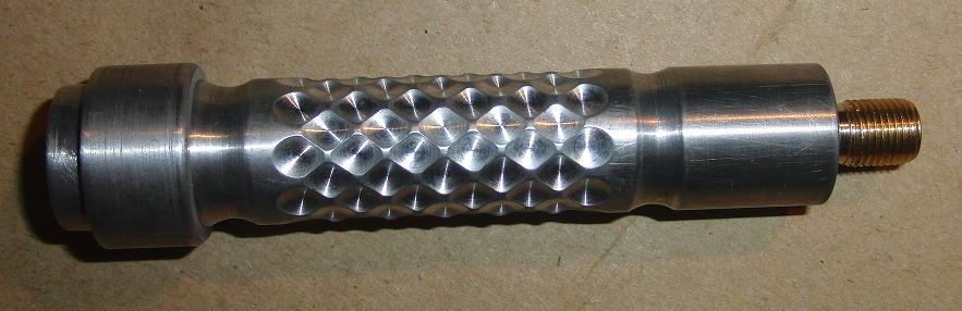

Beautiful work!
Must have taken quite some time I guess?
99 individual ball mill strokes, didn't take that long to be honest, the rotary table makes it easy - you just have to maintain your concentration because one wrong measurement and you can bin it - amazingly I got it right first time, though admittedly I did give it a go on the old knife body first.Labtecpower wrote:Must have taken quite some time I guess?

I would probably lose my concentration for a few seconds (aspie
) and make some stupid mistake
Does it give a lot of extra grip?
