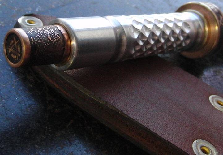

Version 2 of my pneumatic ballistic knife using the same concept but with more attention to detail and most impressive of all, a fantastic dagger blade crafted by jakethebeast which really sets it off.
There's room for refinement in the "tail" and I would like to make the collar bigger diameter to make it easier to trigger, but as I've got it to firing stage, here it is:

Nice. I saw the video right after you uploaded, and then knew that you would be posting the completed product soon! It looks excellent. Whats the operating pressure?

How high will you dare go pressure wise ?

looks great, Id throw some grooves or knurling on the collar and maybe a tail cap to protect the shrader. Does it hold pressure for extended periods? Awesome job

Is the sleeve held on by any means?
I'm thinking a slot in the knife body with a grub screw in the sleeve to limit movement would work in that respect.

How high will you dare go pressure wise?
I'm happy to take it to 800 in terms of construction, the problem is collar stiffness, as it is at 350 you can barely push it with your thumb. It definitely needs a wider diameter collar for easier firing, unfortunately the brass of the appropriate diameter I had set aside was all used to make jake's valve :roll:
Both on my "to do" list :)
Yes, a stop of some sort is also planned, there are some unaired "fail" videos where I push the collar too far and the balls shoot out in all directions like some miniature schrapnellmine :oops:
