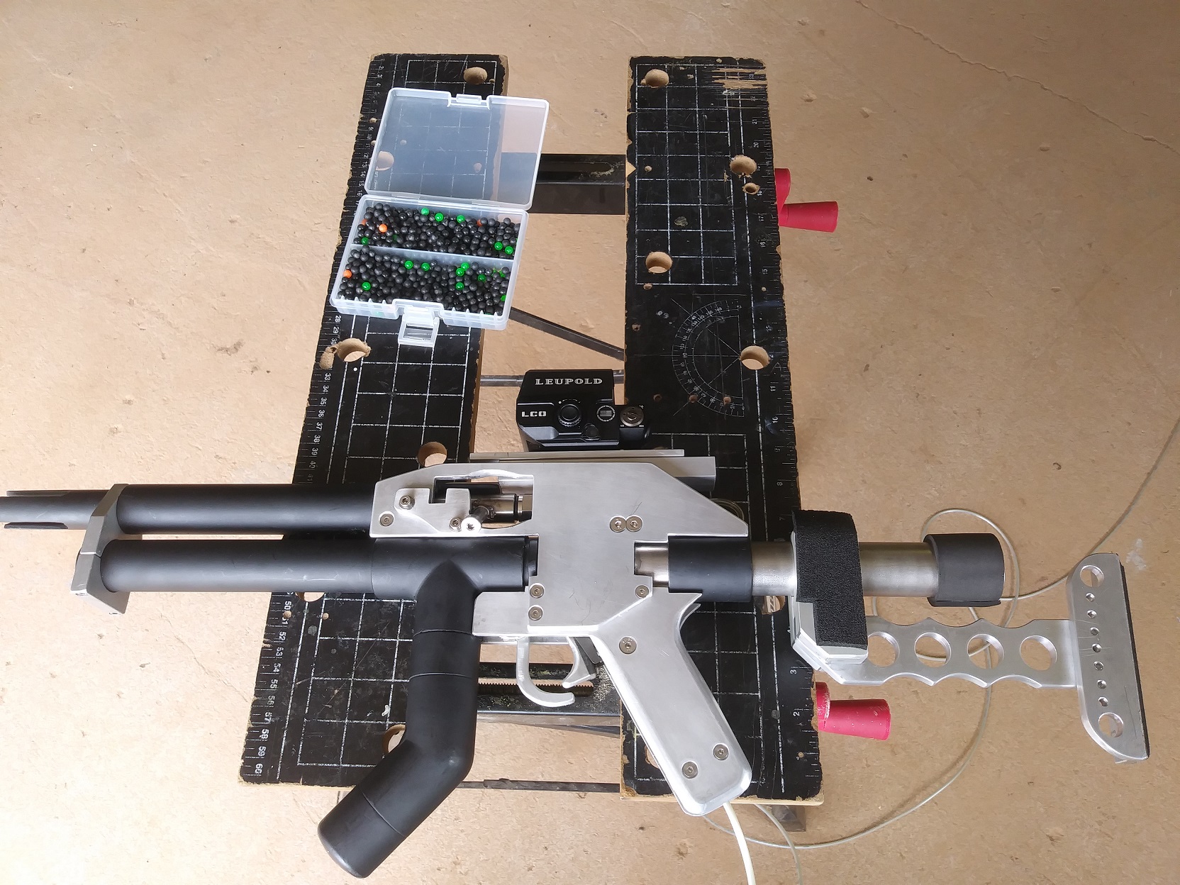

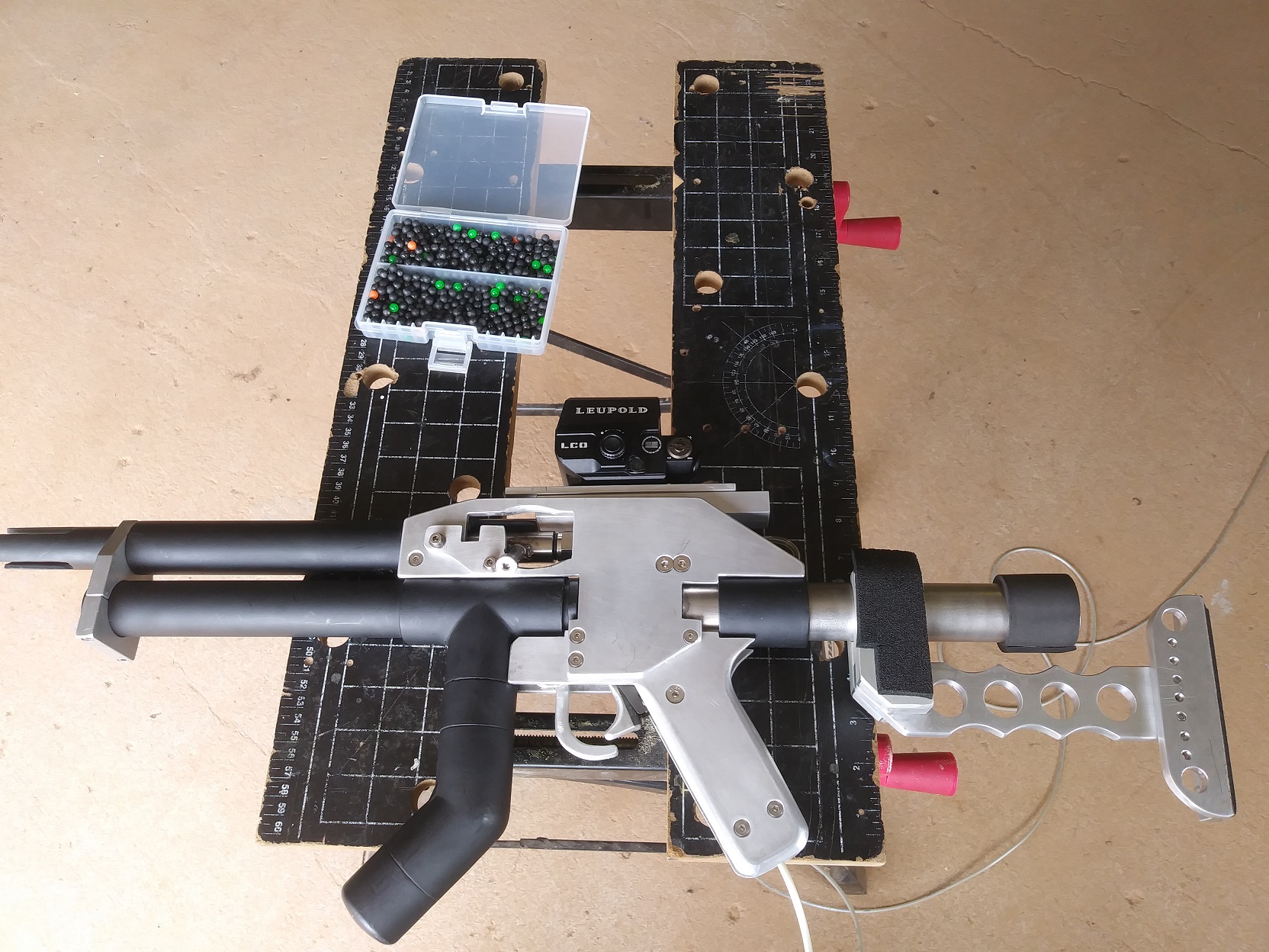

Chrono test @150 psi with 0.12g = 860fps :D
So not a great deal more than the pistol which only has a 1/8" QEV, and this has a 3/8" QEV with same barrel.

farcticox1 wrote:So not a great deal more than the pistol which only has a 1/8" QEV, and this has a 3/8" QEV with same barrel.
More flow is not going to do much in this case, especially with a light projectile that has already left the barrel by the time the valve is full open. More pressure, on the other hand...

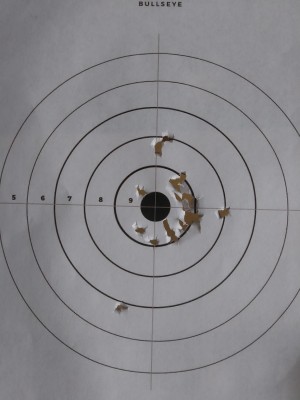

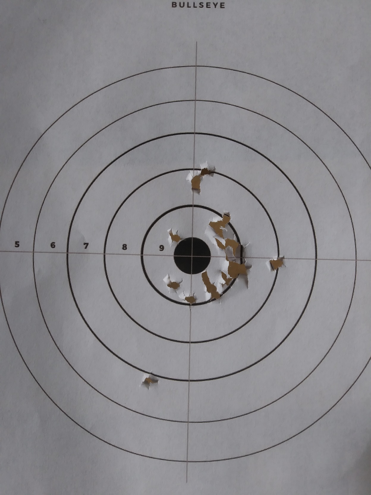

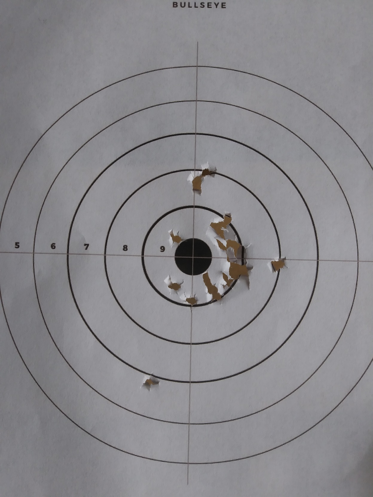

Got to set up the red dot, did a target test at 9m, 20 shots, 0.25g @150psi, no hop up, the odd flyer but not too bad. :shock:
That's better than most commercially available airsoft pistols!
