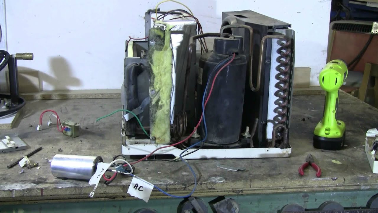

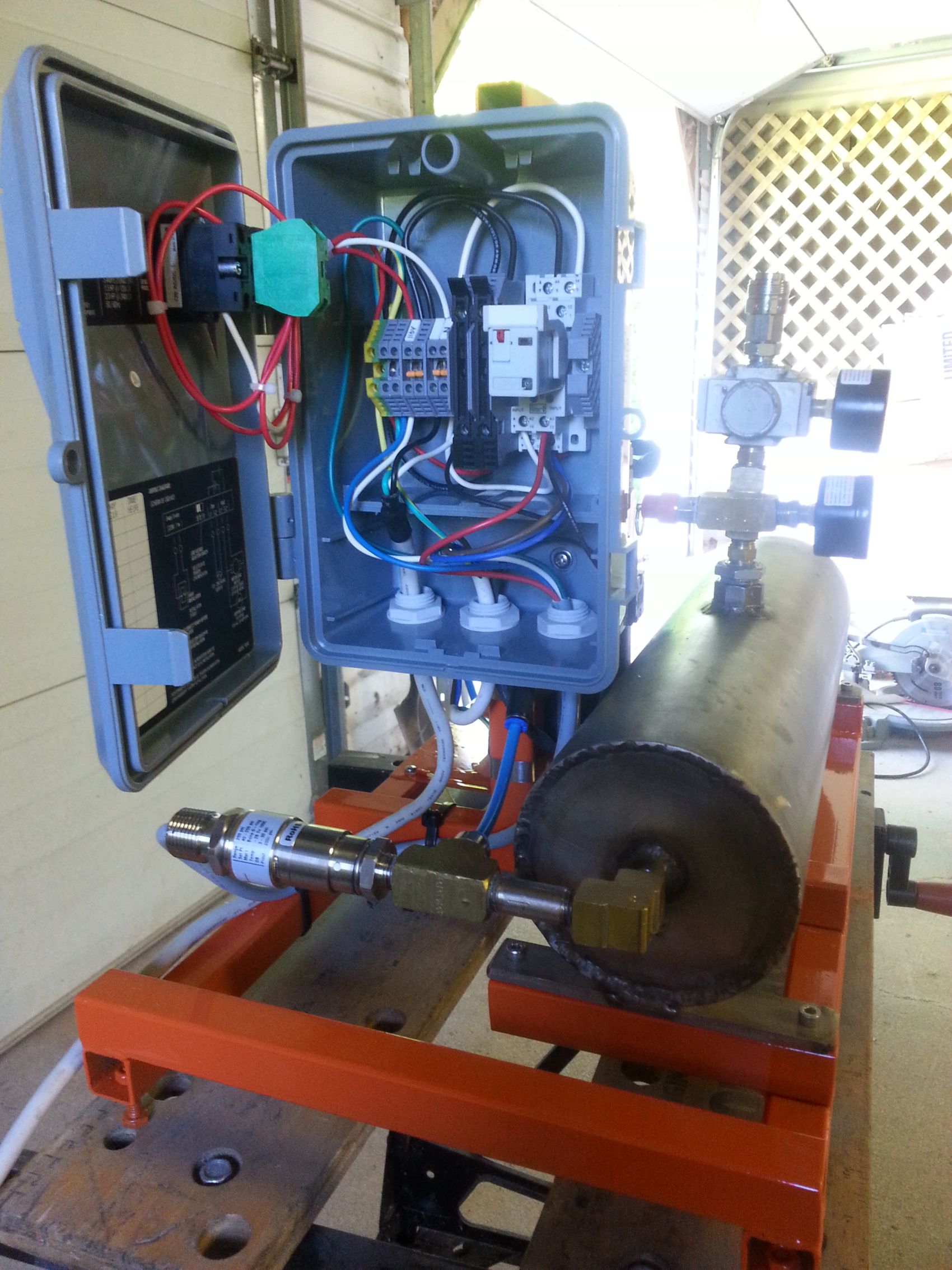

https://www.ebay.ca/itm/Fridge-Refriger ... SwbPNadlqq
And you have make controls/safety relief/cut out etc,
https://www.instructables.com/id/How-to ... silent-ai/
It's all there and done quite cheaply.

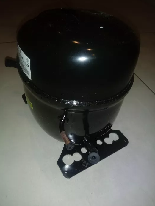

Will this go to 20 bar maybe? Its new

Yes you should have no problem getting to at least 25 bar if you set it up like the instructables video.
Remember to throw in some lubricant every now and then, these are designed to work as closed systems so if you open them up wear will eventually become a problem. Some sort of humidity absorption at the inlet is also a good idea.

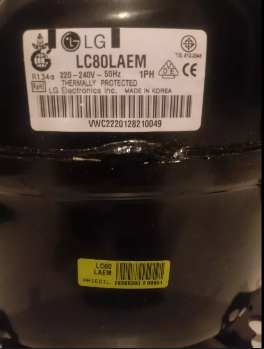

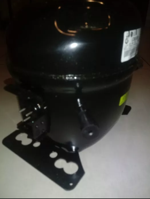

Haniball1337
Poland
Posts: 70
Joined: Thu Mar 07, 2019 12:38 pm
So this LG compressor will be good? I dont see any eletronics on him

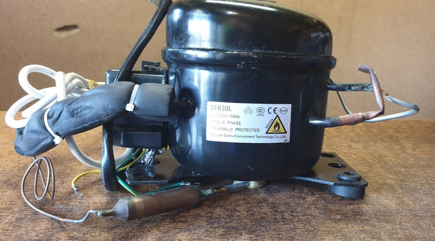

Haniball1337
Poland
Posts: 70

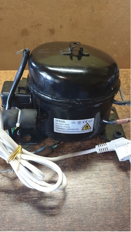

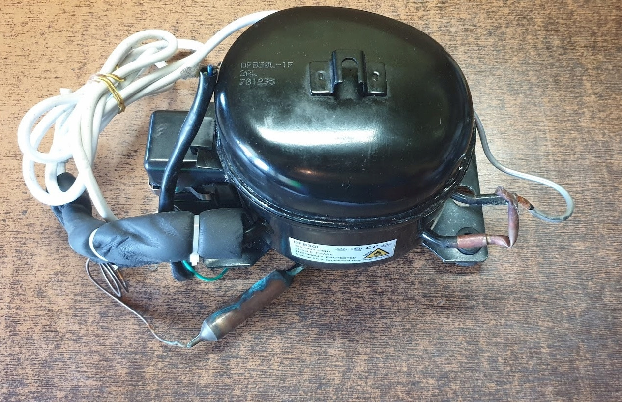

Or better is this first DFB beacuse he have already a plug?
It doesn't really matter since you're going to have to modify the circuit anyway.
look at the instructables link, it should be clear.

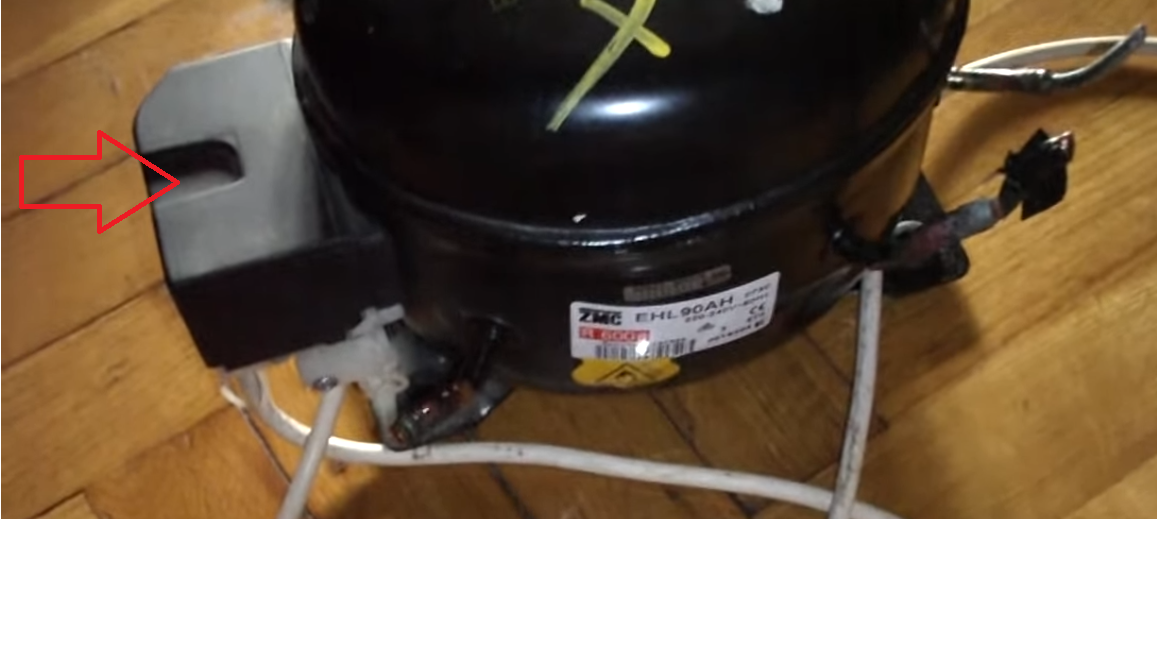

Haniball1337
Poland
Posts: 70

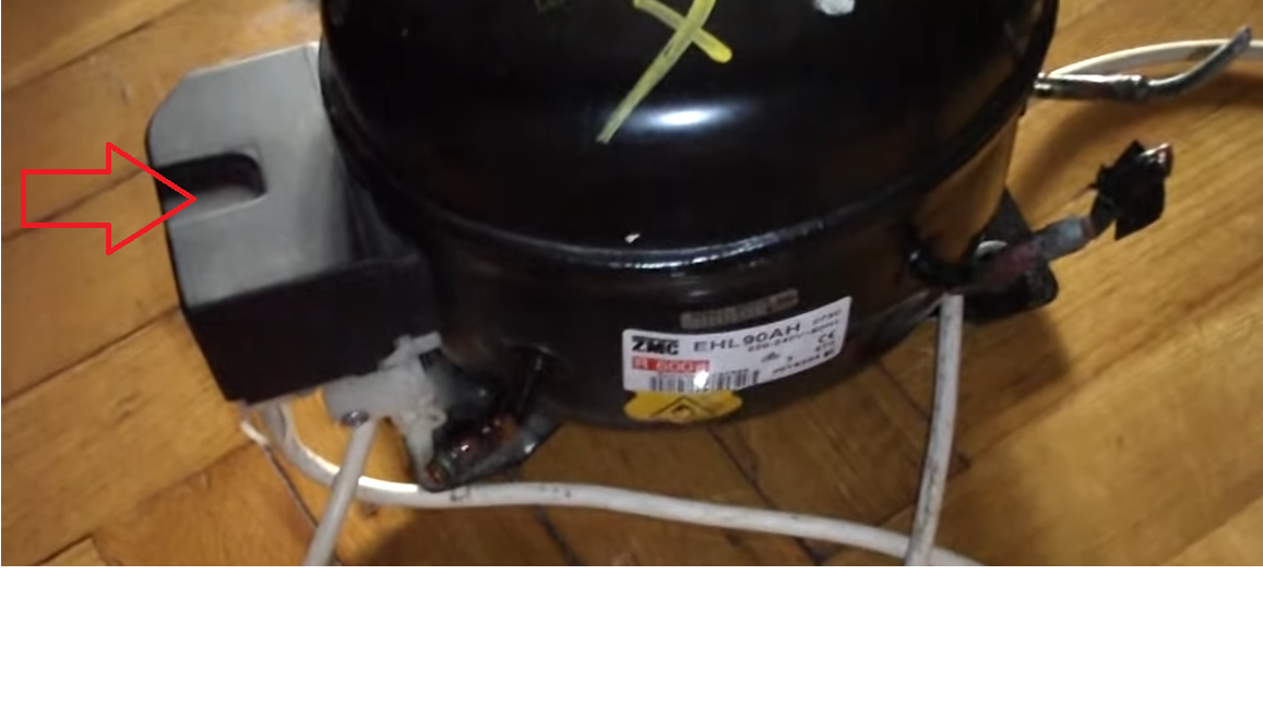

So any electronics will be not problem in this LQ compressor? I dont see on this compressor any box like on others.
The box is usually just covering the connections, as long as it's functional you shouldn't have a problem.
