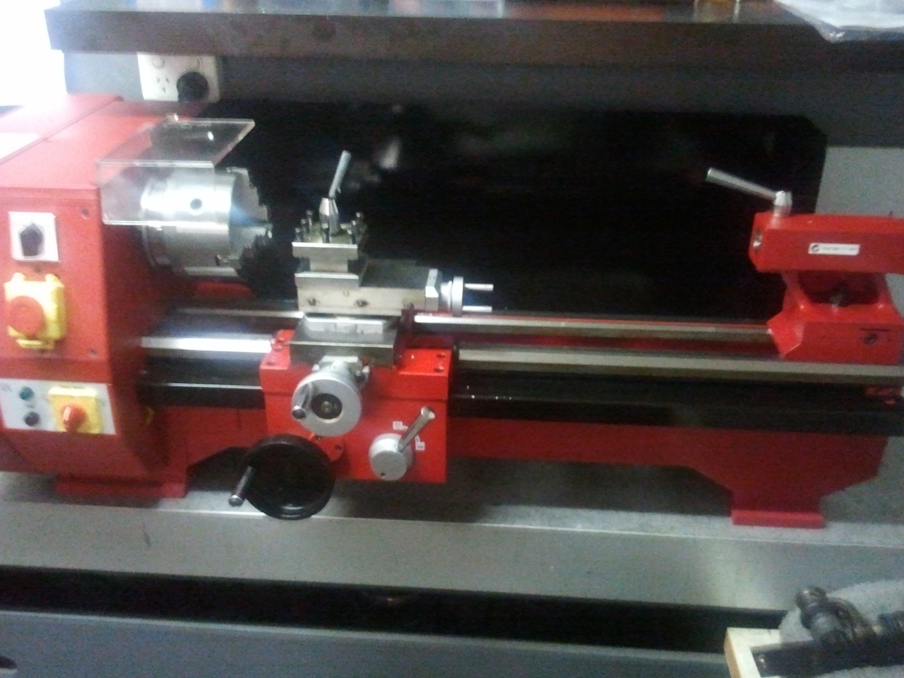

Anyway, nice little lathe. Good size too, you shouldn't have many problems with fitting a fair sized workpiece. Not sure how the rigidity and power is on those lathes but you shouldn't have an issue.

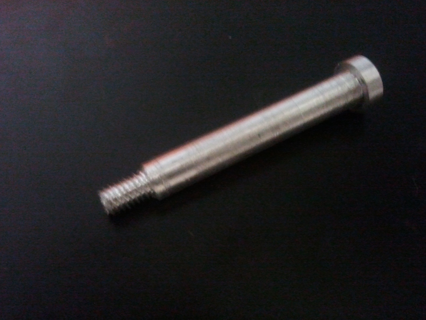

i cut some threads on pvc and aluminium using the change gears and made a simple bolt for a motorbike seat pivot from aluminium. i got the ali from a special aluminium dealer and the steel from a special steel dealer but im not too sure what alloy it is.
