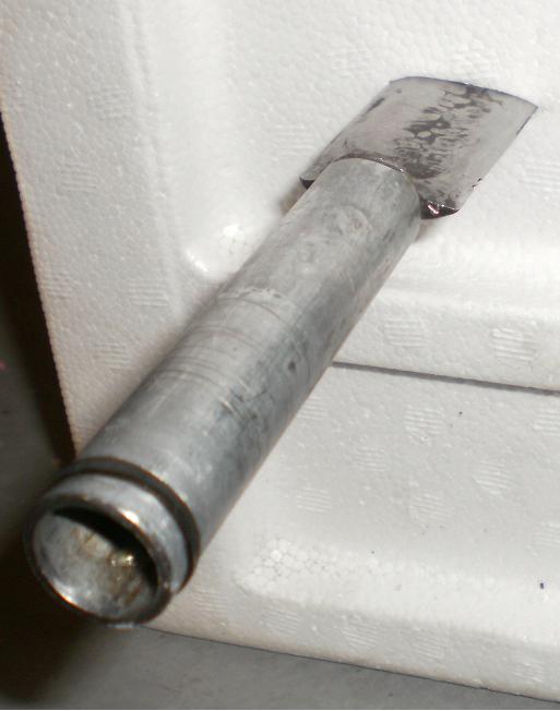

Hey crna just wanted to say thanks for this thread, I never knew these knives even existed and making them pneumatic is even cooler, yours inspired me to give it a go and Im pretty pleased with the results, for now it's only spring powered but I made an addition to the knife that adds an o-ring and I will be soldering a shrader into the handle.
It's all brass, copper, and steel the blade is made from an old chisel, range with the spring is about 25 ft which I think is fairly good, hopefully can be improved with some higher pressure from the pneumatic.
Patience is a virtue, get it if you can, seldom in a women, never in a man.
Nice, that looks like a pretty heft spring but I'll wager power as a pneumatic will be miles ahead, and will not sound as "twangy" :)

Hey very nice work there jor2daje :thumbright:, looks great! When your get around to making it pneumatic keep the spring in to see if it helps, i was going to do that but cant find a stiff spring the fits. :( Thats why i when down the pneumatic route.

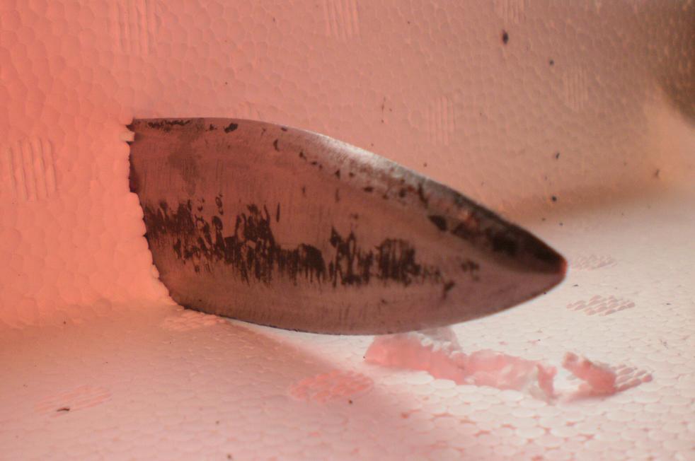

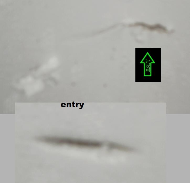

i also have an update, more damage pics/vid. its only at 100psi again, because i cant find something good to shot at.
edit [youtube][/youtube]
went right through, like its polystyrene or something.
the target is 5 and a bit centimeters of polystyrene
