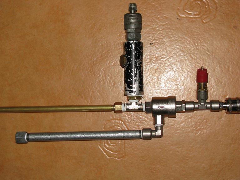

At first I wanted to make a BFWB, but when struggling with the design, jack simply fed stuff through a T... so then I thought "what the heck" and tried it.
I may skip the BFWB for BB's and build one for marbles...
QEV+popoff experiment - update: NOW WITH AMMO!
haha, finally! Shame about the poor feeding though, I'm sure you could stock with a simple tee and improve reliability.

That is impressive
what pressure is the pop off triggering?
I was mucking around with a hopper feed as well but it was too much of a pain to work with, I think a hopper is really only effective with a blow forward bolt. Try it with a tube mag, you will get much better loading.

Just at ~8,1 bar.what pressure is the pop off triggering?
A tube mag doesnt hold enough BB's.

You can have a 30round mag less than a foot long, you can also keep track of the number of rounds you have fired too. I am just in the process of making a quick change design for my mag tubes so they just clip into the top of the Tee, and unclip by pressing down a latch. 8)psycix wrote: A tube mag doesnt hold enough BB's.
SubsonicSpud
Not if you fire them fast enoughPOLAND_SPUD wrote:marbles are much worse... they have a tendency to bounce when hitting a hard target...
This is what I had in mind, 30-50 rounds mags. Unless you're playing with beta-c mags this is a very typical smg/assault rifle loading.You can have a 30round mag less than a foot long, you can also keep track of the number of rounds you have fired too. I am just in the process of making a quick change design for my mag tubes so they just clip into the top of the Tee, and unclip by pressing down a latch.
30 is not enough.
Heck, I can get 700 shots out of the tnak!
If I wanted a tube mag for 700 shots it needs to be 4,20m long...
Oh and I fixed the jam, it feeds just too good now, way too good. It double or triplefeeds every shot... quadruples or even more are not uncommon.
Damn thing.

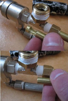

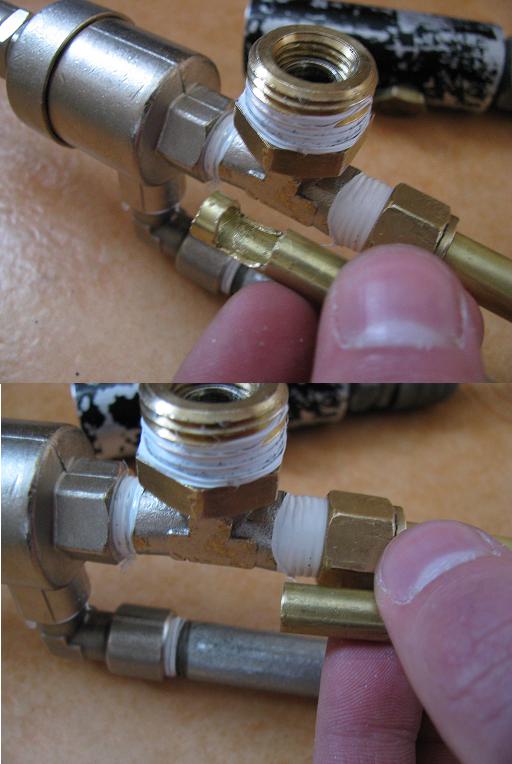

Well I've been fiddling with the feed and here are more details about it. I made a leak in the back of the mag and I changed the inside of the T, made more room for them so no more jamming there. (see attachment)Me, a few days ago wrote:Oh and I fixed the jam, it feeds just too good now, way too good. It double or triplefeeds every shot... quadruples or even more are not uncommon.
Damn thing.
To have a leak in the top, I replaced the cap for a quick connect with a QD in it. This gives a restricted hole where air can leak out a bit. With that air, the bb's are shaken up and feed better.
Well as I said, this made it feed so damn good that it double feeds almost every shot.
When I used the other popoff (which is a little bit more powerful) this was solved. This small amount of pressure extra seemed to be the thing to push the second BB back up the mag instead of feeding it.

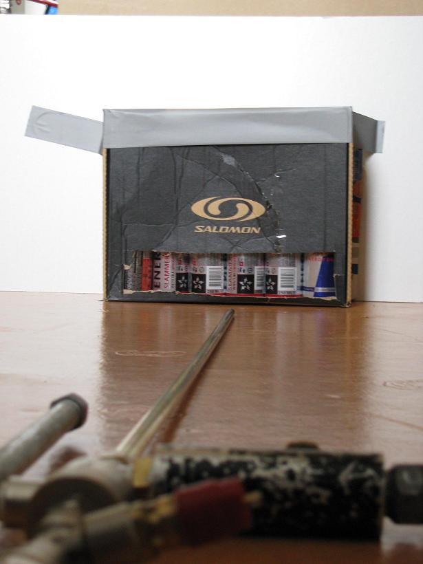

Lots of damage pics from that here!
BTW
I have a vid of killing the pictured cans with a lot of doublefeed. Want me to upload?
Is there even any need to ask?psycix wrote:I have a vid of killing the pictured cans with a lot of doublefeed. Want me to upload?
Its not that great. And I will have to do a lot of cutting since its over 10 minutes of video material with 90% of it being nothing (fixing the jams, cursing)
