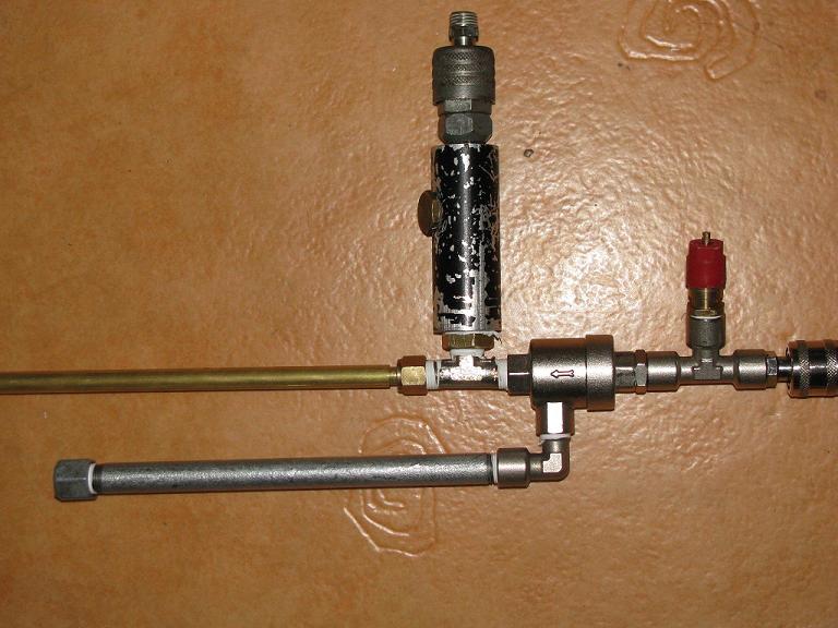

I has it! :D
Click here to watch the video!!!
1/4" QEV with popoffs, 6mm barrel (It will get an blowforward bolt soon)
The little brother of...
Awwww so cuuuute! :)
More to come!

Thanks for the quick replies. Im certainly not the first with this though, but yeah, its really cool.
For example.
I just ordered some steel 6mm bb's and I will soon build a blowforward.
Also I will build my own popoff, but then with a mechanism to shut off the air feed during pilotting, also it will run on a higher pressure (30 bar full-auto anyone?) Heck, I may even step over to unregged (only flow regulated) 12grams.
Tomorrow I will make another vid with the fire extinquisher, but then filled up to a higher pressure and going wild until its empty.

One little question, hwo exactly is the QEV piloted? I see how the pop of valves work but i dotn understand how the QEV is piloted and how it improves anything i.e. wouldnt this work better with a coax and the pop of at the end of the barrel?

I hope you realize that implementing a blowforward bolt is going to be a pain in the ass.. you might try my vertibolt design (if you don't mind buying an air cylinder and if it will work here) or just find a way to minimize flow restrictions cased by the bolt
