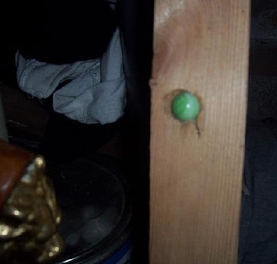

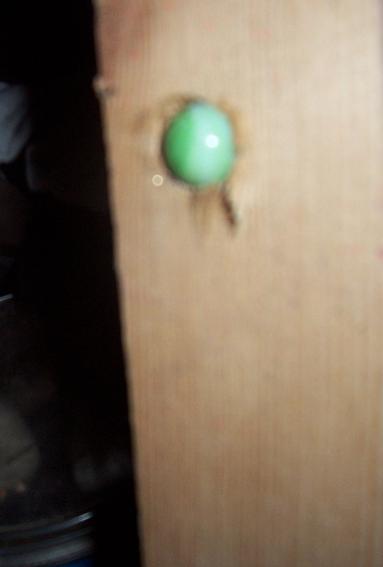

No vid, but a view of the latest improvement...and...a very nice embedded marble...

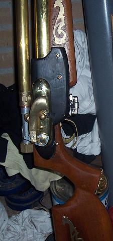

Cleaned up the Tee.<br /><br />How you like it now?!?!
Cleaned up the Tee.
That's pretty hard wood, not crappy at all..
Over 3/4 is in there!

Did you build a similar hammered QEV gun? :roll:
I wouldn't do it with my other one either:

Awesome gun and pics BTB!!
If you wanted to, brass can be silver plated etc. :) 8)
Notice how you forgot to mention the vids :D
Silver plated spudgun built from scrap-disquised as a flintlock
musket...?? :shock:
Neeeeeeeeh... :?
That looks really good from the muzzle end
Good looking gun held by not so good looking man with a temper... :D
Usually I'm not that cranky.. :lol:
I know I'll be laughing when I get a good vid of it..
