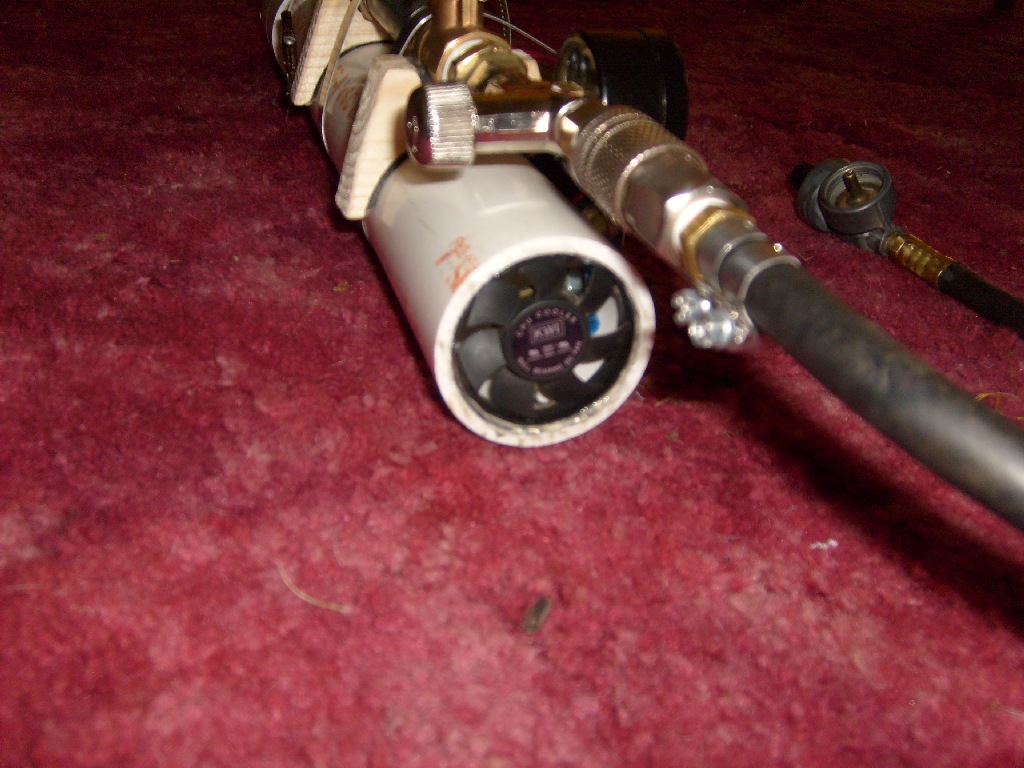

I finished my 2nd combustion a few hours ago and for the last 45 minutes I've been trying to figure out why it only fires when it wants to. The first combustion I built last weekend is almost an exact replica to this one, except this one has interchangable barrels, and a fan control box that isn't so ghettoish as the first cannons box. I figured this one would go together just as easy and fire one the first shot just as the last did. Well it didn't..

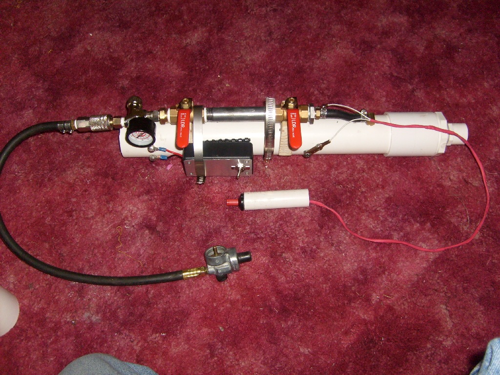

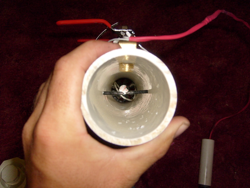

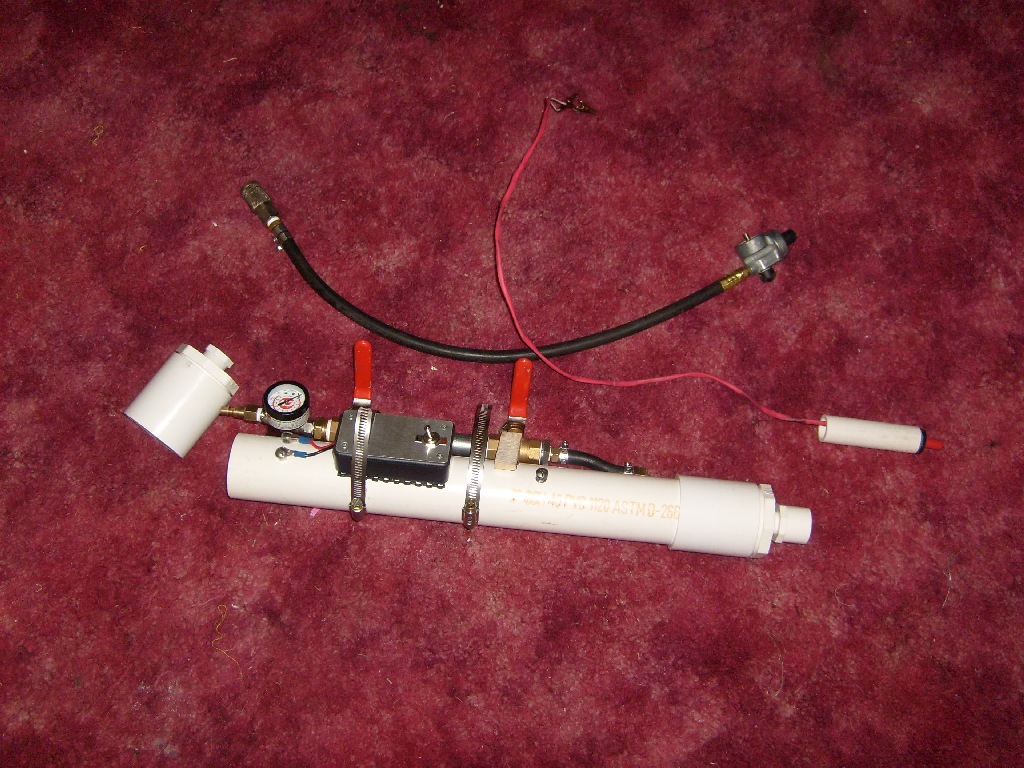

The gun has a threaded end cap in a reducer bushing, and a threaded bushing for barrel switching. The ignitor and propane hookups have been setup so I can use 1 bottle of propane and 1 ignitor on multiple guns.

Here are some pics of the gun below before gluing.

I've been playing around with it since my first post and it seems to fire on 2 meter pipes of propane into the chamber pretty consistently now only its pathetically weak. I do have major leakage around the sparker electrodes and the propane fitting going into the chamber, and most likely around the end cap and barrel threads also. I was using a burst disk from the plastic around a pack of cigarettes and it popped it a few times but it also ignited and slowly let the combustion pressure escape through the leaking areas a few times also.
