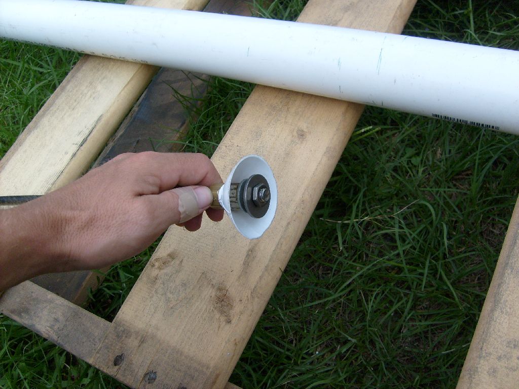

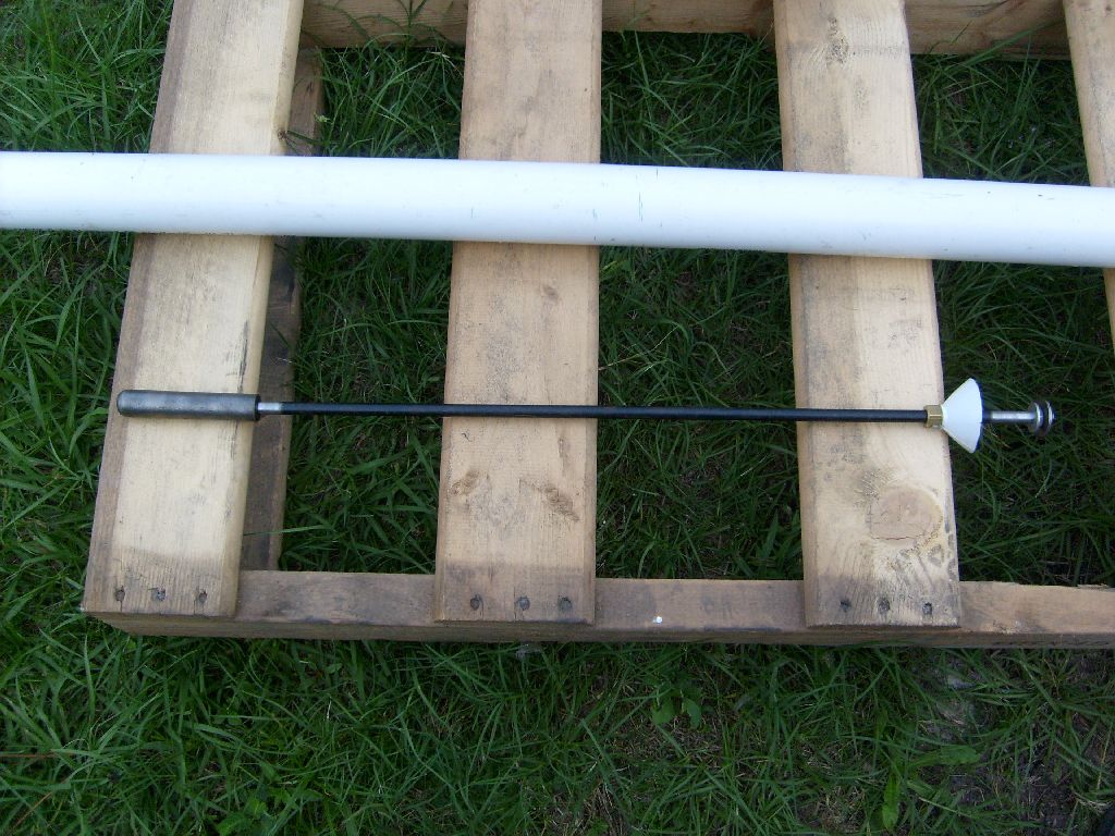

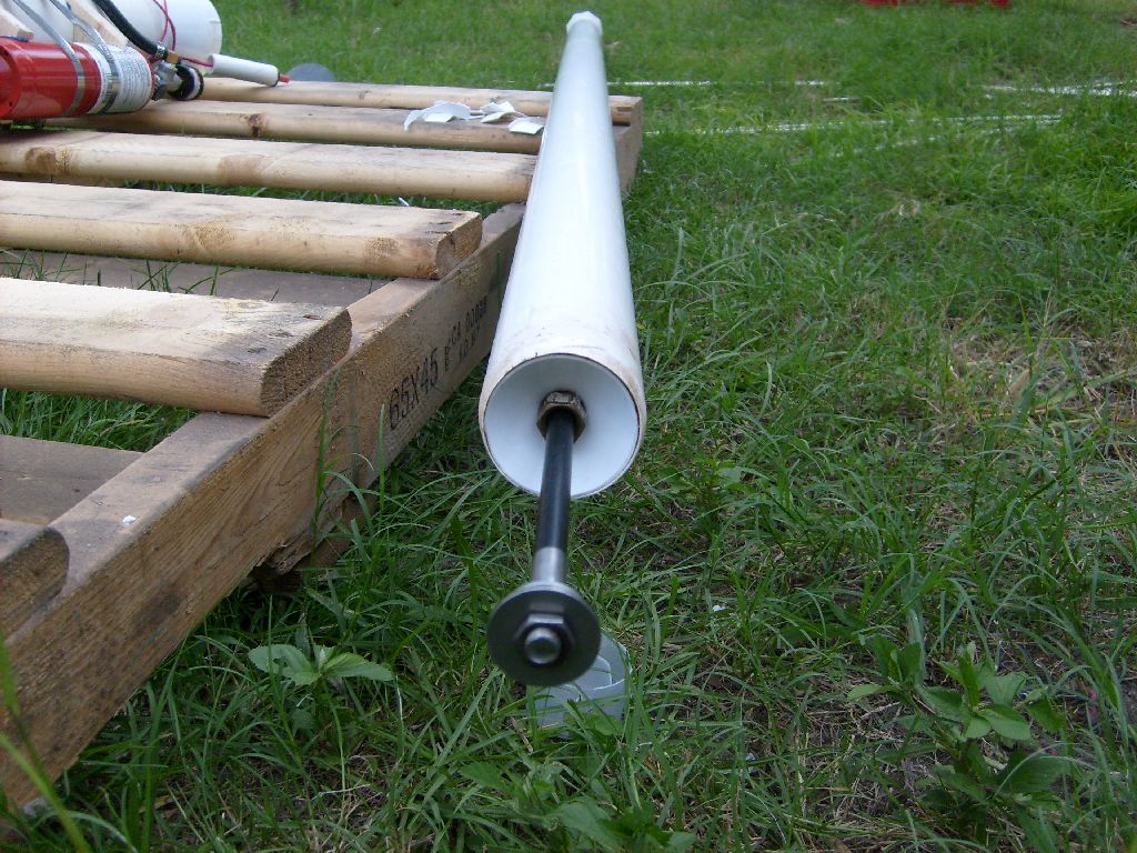

I just finished working on some ammo that I will use to test my launchers maximum range. This is how I did it.
The stubby cylinder and shaft is what's left of an old fireplace poker. Both ends of the shaft are threaded.

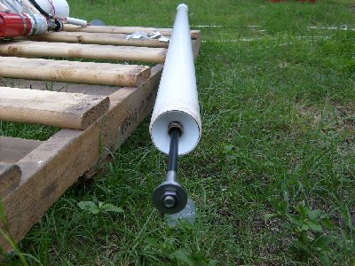

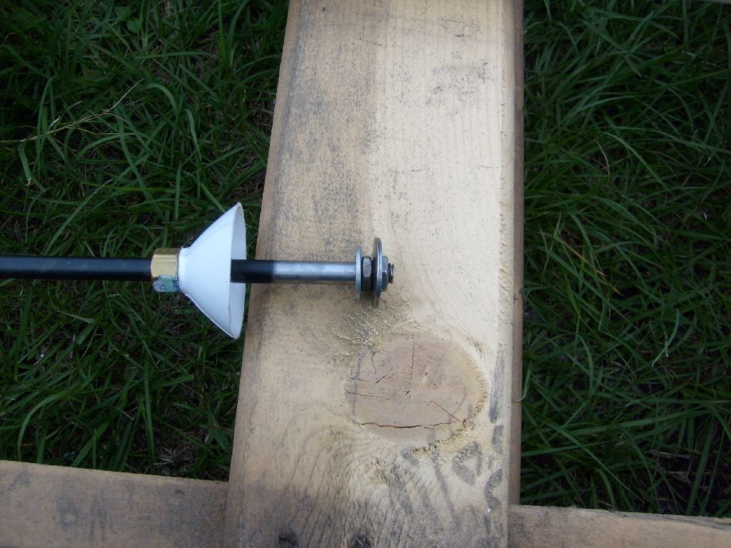

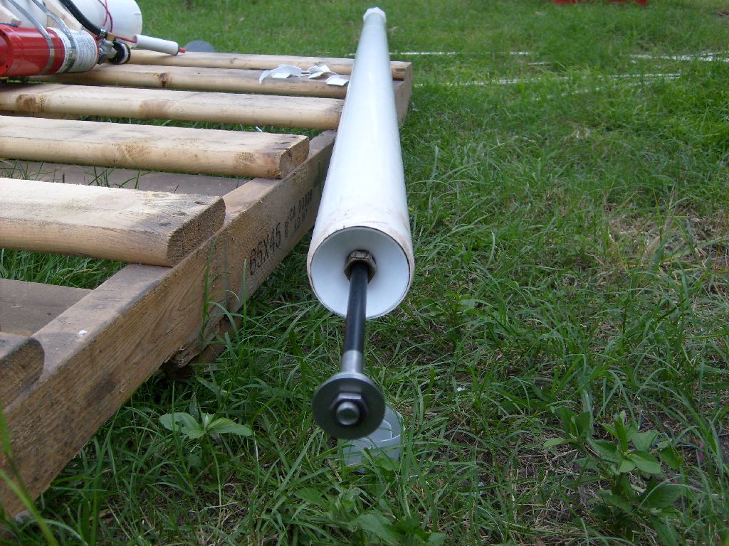

I took a normal kitchen funnel and turned it on a grinding wheel until the outer edge was fairly close to the diameter of the 2" pipe. I then stuck the funnel in the pipe, centered the funnel and started grinding again. I ground the funnel down until it would slip into the barrel.
The funnel is held in place with a few brass fittings and a couple washers. It's a little on the heavy side at 610grams so I may have to shorten the nose section to trim some weight.
I haven't had a chance to fire it yet. Whenever I get to fire it, I will record the shot and the range on a measuring wheel and post the results.
2" Range Arrow...
its a good arrow you got there, but why not adapt a real arrow? they are lighter and will probably go further? The funnel could be used to mold a wax sabot. Just a thought. Other than that, I really wouldn't wana get hit with it
A real arrow would probably work much better but this is made from stuff lying around the shed.
I think you can get cheap arrows at WalMart so I might try that. What I'm going for is something that will travel long distances with little drag and still be visible after it drives itself into the ground. A real arrow would have to be weighted to get maximum range I would think.. Maybe a lead ball cast around a broad head would do it?

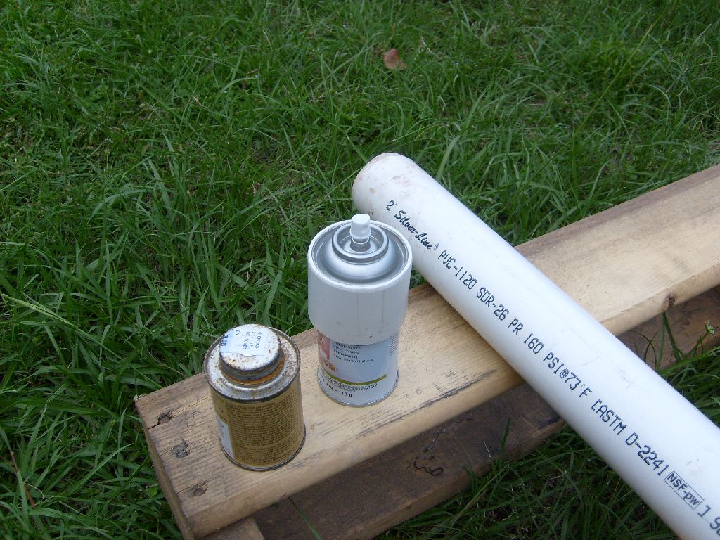

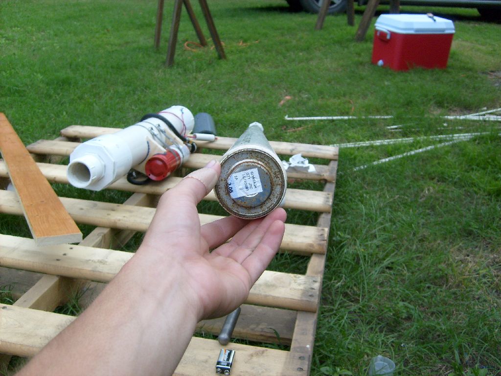

I have found a couple other things that work great in 2" SDR-26 PVC. Both of the cans below met they're maker when I introduced them to an old truck's windshield.

If you made fins for the arrow and used a sabot, rather than using a funnel for both, you would greatly decrease the drag on it, and thus greatly increase the distance it travels. That is why arrows have fletching, rather than a funnel bolted on the back.

you can't say something like that and *not* post photos! nyargh!Both of the cans below met they're maker when I introduced them to an old truck's windshield.
