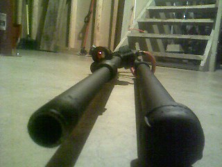

check me out, my new rifle, its call a ten-15!!!!

my first pneumatic kinda sucked so i didn't post it, my second on was alright, i might post it, but i feel like this is my first real one, tell me what cha think!!!
- PIC-0126.jpg (20.08 KiB) Viewed 6966 times

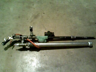

- after the paint job

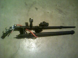

- PIC-0128.jpg (16.95 KiB) Viewed 6966 times
- before the paint job

Dude this is a nice gun, at first I thought it was coaxal but then I saw the sprinkler valve. With the configuration you have set up you could easily convert this into a piston valved cannon.

Nice little metal gun there
I thought it was a piston and the blow gun was piloting it. But then I got to the pic of it unpainted.
Give us some specs on it. Bore, Chamber size, valve size, etc. What kind of pressures are you using and what do you use for ammo?
How hard was it to paint? I have never had good luck painting galvanized metal. Did you have to prime it first?

Looks like the metal construction could take a lot of pressure but the sprinkler valve is the limiting factor. Shame about the long hose increasing your pilot volume.
The pressure gauge is unnecessary in my opinion.

Thats a nice cannon mate, good work with the metal chamber
What psi do you take it to and what ammo do you shoot? Any chance of some damage shots as well?

thanks for the support guys lol, ill post em i little later but the chamber is 1 1/4 inches in diameter and 2 foot long, for the sprinkler valve i just used a 3/4 inch orbit watermaster thingy lol, i used a screw in value and attached it to a 1/8 to 1/2 adapter, and so on until it got to 1 1/4, um i shoot a AA baterry at 90 psi yesterday and it hit a wall roughly 40 or 50 foot away and kinda dented the batterry, but for ammo i sanded down a wooden pole and cut off 1/2 to 1 inch piece...for a few of em i epoxy puddied 3/4 screws to em, havent shoot any yet cuz i just finished the gun yesterday, but tomorrow ill get some damage pic for ya...oh am im so sorry i wrote so damn much lol
Looks great! Shouldn't have any problems with too high of pressure either. Now all you need is a metal piston valve, then you can get into the 400 psi range.
Williamfeldmann, all I do to paint steel pipe is spray on a couple of coats of Krylon Fusion, the same as PVC.
