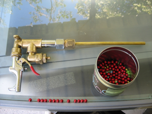

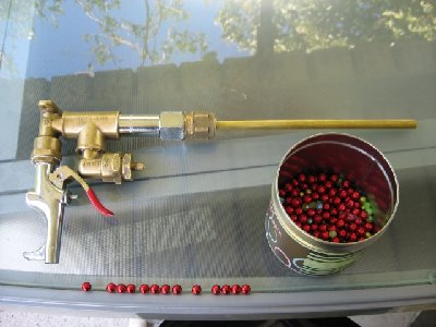

This gun is pretty self explainity guys. It's a real fun little plinker.
The 8mm ammo. They are beads that I got from a discount store. They are Xmas decorations. I got the chain for 99c. Had about 300+ beads on it. All 8mm exactly and fly dead straight.

so i am guessing its a piston valve? And if it is, what is it made of, the sealing face, bumper and stuff. If its not, then what is the sealiang valve?

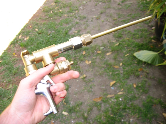

It's coax in the sence that the barrel runs through the chamber but its a T valve aswell because it seals inside the T. The elbow that the blowgun is off, thats where the piston is. I don't have a bumper but I've got a spring that keeps the piston against the barrel. I had to do it that way because I don't fill from behind the piston. My sealing face is just this soft rubber that I got from the plumbing shop. Hope this helps.

BOOYAH! I'm a genious. I give myself an erection my ideas are that good! hahahaha. I've got a compression tee that i bought for the 1st bb gun idea. It's comp on the sides, but the middle is a female thread. As everyone knows, a comp elbow/tee is just a male fitting with a compression coupler that it screws onto.
Well...I've had trouble making a decent looking flush stuck out of metal with the elbow I got on there now. As everyone can see, it's one of those ones with the lip on it so it can bolted to a wall. Well....with this new idea, I screw my blowgun into the female at the bottom of the T, take off the comp coupler thingo off the right hand side and screw that straight into the guns existing tee. With the last side, leave that as a compression fitting. I have a stack of 1/2 copper pipe so I'll make a flush, pollished stock out of it. It's gonna look soo good and work so well!
Any idea's or critisism is more then welcome.
