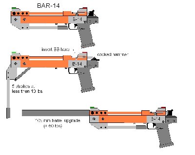

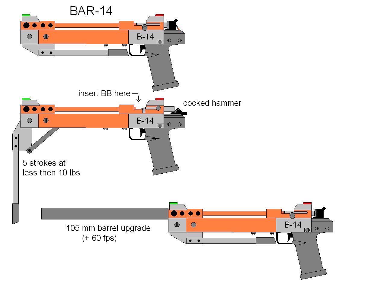

My birthday is in a few months and i want to have done a nice airgun to show off and have fun with my friends ... so i decided to build a 6mm pistol !
I post it to get the viewpoint of the community and what could i improve/change .
The gun take 5 stroke to pump (6 for high power) one stroke is 40 psi gain and it operates on 200 psi (14 bar, hence the name). Here is its power:
480 fps with .28g
540 fps with .28g and barrel upgrade
With 6 pumps i can achieve :
480 fps with .43 and barrel upgrade :twisted:
My friend may want to buy me one also ... but a less powerfull one of course ...

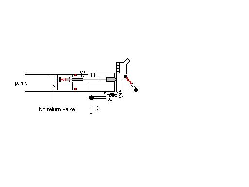

If i was going to suggest a change, I'd go for the hammer. I'd prefer a hammer (cylindrical) with a straight travel path. It can still be cocked by the cycling of the bolt.
And by the way, to the ones who go for "you could buy one for less"- that's hardly the point. When your into machining things into particular it doesn't matter if you could save time and buy it for less- you machine it for experience and sometimes the novelty. I'd prefer to use an item I made than one I bought.
Demon
Posts: 743
Joined: Sun Apr 13, 2008 8:46 am
I found that a rotating hammer was simpler as the hammer head valve wont have to be machined off-center, wich is not easy to do with a self centering chuck. And without that sort of hammer, the look changes, and not for the better (its not as nice as you cant recharge it with your thumb like a revolver)

You are right, even tough i will attempt to make a rotating one as it looks better, it may not be powerfull enough to fully open the valve as the valve is close to the rotating point ...
I think i will make the valve a little higher compared to the middle of the valve for more displacement of the hammer ... :scratch: i will post schematic soon
Demon
Posts: 743
This is the hammer valve, but note that it is not to scale.
The valve is a little higher then the middle

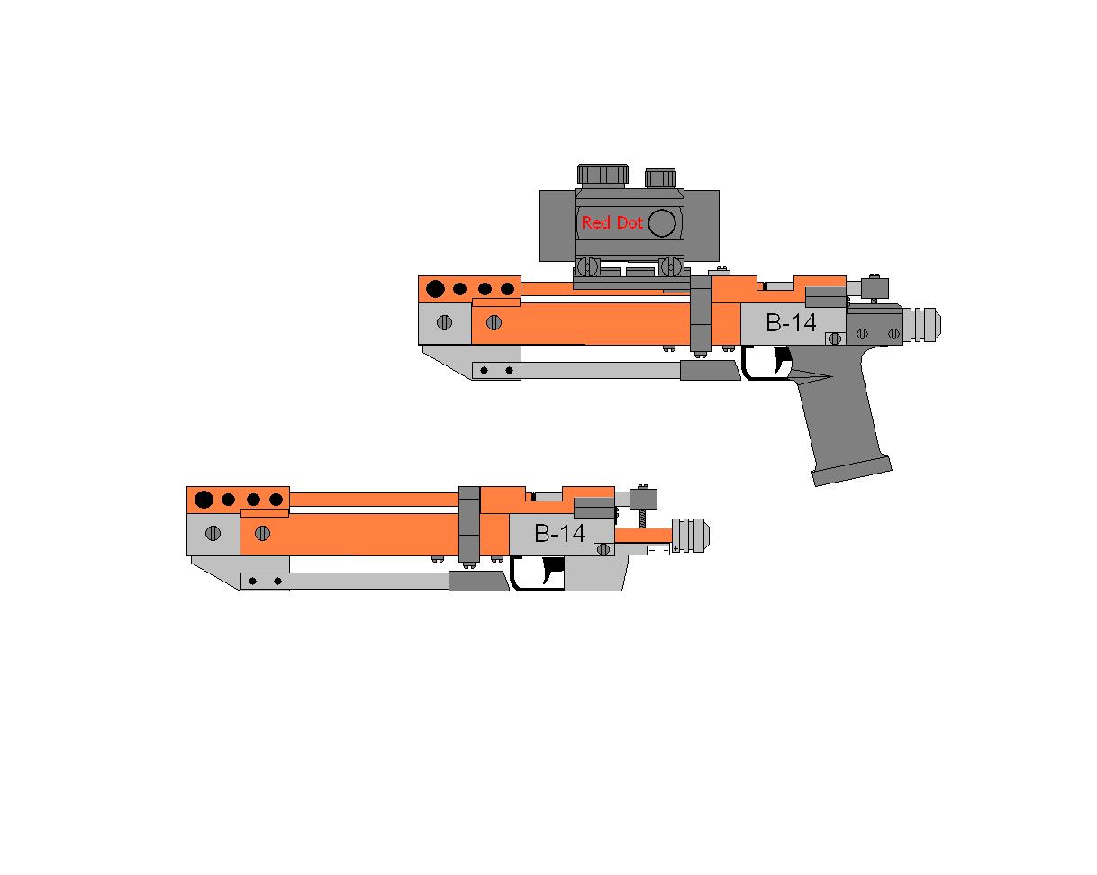

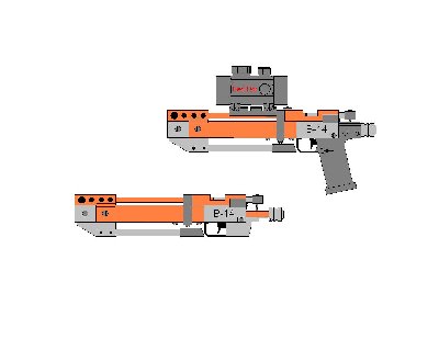

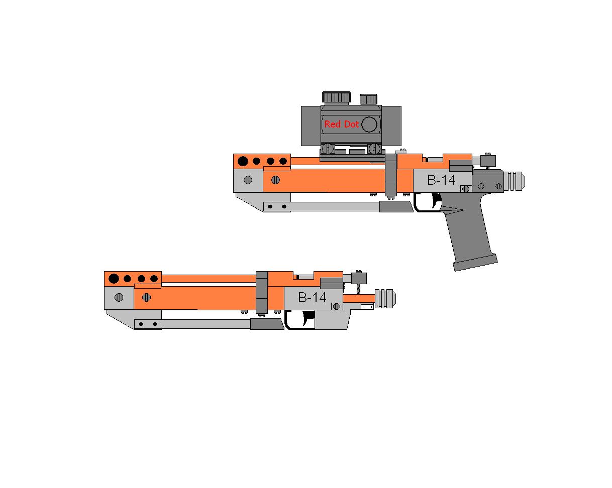

Finally, i will go for inline hammer, but now less talk more work i am going to make cad all this afternoon .
The design w and w/o stuff
