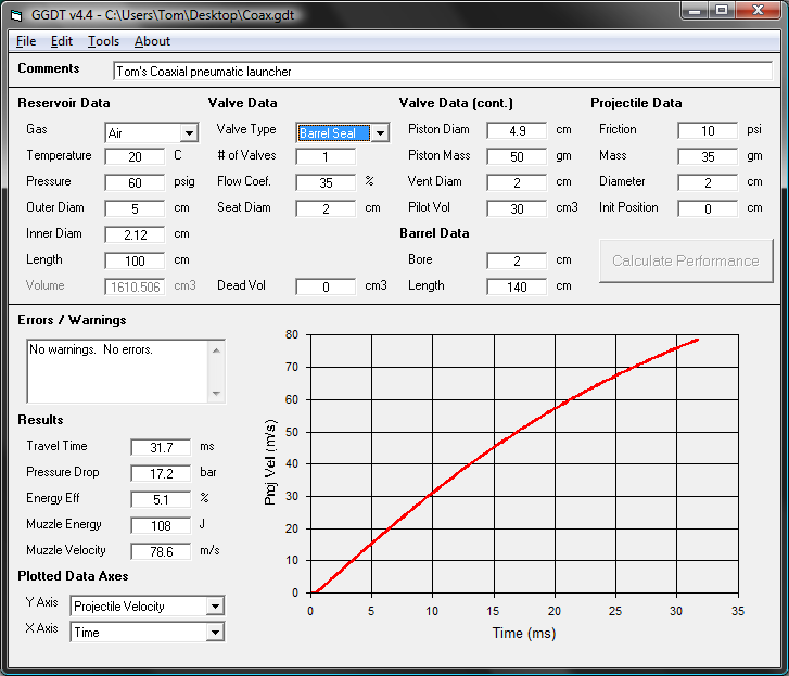

I've modeled this gun in GGDT, and it seems good but I'm not sure.
Please note, the measurements are in metric (meters, grams etc), but I will convert to inches for you guys too. The ggdt file is attached too.
Chamber: 1 meter (3.3 ft or 39 inches) 50mm (2 inch) galvanized steel
Barrel: 1.4 meters (4.6ft or 55 inches) 20mm (3/4 inch) copper
The outer diameter of the barrel is 21.2mm (0.87 in).
It is a barrel sealing piston valve with a 20mm (3/4 in) ball valve pilot vent
At 60 PSI, with a 35g projectile (1.3 oz), the range would be 300m (328 yards, or 984ft).
This seems amazingly high.
Does this gun seem ok spec wise?

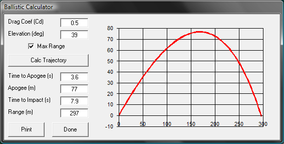

You have a long barrel, efficient valve and high C:B ratio so good performance is to be expected, and if shot at a 45 degree angle in a vacuum 300 metres seems like a feasible range. When you factor in air drag however (and I don't know if the GGDT calculator allows for this) , that figure will drop substantially.
Yes, and given the heavyweight construction material, I hope you have more than 60 psi in mind as a working pressure ;)

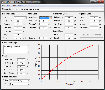

I downloaded the file but it did not save right. Re-input into GGDT then take a screenshot so we can look at it.

I've attached two screenshots.
