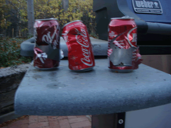

Shot Up Cans. Bad aim resulted in side hits instead of dead center ones.
