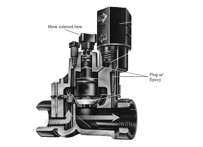

I've used sprinkler valves before but all of them have been modded. I have recently wanted to use electronics in a valve but just couldn't bare myself to rid the launcher of the performance gains. So, after seeing Eddbot's pneumatic, I got to thinking:
What if one was to remove the solenoid and tap into the top of the valve, then put the solenoid into the tapped hole? Like I said, I've never used a solenoid to pilot a sprinkler valve and was wondering what, if any, type of performance will this produce.
See the diagram for more info

The solenoid that comes with the valve would not be adequate to hold back the pressure of the larger vent hole that (reasonably) increased performance requires. You could use a smaller solenoid valve to actuate the valve if you wanted.

the easiest solution that comes to mind would involve 2 valves. Have your main valve be modded, to be actuated by another sprinkler valve that is still controlled by the solenoid. This may involve some extra expense, but it will most definitely work

Sharpshooter, that is precisely what I suggested.

Thanks, BC. I was just wondering if it works and you should know. I knew that hooking another valve to the first would work, but I wanted to avoid the bulk.
I think I've come up with a way to make an electronic trigger, but still keep a low profile. I'll post it when I'm sure about it.
