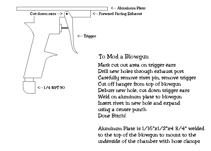

Ok so check this out i decided to take my blowgun trigger and moddify it for easier mounting. it is a 90 degree forward facing exhaust and it has a hanger on top that is gonna get whacked off, an aluminum plate welded to the top and the trigger mounted lower. heres a paint picture and a picture of the original with the trigger already moved down you can still see the original mounting holes.

paint drawing with step by step along side

Did you weld it on there or jb weld it?

i'm going to have the aluminum plate tig welded to the top of the blowgun housing
