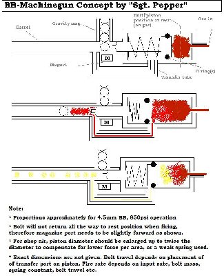

I've follow JSR's trials and tribulations of trying to create a blowback or blowforward bolt design with much interest, as I too desire to build a high velocity / low cyclical rate BBMG.

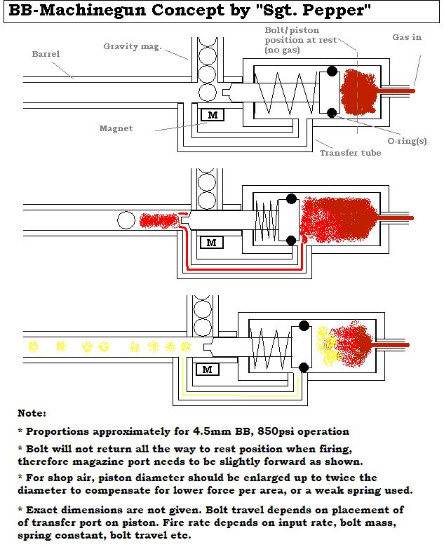

After having zero success attempting to duplicate the Swanstrom receiver design, and much reading, I am currently prototyping according to the attached diagram.
The design is quite similar to what JSR is working on, just kind-of another way of doing the same thing. The design is not mine, I found it on the BBMG forums online.
The reason I chose this design is that I am prototyping in HDPE, and I can play around with the location of the transfer tube to (hopefully) achieve the best results. If I try one location and don't like it, I can insert a 1/8" npt plug and redrill the "receiver" for another location.

Why not just make it like Clides design and just have a blow through bolt? That would take out the bends.

And that way the air could flow much easier. Objective with air flow is make it easy for it to go from point A to B. I dont see a point in the magnet either.

No disagreement here...I've been emailing with JSR, and I wholeheartedly agree that the blowthrough bolt makes more sense--for several reasons, including the fact that (pending bolt size), you can theoretically start the projectile forward with the bolt, and the blast of air (depending on chamber design) will be more effective than the design shown.
However, I believe JSR's earlier abandoned work has promise, and simply needs tuned to slow down the cyclical action.
The only reason for the "clunky" transfer tube at THIS point is for simple prototyping and testing. The final design would incorporate the tranfer tube machined into the aluminum chamber/receiver assembly.
Finally, the honest answer is--I saw this design, and had the materials to play with it--I've got to go buy stuff to play with blow through bolt designs.
Oh...and the magnet? Seems to make sense to me--it's to keep the bb from rolling out of the barrel if it's held less than parallel to the ground!
