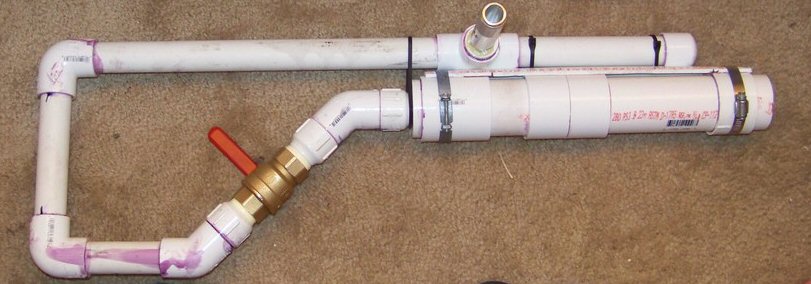

this is the new updated version of my last gun i vids will come soon ive added a diffrent valve and made the expansion chamber into a stock for the weapon its not handheld but strap to my back its a great backup weapon for paintball and airsoft
<a href="http://s234.photobucket.com/albums/ee22 ... 1_0103.jpg" target="_blank"><img src="http://i234.photobucket.com/albums/ee22 ... 1_0103.jpg" border="0" alt="Photobucket"></a>
side view
<a href="http://s234.photobucket.com/albums/ee22 ... 1_0111.jpg" target="_blank"><img src="http://i234.photobucket.com/albums/ee22 ... 1_0111.jpg" border="0" alt="Photobucket"></a>
other side breech open
<a href="http://s234.photobucket.com/albums/ee22 ... 1_0110.jpg" target="_blank"><img src="http://i234.photobucket.com/albums/ee22 ... 1_0110.jpg" border="0" alt="Photobucket"></a>
down the front of the barrel
<a href="http://s234.photobucket.com/albums/ee22 ... 1_0108.jpg" target="_blank"><img src="http://i234.photobucket.com/albums/ee22 ... 1_0108.jpg" border="0" alt="Photobucket"></a>
notice the silver thing to the side thats a co2 quik change adapter it charges it to about 120 psi i will put a guage on it befor i shoot it again

Wow that looks good. You might want to consider replacing that ball valve with a modded sprinkler valve, and of course maybe a little flat matt paint.

i'm not to keen on it. needs a new valve and longer barrel and paint. also i think it would be better if the barrel was on top not bottom

interesting but what is that detachable part?
Because that seems interesting.
Replacing the ball valve with a modded sprinkler valve would also improve performance and make it more egronomical.

well i like the sprinkler valve but i think that ball valves are more reliable the paint is coming along with a red dot sight i want to make sure its shoot like i want it befor i work on the looks i will update with paint, sight, and vid soon
No a modded sprinkler valve would improve performance a lot since your barrel is so short because ball valves open really slow.

[rant] It's a freakin grenade launcher you doober, it is supposed to be used to lob rounds short distances, or did the designation m203 not ring a bell in your head. and the m203 grenade launcher is slung underneath the m16 thereby making it a bottom mounted unit. [/rant] <--thanks JSR I like that.carter wrote:i'm not to keen on it. needs a new valve and longer barrel and paint. also i think it would be better if the barrel was on top not bottom
Other than that I like it with a few exceptions, one being the ball valve. go for the little extra bulkiness but reliability and faster opening time for improved performance. Also I like the redone barrel system, but i think it needs a thrid incarnation maybe find a way to go a little more high tech maybe with a sringloaded catch mechanism to hold the breech closed cause it looks like a friction system. Other than that good job, cool gun.
