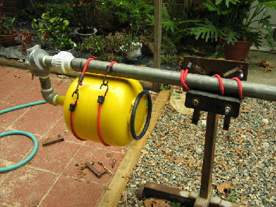

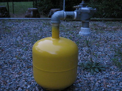

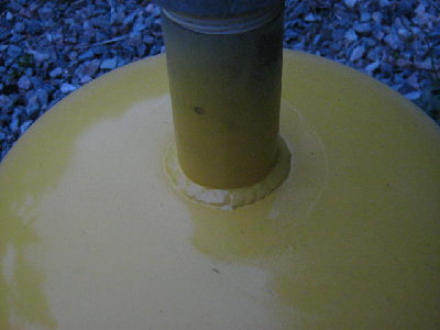

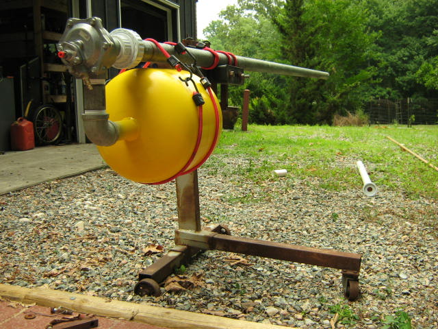

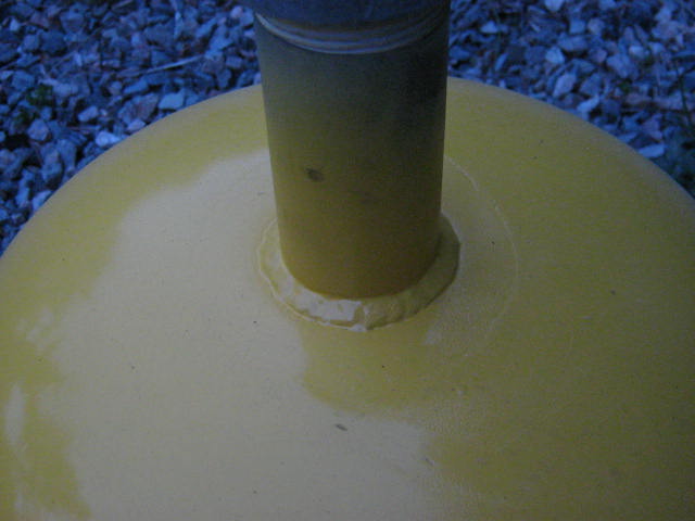

So, this is a cannon I made while I was at school in the welding shop. Its made from a 20LB propane tank and I tig welded the 1 1/2" standpipe on after using a dremel to cut out the old bung. I could have cut it other ways but I was worried about heat messing up the metallurgy. I'm guessing I could take the whole tank and standpipe up to the 250 psi working pressure of the tank but my ASCO pulse valve would fail long before that. Right now I have a 5' x 2" barrel on a 1 1/2" union fitting for storage. Only thing shot so far was a small nerf football and I never saw it leave the barrel. Actually I never saw it again even though I aimed for a tree. Needs a longer barrel since I'm going for the high volume approach rather than high pressure.
Sorry for the low light in the pictures. You get the idea though.

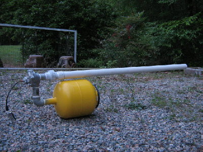

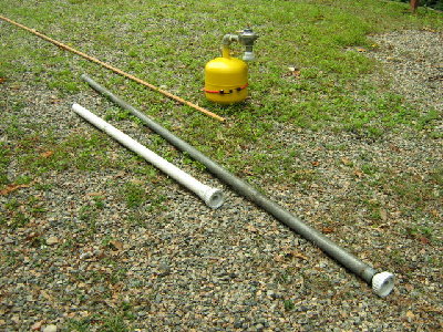

After a couple of months of the cannon sitting and me working and going to school I was finally able to scrounge a piece of 10 foot EMT conduit which now gives me my 3:1- C:B. There is an IPS nipple epoxied inside the conduit and the IPS fitting has some weld buildup studs that were turned down on the lathe as spacers. I shot it a ton yesterday (Independance Day) and it is amazingly quiet behind the muzzle but not so much down range. If a potato is too damaged over its length it has a tendancy to turn into potato salad in the barrel. (Note: my camera makes it sound 3 times as quiet, what you can't here is the echo in the entire neighborhood. Also I'm new to vid editing and am screwing around.)

Updated!! 7/5/08 w/ vids- Fat Banana Cannon
Wow... I actually started laughing when I saw that picture
It just looks so misproportioned. But way to go on the ridiculous chamber volume. It probably stays within 1 psi of the starting pressure throughout the entire barrel
That's why I dubbed it the Fat Banana, it just looks weird, I couldn't stop laughing while I had it hanging for paint. Super long barrel is on the way. I need to get a TB barrel ready and GB barrel as well as a longer full spud barrel (I hate half spuds 1.5")

ANOTHER EDIT: After doing some math the C:B is 6:1 (the tank is 1244 cubic inches or 5 gallons). I'm looking for about 2-3:1. The barrel needs to be a LOT longer....math.... 10 foot barrel for my 3:1 in 2" pvc, and 15 foot for a 2:1 in 2". (Hehe forgot to do math for round stuff instead of square earlier).

Good to see the Asco put into play.
Skip the 90 and make it a stand up gun.
Bolt action !!!

Looks funny but nice job
Hows the noise output?
I really like the way that looks. You should paint the entire gun yellow, and then mount it on a yellow stand.
Just how long of a barrel are you thinking of?

I'm not sure how I missed this one. This is a unique cannon for sure. A little heavy getting around but hey, it looks good getting there..
At least the tank neck acts like a handle when it's all broken down.
I like the yellow tank. Nice job!

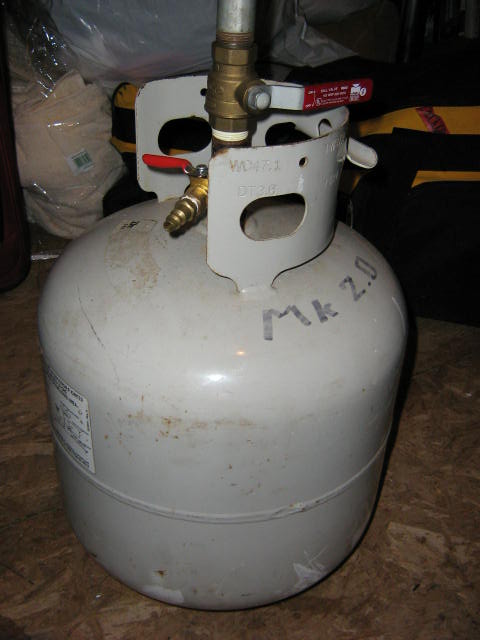

Some of the pics used in the second video here. Since the video I have hip fired it and there is very little recoil even when shooting a full tube of caulk at a tree. The gun is so heavy with the 10 foot barrel that it recoils straight back only about 4 inches.
With all the big bores I have around here I can't shoot these things off as much as I'd like in suburbia and theres no way I can go for an altitude or distance shot either.
If I get the money I'll probably start going for high pressure piston rifles that are a little smaller and don't take so much space.
