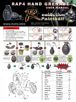

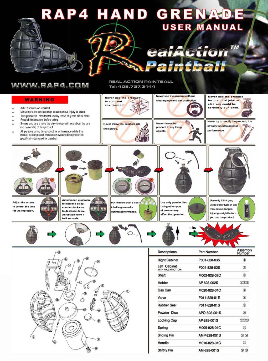

http://rap4.com/grenademanual.htm scroll down to the bottom for a diagram of the internals
Basically like a piston valve that uses a sear trigger instead of a pilot. In this case the sear is some ball bearings.
