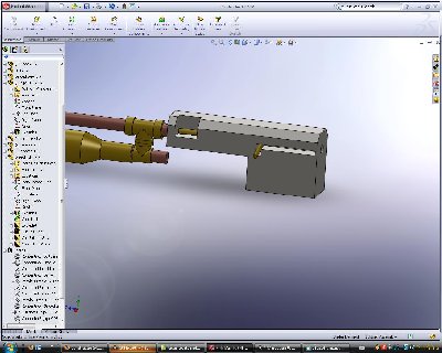

Making some more progress...
Merged:
That stacked valve looks sweet.

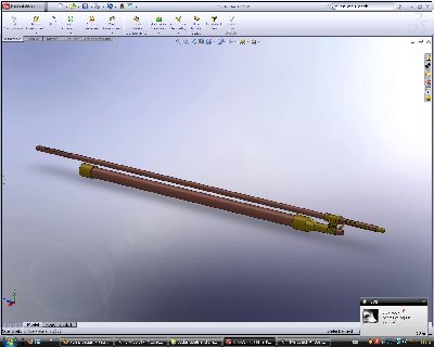

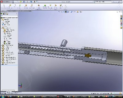

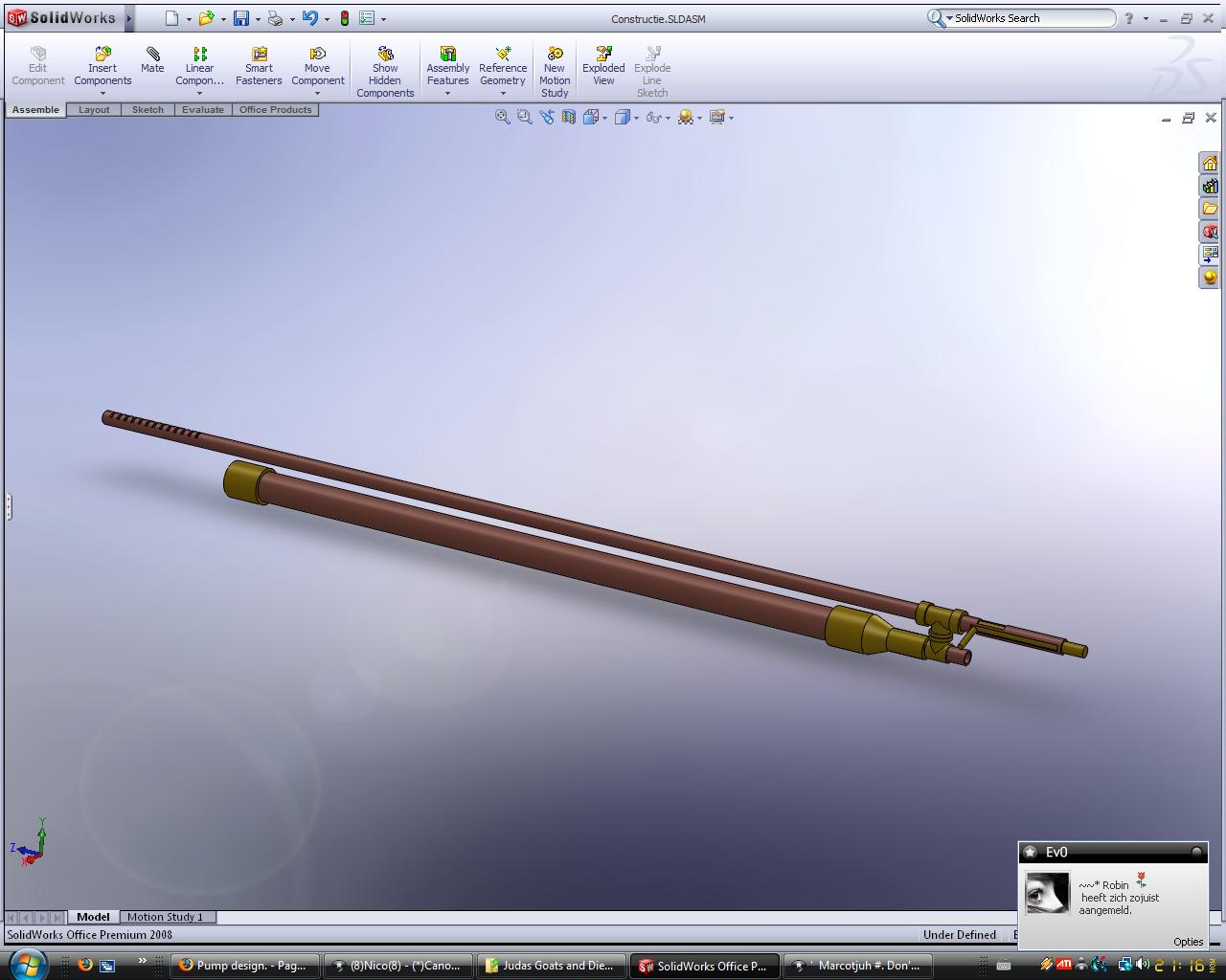

Making more and more progress.. :D
Solidworks is the program.
Antonio
Posts: 508
Mr. Beaver wrote:off topic- what is this program you are using exactly???
LoooL, if you open the picture it says solidworks at the topleft. You cant miss that. Btw Necrosis Nice gun design, looks great.

Making a photorealistic render takes a few dozens of hours of computing alone :wink:

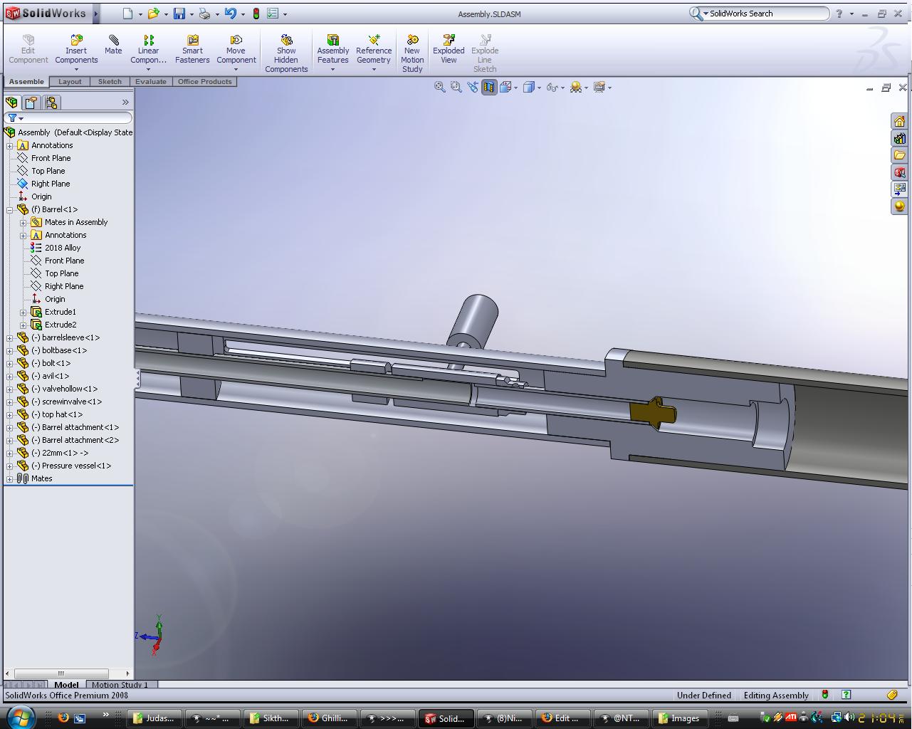

Necrosis
Posts: 239
Joined: Tue Jul 03, 2007 10:03 am
ALIHISGREAT wrote:
jimmy101 wrote:Necrosis: What are you going to use for the valve?
i think he is going to use an ant style homemade valve.
Yeah, I have access to a lathe though, so I will actually make a condor style valve now, inline in stead of under.
ooh a hammer valve good luck with it i'm looking foreward to seeing the finished product already :D
