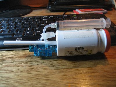

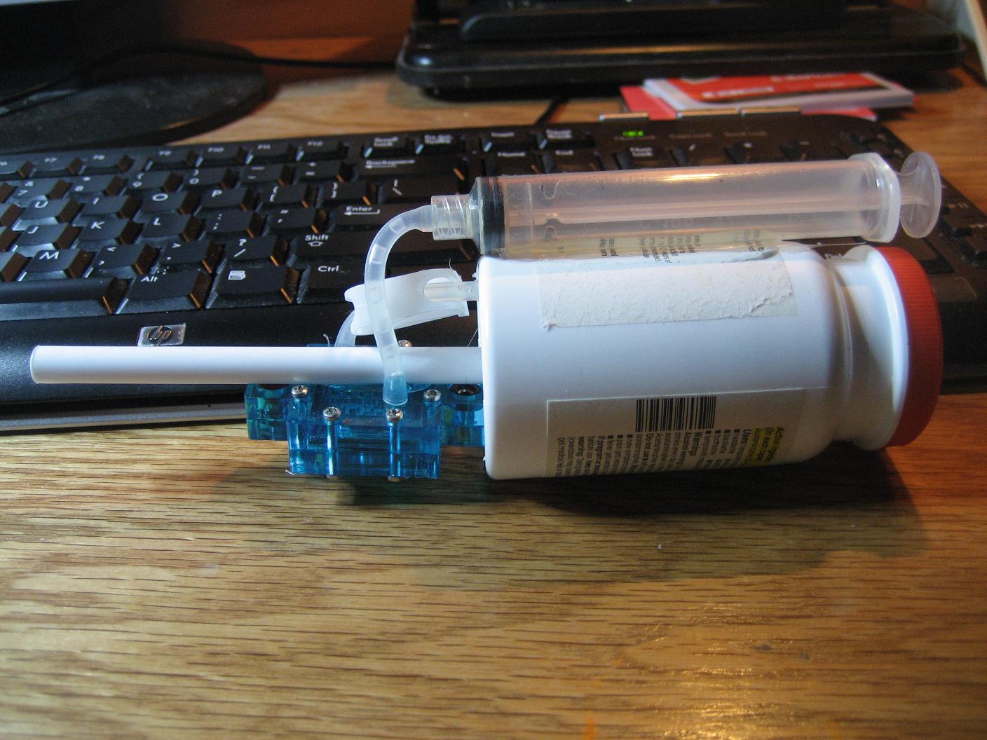

This is a new concept I'm trying out. I'm using metered hydrogen (optional oxygen) as the fuel source. I have a fuel cell producing hydrogen and oxygen. Which stores the hydrogen in a syringe. When the syringe is full it manually injects the hydrogen into the chamber at a ratio of 12 to 1. There isn't a sparker yet so I don't have any damage pics or even sure it works. I plan to add a sparker in the future along with a chamber agitator. The agitator does the same thing as a chamber fan but the agitator will fit in the chamber unlike the fan.
(3/12/08 )Edit: Eureka! :idea: It works! After tinkering with the fuel mixture I got it to what is pretty damn close to the golden ratio. The gun is a monster! It tears through soda cans (a baseline test for me) and shatters the bbs upon impact. I figured out that adding oxygen to the mix made it too rich and wouldn't combust. Using atmospheric air the oxygen percentage is less making it closer to ideal combustion mixtures. The only thing I need to improve now is make the chamber smaller. This will make it so that I can use pure oxygen in the chamber instead of having half the chamber filled with atmospheric air. There is bad news, however, which is I currently don't have a working digital camera so vidoes and pictures are currently out of the question. :cry:
The blue thing is the fuel cell. The chamber is a tylenol bottle and the barrel is a pen tube. The syringe is 10ml in volume.

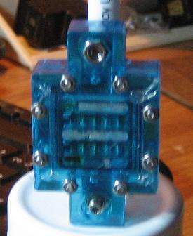

This is the fuel cell. It's an expensive thing (about $100) but I have connections and got this free.

The cap is what I'm most worried about. But I'm pretty confident with it. Iv'e seen it done before with even larger pill bottles. (Centrum value size) Theer is little to no pressure in the chamber itself. The syringe itself expands to hold the volume of hydrogen. The other output on the hydrogen side goes to the chamber but when filling it a hose clamp is closing the path to the chamber, forcing it to the syringe. When full the clamp is opened and you inject the hydrogen from the syringe, through the fuel cell, and into the chamber. All pressures are ambient.

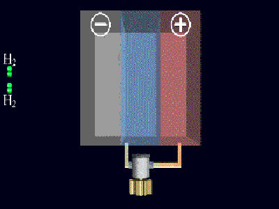

As for how  the fuel cell works. This is the cell using the hydrogen. Put electricity into the fuel cell and it produces hydrogen. Click to work the animation.

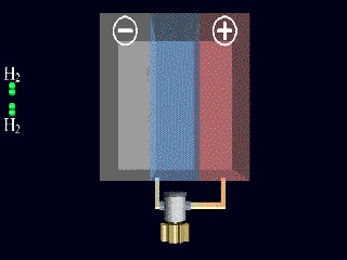

Well I'm trying this cannon without oxygen injection. This will make it a little less powerful. The bottle is slightly flexible and thick. It's actually surprisingly thick. The perfection combo, I think, kinda like a spring is to metal. The fuel cell is a slow charge fuel cell. It takes about 15s/mL. It wouldn't be practical for anything larger than this. I have a larger one which charges at a rate of 1mL/s. Even that is impractical for the average spud gun. The fuel cell required would have to be at least 20mL/s. Plus look up the pringles can hydrogen experiment. A pringles can can survive a combustion I'm sure this will hold.
