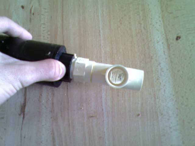

As you requested, i took a few pics of the mecanism i spoke about. I have NOT designed or invented anything and i do not pretend i did. I simply copied the GB semi loading mecanism into something smaller and added a few things (like a second spring to smooth the comming back of the bolt).
Here :

EDIT : Oh, well the images in the album dont seem to work... if you're curious, just go in the album and you'll see i'v uploaded the photos.[/list]

Your launcher sounds interesting but I still can't see the pics... can you at least give us a link to the album?
I cant seem to put the pictures in my post... but they are in the album if you're curious.

can't you just paste them in the thread like this
- mid_Semi_Auto_mecanism_bolt_opened.jpg (18.16 KiB) Viewed 3641 times
