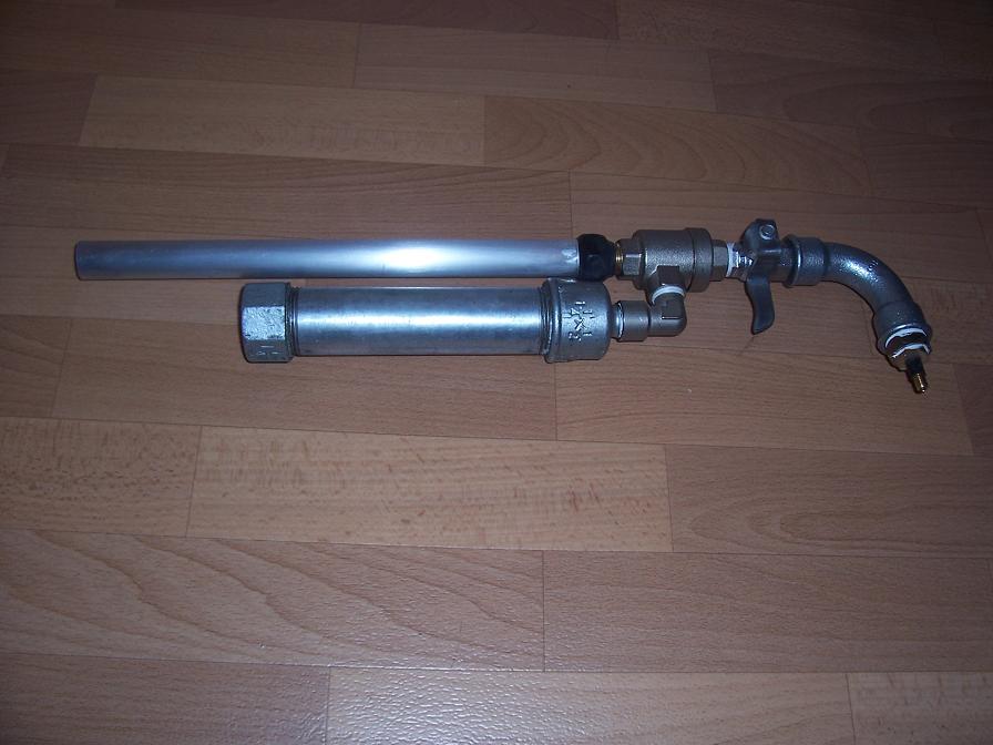

Here it is!!
Pneumatic sawed-off shotgun mark II.
Same concept as the original, just cleaner, better and made to sell in numbers!!
THis one will be used to get a contract to build 10 of these, to be used by members of an airgun club. ( they have permission)
Only the QEV restricts the pressure to...I believe Ragnarok used them at 35 bar right??
Well...not much to say here, just...enjoy!
BTB sawed-off mark II

Wow that is clean, isn't the handle a bit excessive with the pilot volume?
You could've put a the schrader before the ball valve and left the handle.
3/4" QEV with a 1" barrel and 2" chamber?

What do you mean by the handle is excessive?
When the pump is removed the handle part empties up to the ballvalve.
The schrader is empty, no valve, just the outside.
Can't get a smaller pilot volume than this.
I built it like that on purpose.
Try 1/2" QEV, 1-1/4" chamber and 3/4 barrel.
It's going to be sold to guys that are used to .177 airguns...
They pay 200 euro's. Spudfilers would pay less offcourse.

Ah my bad, I completely over-looked that.Brian the brain wrote:What do you mean by the handle is excessive?
Oh well I was close-ish.

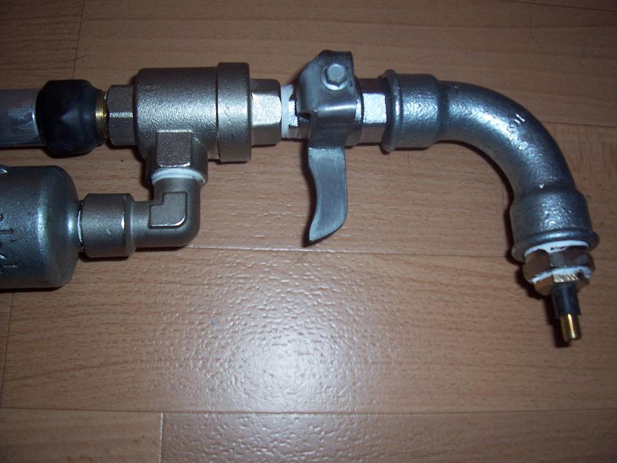

Ahh very nice cannon very clean im glad youre able to make some bussiness off of it. Also how do you make those costom? ball valve handles?
Coodude26 wrote:
- Brian the brain
- Posts: 3497
- Location: Holland
- Been thanked: 7 times
I used a vice and a hammer and filed it into shape.
