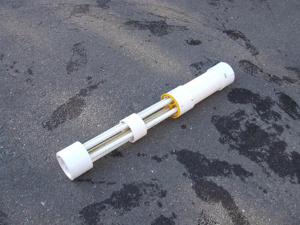

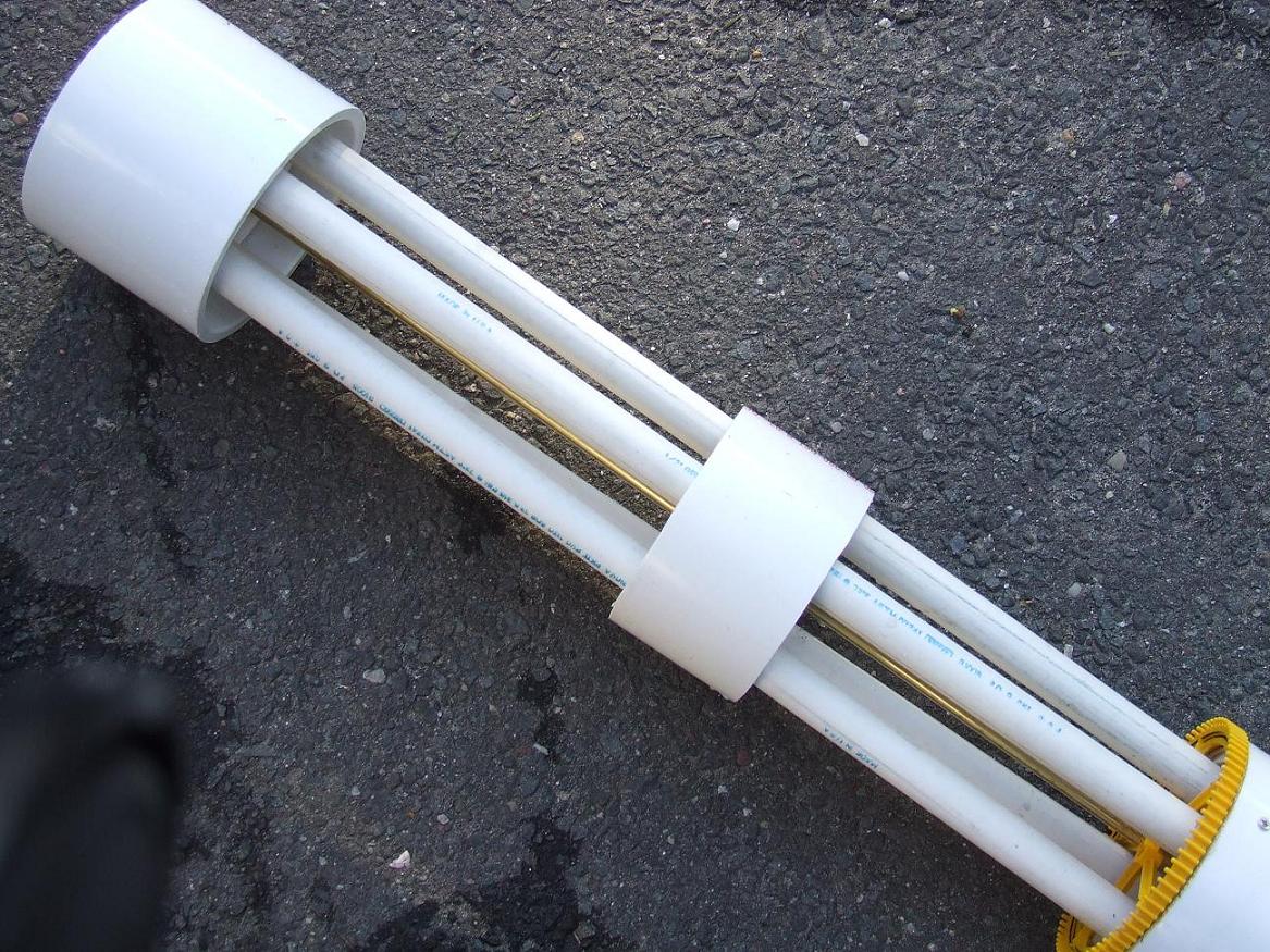

New pics of progress are up. This is the first step toward the minigun.

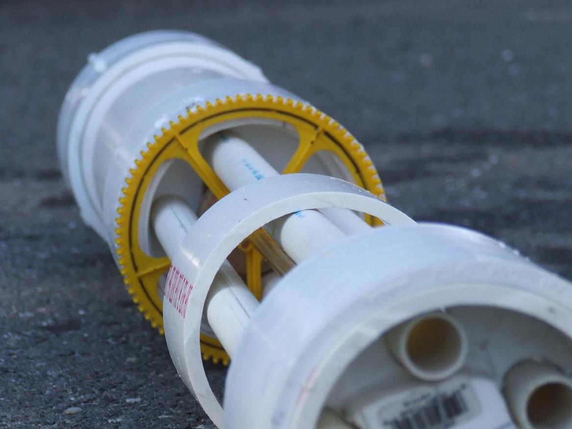

This is the homemade peumatic motor I made for this gun. The first one, as far as I know, to be used in a BBMG. However in the end it may not be used.

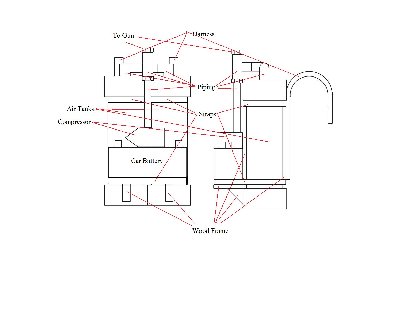

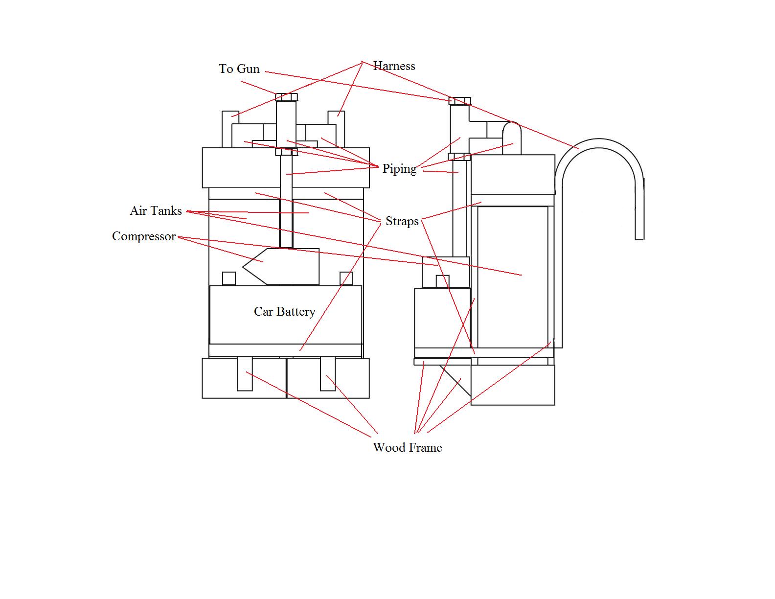

This is the proposed arrangement of the power unit for the gun. Nothing is to scale and yes I know that's a bad illustration of a compressor.

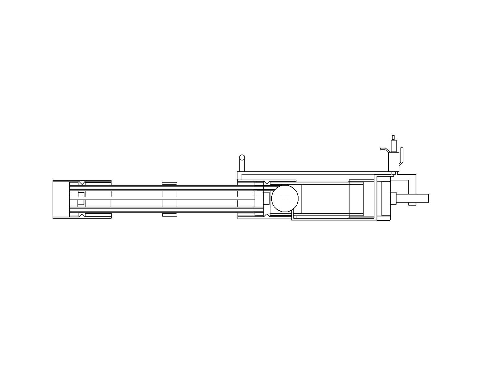

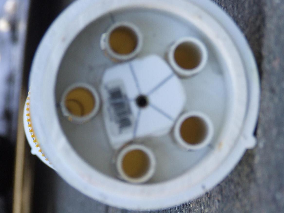

This is the inside of the minigun displayed if you were to cut it in half.

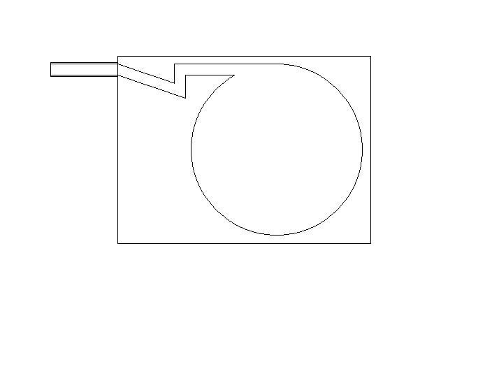

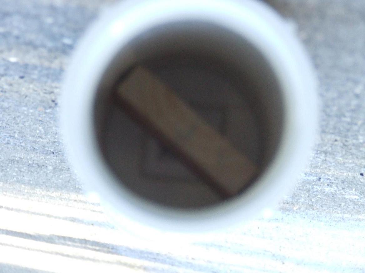

here is the vortex block it prevents jams by only allowing one bb through the rotating barrels at a time.

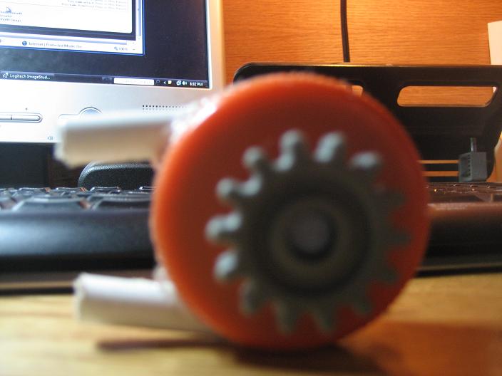

Ehh. this one is kinda blurry.
