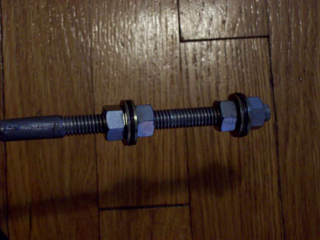

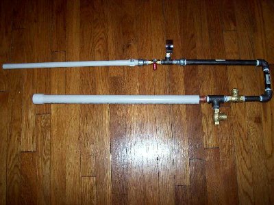

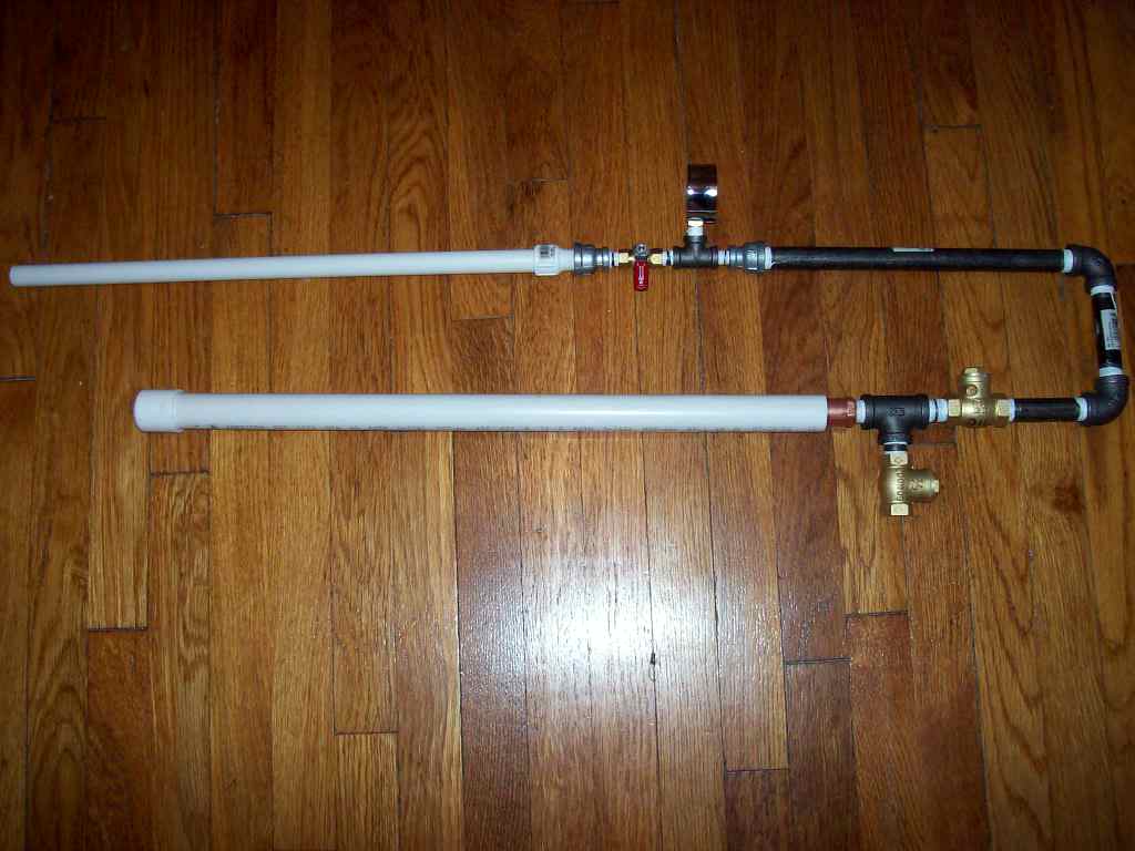

I built this gun yesterday just off the top off my head. Ive already gone through about 3 bike pumps and dont want to mess with compressors of co2, so i built this gun with a built in homemade pump. In the pic below you can see how it works. Its got a copper tube (sleeved in 1" pvc) that seats a piston. There is one check valve to allow air into the chamber and another to allow air back into the tube as the piston retracts. Its got a psi guage and a ball valve for the trigger. It works perfectly, its just that... its kinda weak. Somehow it only pumps up to probably like 5 psi, not even registering on the guage. Im positive that the valves are opening right. It leaks a little bit, but i dont think it would account for it. Please let me know if there is a better piston i could make. My initial concern was that there would be too much dead space in the piston. My guess though is that the piston compresses to about 6 times less the volume and goes from both ends of the copper tube. Im not sure what pressure this equates too because i dont know how to use the ideal gas law. Advice, help anyone?

i think the problem is the dead space. your piston dosent get all the way to the check valve and just compresses the air in the dead space between the piston on the deepest point and the check valve.

Alright, well, the piston i made is crap. It would be great for a valve, but for a pump, its gotta be much beefier and no air can slip past it. I need to find a way to make an extremely airtight 1/2" copper piston, please help!

Are you really sure it's the piston? Those look like water checks to me. Do they have a soft (rubber) sealing face? When I have a pump that won't pump, it's usually the suction check leaking.(discharge checks are always spring loaded)
Add sealing faces if there are none. Then try again. With 6:1 compression ratio you should be able to get around 80-90psi.(ideally)
That being said, you do have an awful lot of dead space.

Wow, thank you gippeto, thats so helpful, i thought i was far more complicated. I was opting for more, but close to 80 psi is still quite effective. The checks are for rated for wog, they seal quite well with air. Im sure its the piston thats leaking. Ive taken it off the gun and pumped it with my hand on the other end. It pushes alot of air, but the pressure is completely gone after a second. Could someone please give me some help on an idea for a piston.
