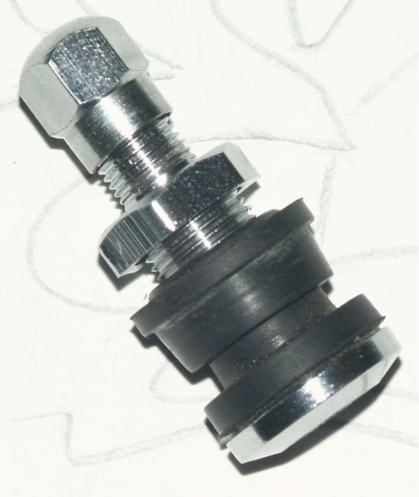

Presta valves are the long skinny type used on road bikes. You will NEVER find them in home depot. They are not sold as just a valve either. They are formed into the bike tube. I got a couple old ones for free at a bike shop and just cut the tube off. Presta's are difficult to use since the pump often presses down the button and releases all the air. I used one on a micro coax. cannon because you can fill it through the Presta and the button sticking out makes a cool little trigger to exhaust the air.
If you don't need them for that purpose, Schraders are the way to go.
This is what a Presta looks like:
