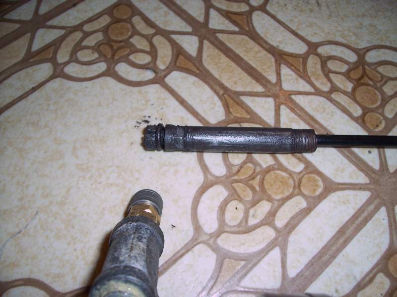

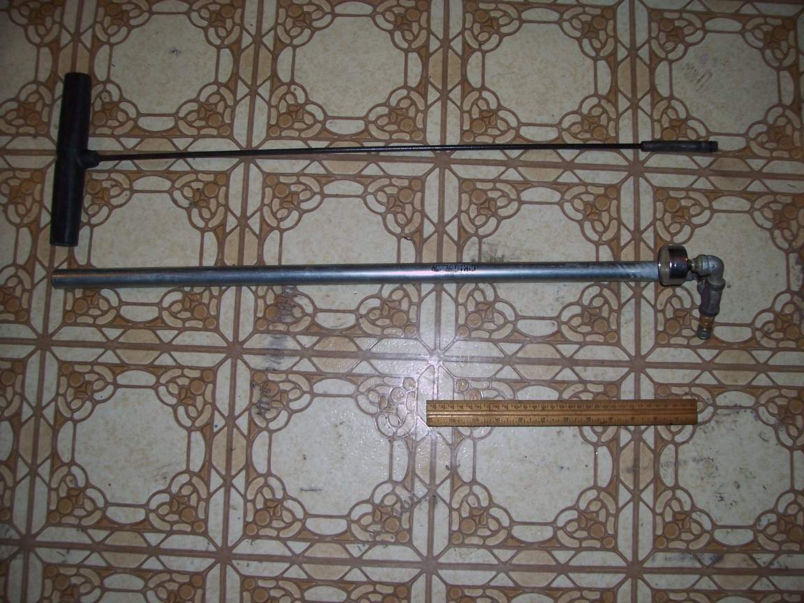

I guess I should post this before I get lazy again.
This pump is not completely done; I still need to make a solid base and bolt everything down (It's hard to pump as it is right now).
-Body: 29" x 1/2" copper tubing
-(sleeved in 3/4" conduit for strength)

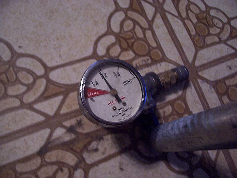

-Gauge: 0-1800 psi oxygen rated.
-Hookup: Mirco- quick connect valve
-Floating o-ring piston
-Homemade check valve made from modified fitting+schrader valve.
The schrader valve works, but it takes a lot of force to open it, so pumping becomes harder than it needs to be after a while. I may replace it with a completely homemade checkvalve later.
Prices:
Copper- ~$6.50
Fittings- (2 elbows, tee, bushing ~$7
Handle from and old pump which cost $10 before it broke
Everything else- Free
And of course, I don't have a gun to use this with.
Should be able to get past 1000 once I get a base made.

Looking good! That's very good pressure. Now you need to build something to use it in. (It'll drive you nuts if you don't.) :wink:
Just an idea, why not take spring out of the schrader so it closes by pressure only - or even easier, just use a presta valve?
Well, Apparently this is the only schrader valve in the world that has an internal spring(not visible on the actual valve), otherwise I would have. I don't think anyone sells presta valves around here. In fact, I don't think I've ever seen one in person.

wow... if I use 1/4" pipe will I get 1200 psi easily ?
Blowing a line at that pressure would be nasty! Nice work! Now, will your gun hold that kinda pressure? I guess so, you built it for that reason.
