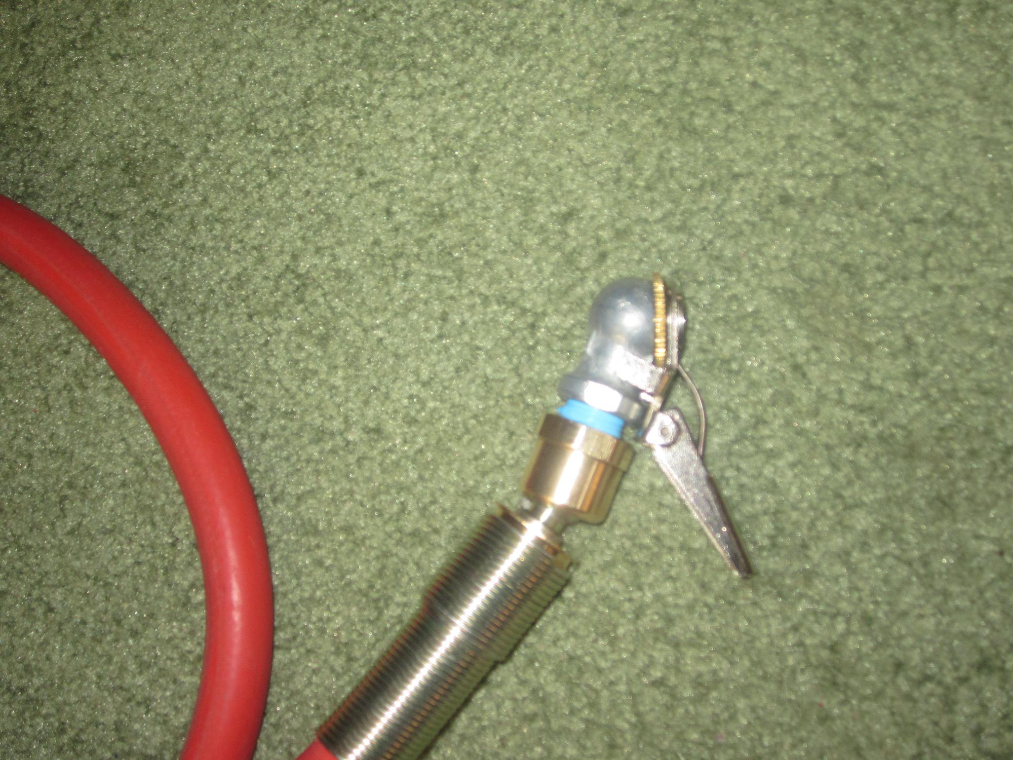

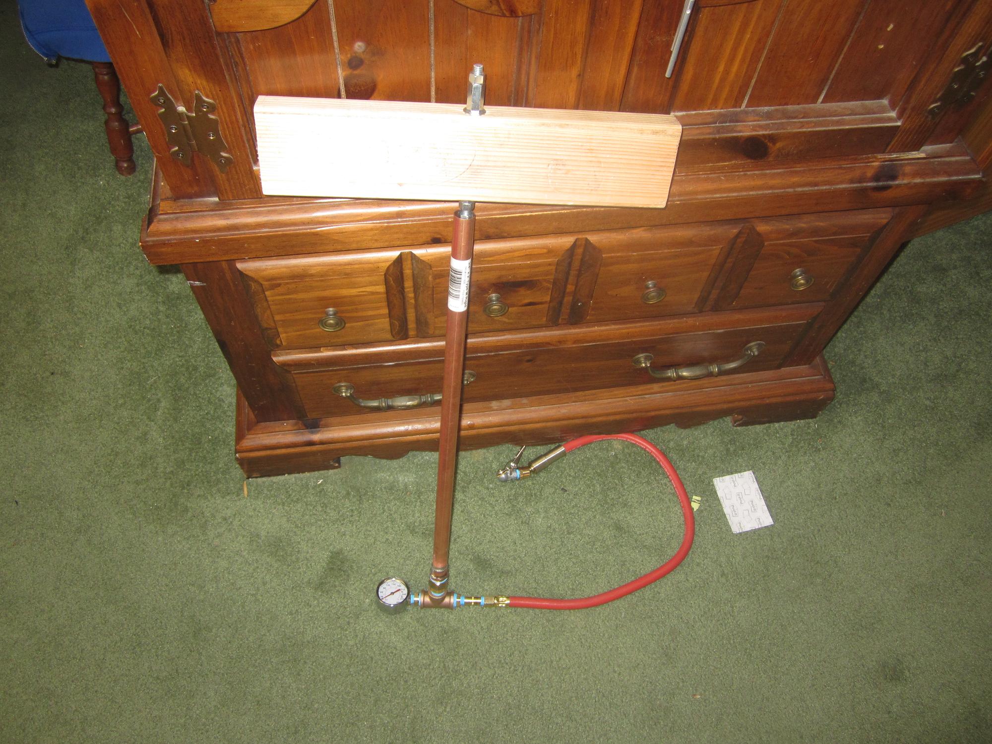

Hey guys, just got done building my new pump and I seem to have an intermittent problem with the air chuck. Is this air chuck just useless for this application? Its a Milton industries lock on air chuck. Sometimes it pumps fine, other times it only puts like 100 psi into the launcher and the rest just pressurizes the line. What type of chuck do u guys use for homemade high pressure pumps? I really dont want to cannibilize my track pump as its perfect for lower pressure shots.
looking good
why did you use a plank instead of a pipe, looks uncomfortable.

For high pressures, you really want something that threads onto the schrader, a friction fit will pop off below 200 psi typically.

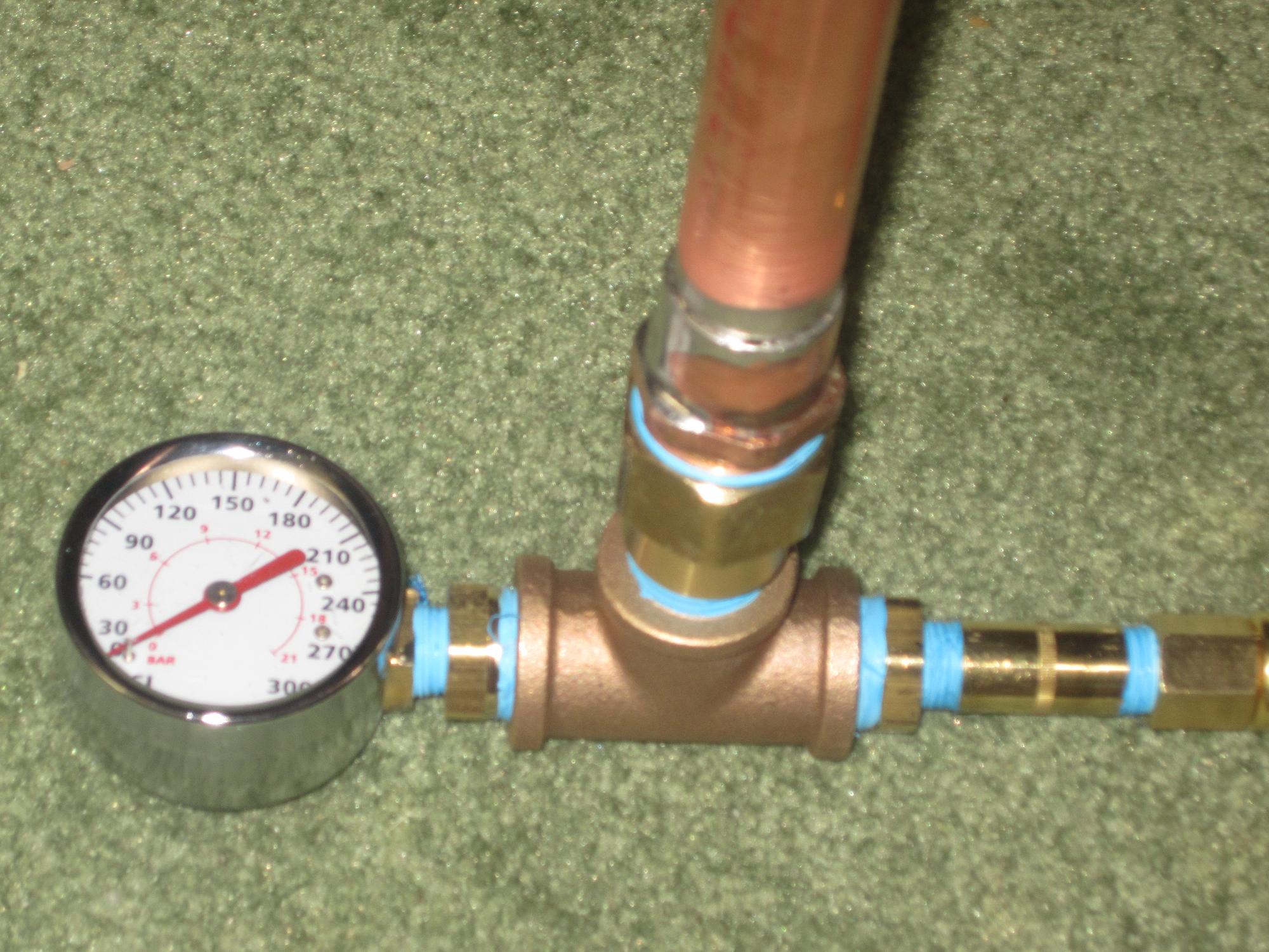

Thanks Jack! The 2x4 is a temporary solution, though i feel plenty safe with it's strength. I had originally purchased a 1/4npt to 1/8th npt adapter thinking a schrader must be 1/8th,...alas it's not, some strange thread pattern i guess. this air chuck is nice, for a car or bike, but without attaching it to anything, it leaks beyond 240psi. So right now the pump is great up to a male 1/4npt fitting on the end of the hose. Just have to do some searching for a thread on chuck on the interweb. Thanks for the suggestion!
I took the chuck apart, and found it to be a slightly odd design. The pin is floating and has no spring behind it, either gravity drops it onto the sealing face, or a decent rush of air through the hose. It may be time to mod this thing!

Ok so I cannabilized my Blackburn trackpump for the chuck. I successfully threaded and epoxied the chuck into a brass male/male 1/4npt adapter. No leaks, so I first went to my previous high psi for the gun and old pump which was approximately 210psi. No issues, dry fired it in the garage. My next test was to set some new bests while testing the gun/pump system. Went to 300 psi, left the pump attached to the gun, ate dinner, came back and it was still @ 300psi. Dry fired in garage. Later I decided to keep pushing and I took the launcher up to approximately 350-360 psi. No issues, I left and came back 5 min later, still 360 - I put literally one more pump in the gun and the chuck was blown partly off the schrader but still depressing the valve...Needless to say the gun fired in my bedroom and my ears are still ringing an hour later hehe. Jack ur right, for high pressures, a thread on chuck is totally neccessary. Could have been dangerous if ammo was in the barrel.
