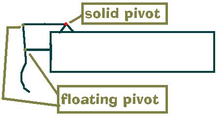

if you look around in here http://www.spudfiles.com/forums/viewfor ... 94b8ec0a0a you will see that you are making something rather un-ordinary. Like JSR said it would work...it works on paper. But a barrel sealing piston or a sprinkler valve would probably be easier. If your making that small of a caliber I would say stay away from a sprinkler valve as you will need some serious pressure to get that small of a projectile to do anything impressive, and sprinkler valves just can't handle real high pressure. This design could handle some good pressure if you use metal for all the parts, and good strong connections. High psi air can be a bit dangerous so be careful.
another thing I noticed is that when you pull on the trigger you will be putting a sideways load on the spring and bolt mechanism. This part is going to be the biggest challenge so seal well. Maybe you could design a lever kind of like on a grease gun to link the trigger to the bolt, so that you would have a straight pull on the bolt. I drew a real quick drawing for the idea.
Good luck, Lock
quick drawing.JPG (14.94 KiB) Viewed 2807 times
