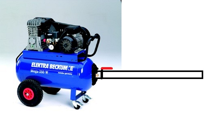

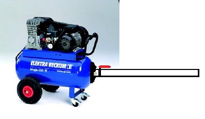

I saw one like this this past summer that had a 4 inch steel pipe that was about 3' long on a similar size compressor. It used a 1" valve that was conected to and existing port. The valve was obviously way too small but it was cool. It was designed to launch short 2x4s, they used a foam sabot.
metalmeltr
- Specialist 4
- Posts: 426
- Joined: Thu Dec 18, 2008 3:42 pm
- Location: united states
A burst disk would definitally be the most cost eficient in larger bore sizes.
- Technician1002
- Posts: 5189
A burst disk has high reset times and consumes resources. A butterfly valve, or piston valve provides high uptime for a great afternoon of launching stuff.
If using a ball valve, to compensate for the relatively slow opening times, go over size, for example use a 4 inch valve to feed a 3 inch barrel.
Due to the chamber size, I presume you are making at least a 2.5 inch barrel?
With a ball valve you will get this type of performance.
