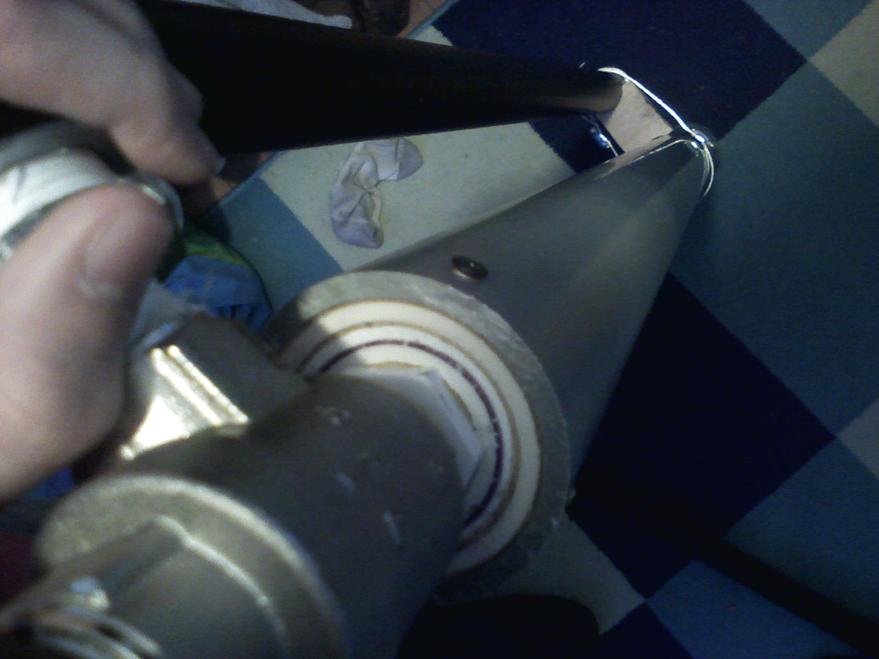

What I did was I made my own bushing. Do not try to do this if it is going to have to hold pressure!! My tennis ball cannon has a 3/4" QEV on it, so I had a 3/4" pvc bushing, which will fit into 1.25" pipe,which will fit into a 1.25" coupler, which will fit in 2" pipe, which will fit into 2.5" pvc electrical conduit. All I had to do was wrap tape around each of the fittings until it was a tight fit, then I stuffed it all into the back of the barrel, then secured it with a few screws.
Edit: here's a picture of my setup, you can sort of see the different couplers and pipes.
The home made bushing (yes, there is a dirty sock in the picture)

potatoflinger wrote:What I did was I made my own bushing. Do not try to do this if it is going to have to hold pressure!! My tennis ball cannon has a 3/4" QEV on it, so I had a 3/4" pvc bushing, which will fit into 1.25" pipe,which will fit into a 1.25" coupler, which will fit in 2" pipe, which will fit into 2.5" pvc electrical conduit. All I had to do was wrap tape around each of the fittings until it was a tight fit, then I stuffed it all into the back of the barrel, then secured it with a few screws.
Wouldn't that leak? or would you put some sort of sealent against it.... Epoxy maybe?

brogdenlaxmiddie wrote: Wouldn't that leak? or would you put some sort of sealent against it.... Epoxy maybe?
That's why I said not to use it for anything that needs to be able to hold pressure. There is no sealant or epoxy on it, I just wrapped the different parts with tape to make them seal a little better. This was for the barrel, and only needs to hold pressure for a fraction of a second, so a small leak is not a big deal.
