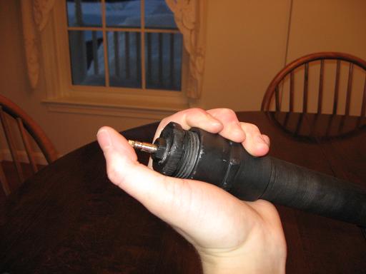

- The Gun in its Miniature Black Beauty.....
- IMG_0157.jpg (29.39 KiB) Viewed 4563 times
- how you Hold/Fire the MiMg
- IMG_0142.jpg (26.85 KiB) Viewed 4563 times

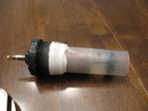

- My Sexy Piston (blurry Pic sorry)
- IMG_0153.jpg (24.74 KiB) Viewed 4563 times
- The Piston In its Housing (note its a Syringe Tube....)
- IMG_0156.jpg (27.35 KiB) Viewed 4563 times

BTW i Reccomend this style of piston to EVERYONE. it has not failed me yet, and this piston has been through about 3 different guns and 300 PSI now....
(also, i found that if you dont align the syringe head perfectly, it doesnt seal perfectly, making it a perfect piston sealing face........)
EDIT: I tried a Steel Marble in this thing this morning......... Nothing wakes you up (and puts a smile on your face) like riddiculous recoil..........

I guess i didnt explain it extremely well.VH_man wrote: (also, i found that if you dont align the syringe head perfectly, it doesnt seal perfectly, making it a perfect piston sealing face........)
what i did, was put the syringe head in, then just "poke" one little side of it so it doesnt seal 100%. basically, that syringe head isnt entirely straight.
It was more dumb luck though, i intended this piston to be Airtight initially
