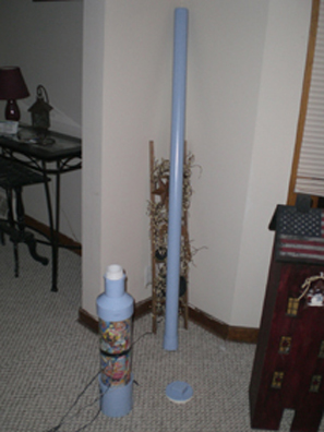

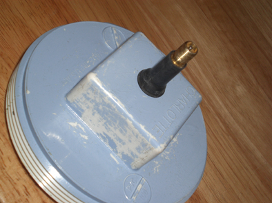

well, here it goes......After a week of studying this website and the burnt latke website, and my fiance tellin me i'm childish...this is what i came up with...its almost finished...i was gonna go with the camo paint like that one guy on here did with the leaves and stuff (good job man!)...but i had a bunch of garbage pail kid stickers lying around and i thought it would look kool....i'm using meterd propane...i think i'm gonna feed it in thru the endcap with a shrader valve. i still have to house the wires for the fan and ignitor..so its not completely finished yet..should be done by later today, and i'll post a pic or 2 of the finished product...i have a feeling i'm hooked now, and will probably build another, and another,.......see where i'm going?..lol...i know i should have placed the ingnitor screws where its double layered, but i kept reading that its better to place the ignition in the middle of chamber...anywayz here are as much specs as i can think of for the moment...

i pretty proud of it, being my first...i hope this may spark some design ideas for someone out there......enjoy!

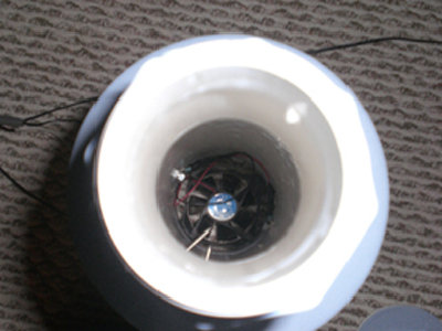

took picture looking in thru top end of chamber

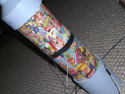

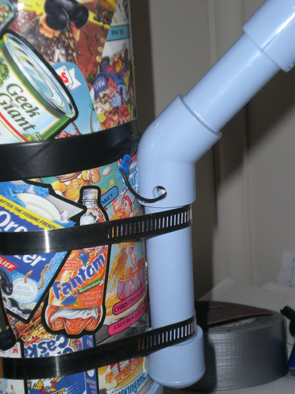

almost finished
almost finished

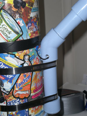

drilled holes in handle, and wired up to ignitor button.

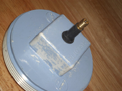

shrader valve, i saw someone else on here with one...works good!

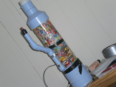

finished gun
finished gun

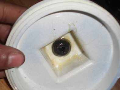

added pictures of pretty much finished gun...i shot 2, 5lb bags of potatoes yesterday....i'm convinced that these are not toys...i think i was gettin at least 200 yards.. shot clean thru a piece of plywood without even knocking it over...the gun held up pretty good except for one of the connectors for the fan wires snapped....used electrical tape to tape wire over the bolt as a quick fix, and kept on chuckin!....thats why the tape is wrapped around the end fitting....i don't have a psi meter...it took a while to get it right...i unscrewed the flare piece off of the propane torch fitting, and clamped a 1/4 inch gas line hose on to it...other end of hose has an air chuck...just connect that to shrader valve on endcap....open gas valve for ONE second....run fan 10 seconds and it shot pretty much every time....i have an on off switch...for the fan i have to wire it up and figure out where to mount it with the battery and its pretty much done...i do have one question tho...do you get any build up on the screws inside the chamber from the combustions? i noticed i'm not seing a spark every time i hit the ignitor button...only see it about every other time i click it....anyways lemme know what u guys think!

also i forgot....if ur wondering how i got the shrader valve in there..it was a little tricky because plastick was too thick to get it to sit right...we had to countersink it.
