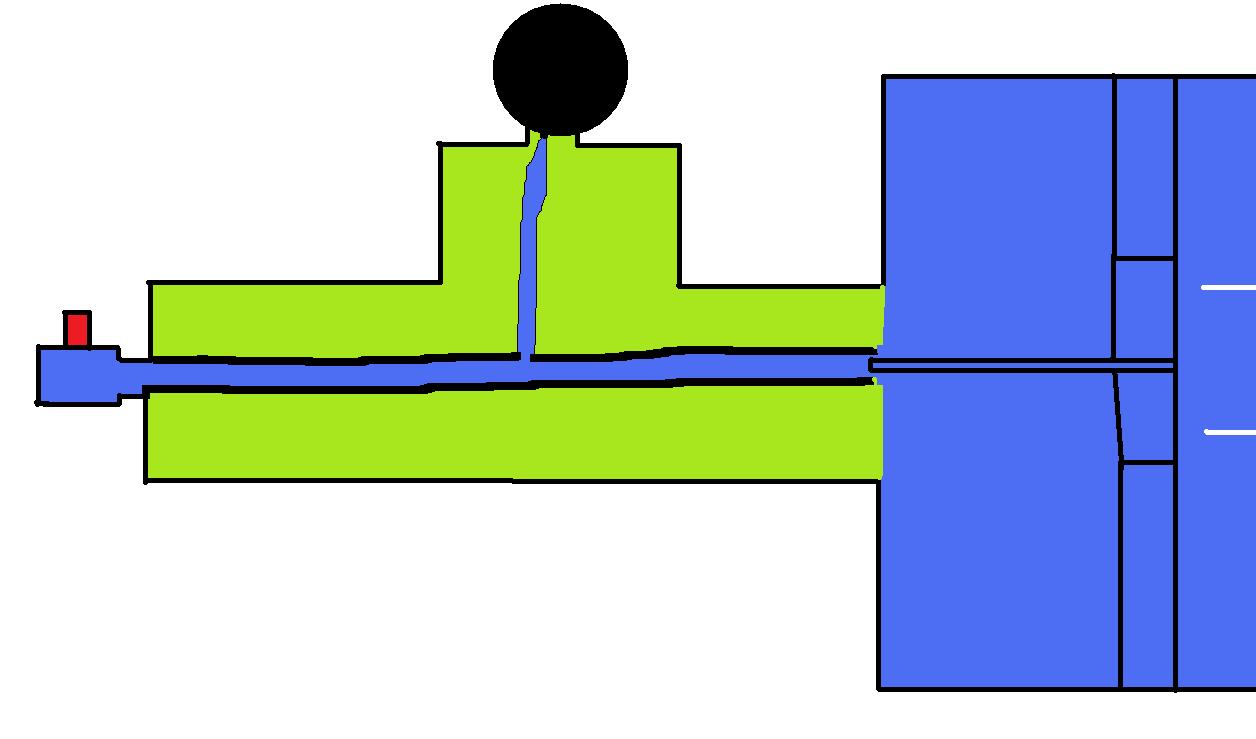

i am bored and decided to tell you guys this.
people are complainig of peoples pilot volume but the dude with the gun got no clue how to make it smaller.
it is a easy "build" and i am sure jsr has done it before.
look at the pic. ask if you don't understand
if you look ar the TEE there that is 2" and a 1/4"ballvalve for pilot. put some weding rods i the TEE were you need air to flow and fill with epoxy around. then take them out and the TEE volume it like a 1/4" TEE (make the space in there as big as your pilot valve)

You may be able to forgo the welding rod and just use and epoxy filler. Like Bondo or JSM's famed low viscosity stuff... Even a glue stick worth of glue may work...

i mean something to cast around.
fill with something and pull them out.

It's a good thing to point out, if your pilot valve is say 1/4", any piping leading to that valve bigger that 1/4" is simply a waste.
SpudFarm
Posts: 2571
yes just unneeded pilot volume.
