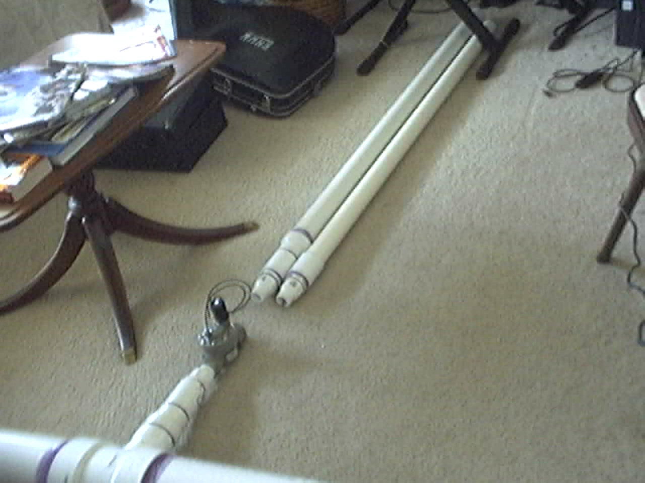

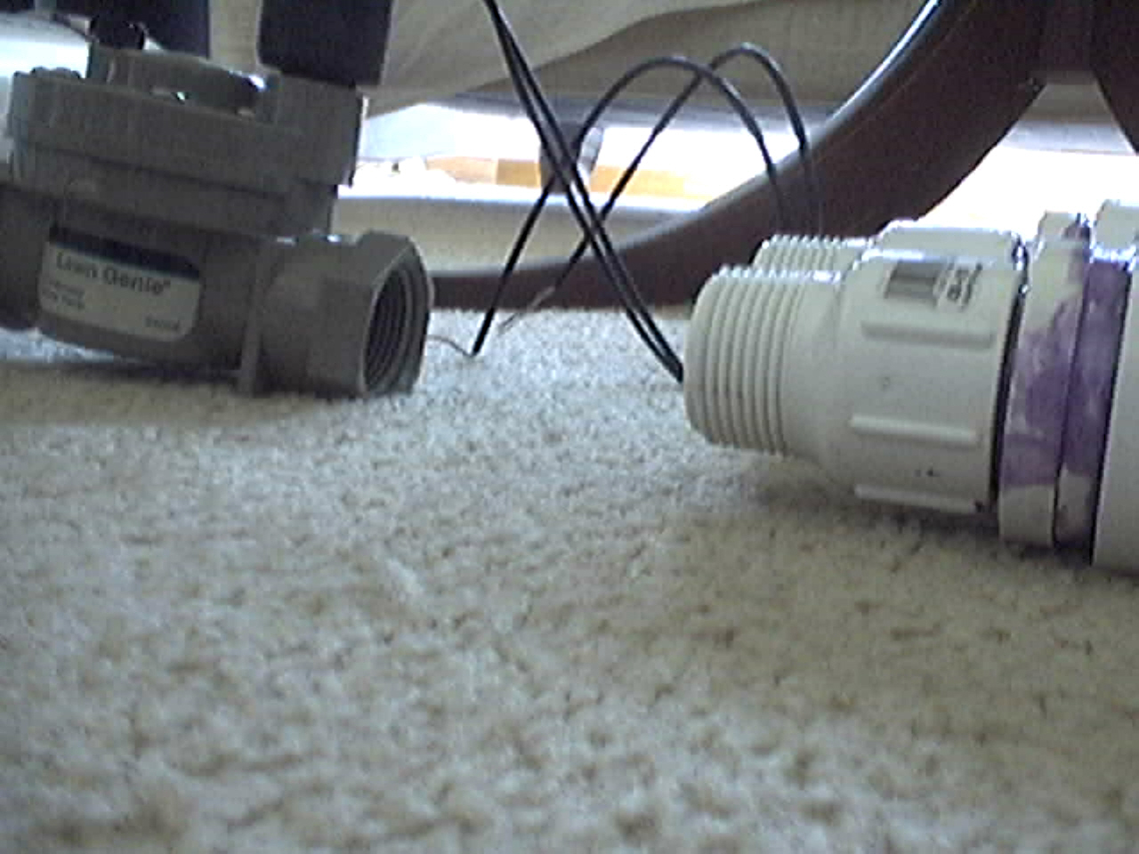

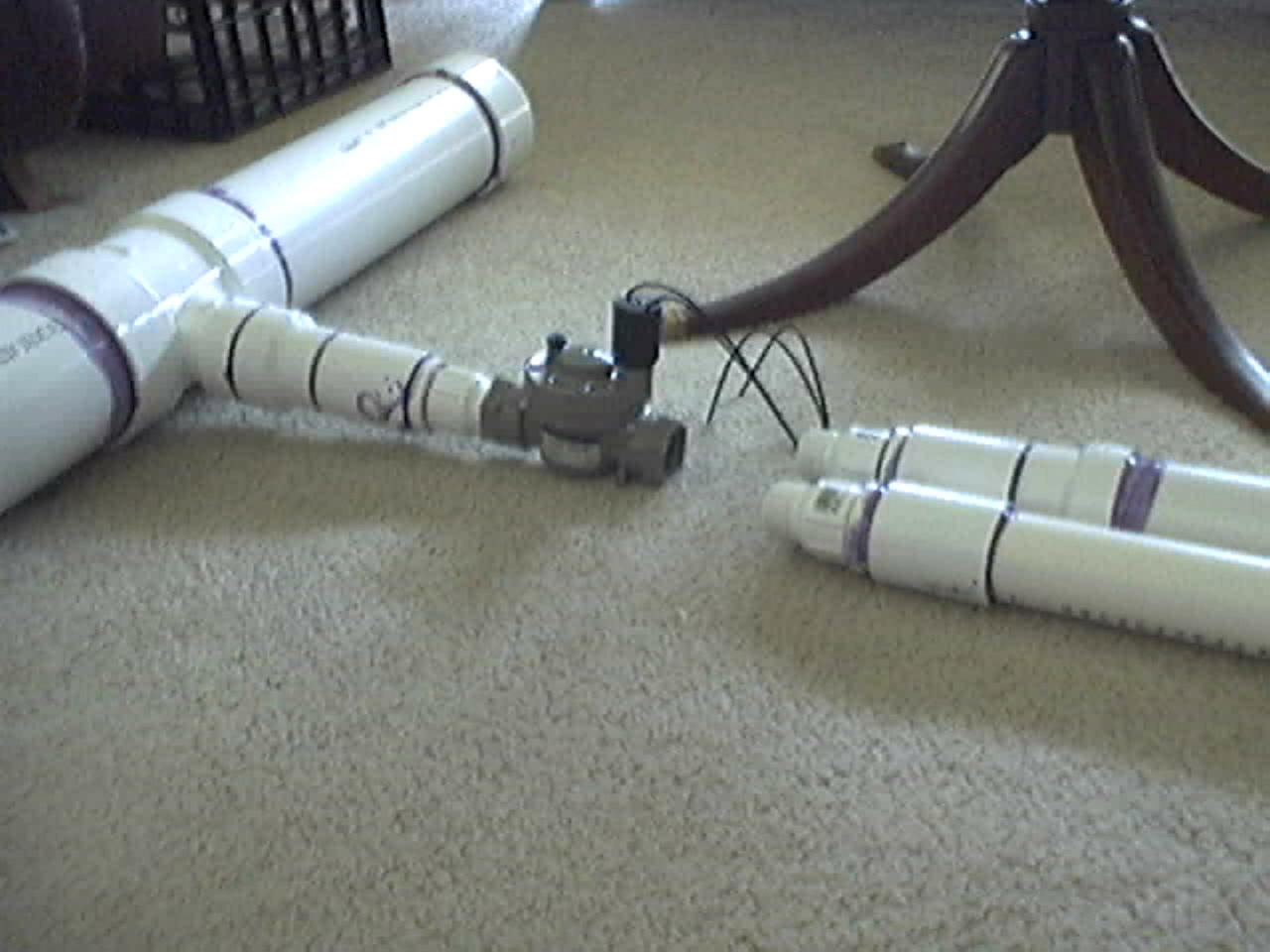

Here's the first air cannon I have ever made. I made it a while ago (I was a 7th grader, with hardly any help). I just discovered this forum recently, so I decided to post it. Nothing special. :wink:
Specs:
Air reservoir: 4" PVC pipe, about 5-6 feet long
Valve: regular sprinkler valve :)
Barrel(s): Interchangeable! (w00t) one is 1 1/2", the other is 2", both about 6 feet long
I only Pressurize to about 40 psi these days, because the PVC is old. do you think I can go any higher? (safely?) :roll:

bigbob12345
Posts: 1516
You used DWV so i wouldnt take it above 20psi
but other than that it is actually a pretty nice gun :)
the barrels could be longer and the sprinkler is constricting flow like crazy but its your first, you can always improve next time
OuchProgramme
Posts: 371
Joined: Sat Jan 12, 2008 7:30 pm
Looks like you have some DWV piping...change it next time. DWV is Drain Waste and Vent, which doesn't take pressure. I'm glad you've only charged it to 40 PSI...any higher than 60 will be...
BOOM.
Scrap the death trap and build a new one w/ pressure rated pipes.
4'' Air Chamber is overkill for a pneumatic.
Old PVC is safe to use
bigbob12345
Posts: 1516
OuchProgramme wrote:4'' Air Chamber is overkill for a pneumatic.
If you have suffeciant valve(2in to 3in porting)then it is not over kill at all.
but in this case with a sprinkler, yes it is overkill

it is NOT DWV pipe. it is SCH-40 pipe, rated to 220 psi
tmacd995
Posts: 34
Joined: Wed Feb 27, 2008 10:36 pm
The pipe may be SCH 40 but the fittings look like DWV. Look on the ring on the fitting where the pipe slips in. Anything that doesn't say NSF-PW has to go. The Spud Wiki also has some useful ways to spot DWV, such as the flared fittings and the fact that your reducer bushing doesn't slide all the way into your coupling.

starman
Sergeant Major
Sergeant Major
Posts: 3027
Location: Simpsonville, SC
Oops, I see you have been beaten about the face and head with a wet noodle by the DWV police, right out of the shoot.
They are referring to the tee and bell reducer you used to transition from your tank to your barrel...maybe another part or 2 in there. Officially, those parts have no pressure rating. Your pipe and tank endcaps are fine.
In practice, you'll find that there are practically NO 3 or 4" connector parts that are pressure rated available at your local Home Depot or Lowe's...the pipe and endcaps are the only parts "rated" there. The biggest issue with the non-rated parts is the fairly shallow or loose fitting weld sockets. DWV parts that get sort-of a pass are inline couplers and female cleanout couplers. Go to a plumbing supply shop to find pressure rated tees and use reducer bushings/couplers to go from one size pipe to another, avoid the bells.
Also, you'll find combustion guns get almost a total pass on any PVC parts used...pressures rarely exceed 30-40 psi during the shot and for only a few milliseconds. A pneumatic however is holding back air for much longer and is at your whim as to how much you force in there.
Welcome to Spudfiles! Keep your pressures in this gun in the 50-60 psi max range and you'll be fine.
Edit: As has been stated, the 1" sprinkler is choking your performance in this design. I wouldn't waste much effort replacing it. Just move on to your next gun project.
