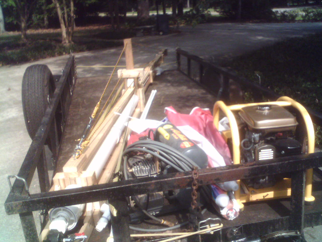

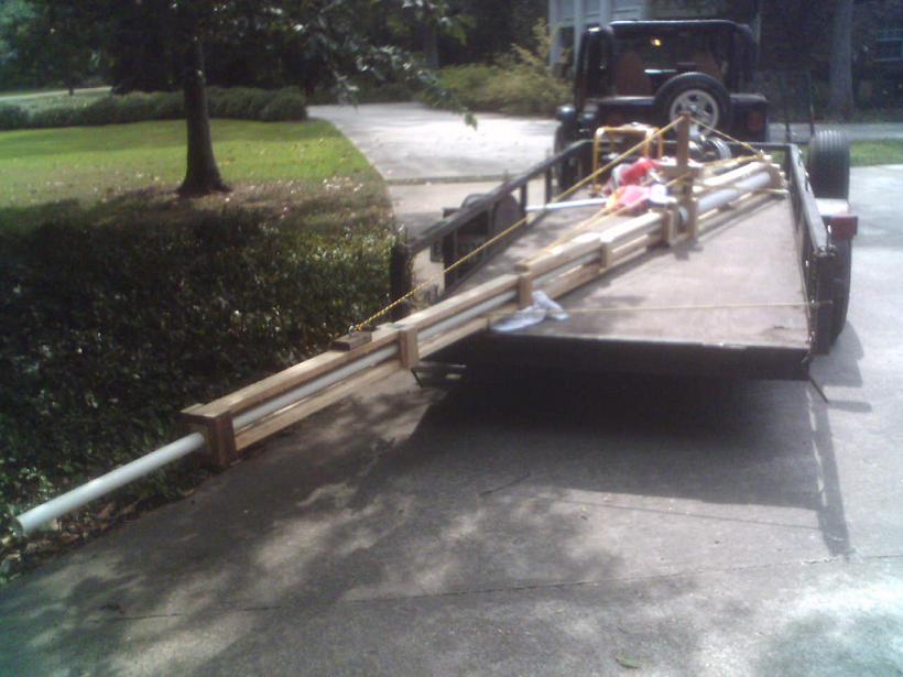

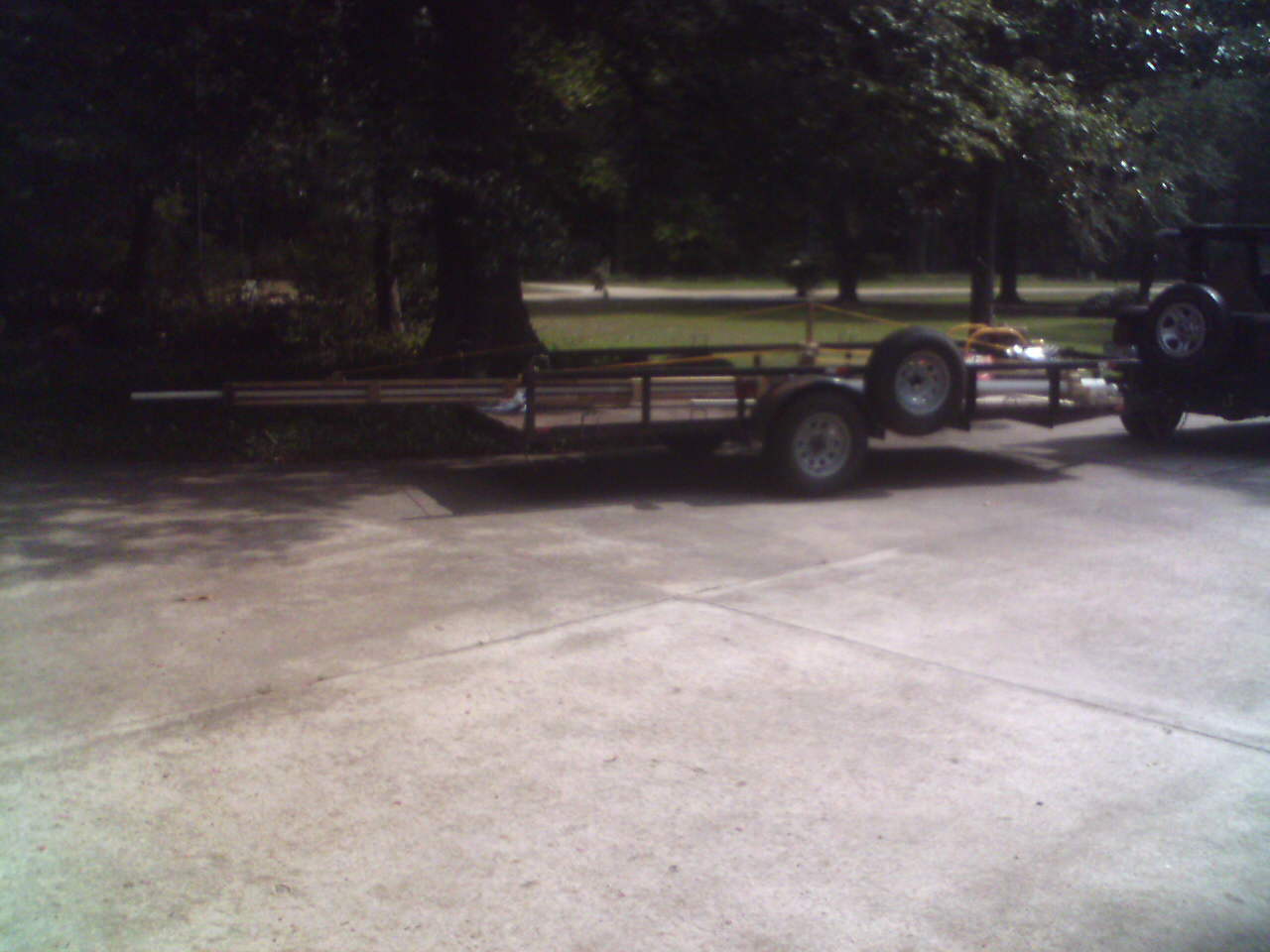

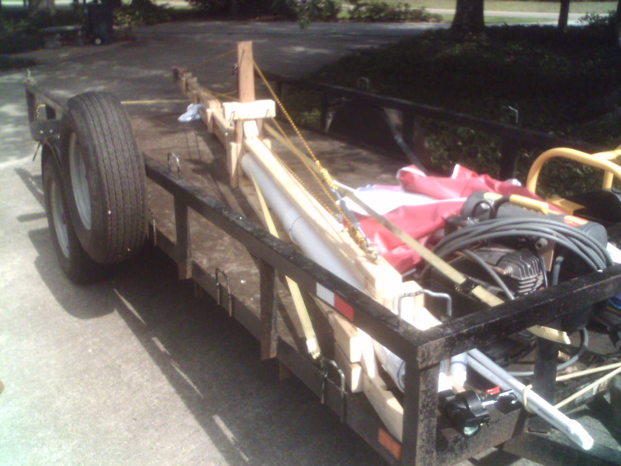

Hey yall this is the last cannon I had built before the SGTC forum shutdown. Its the biggest cannon I've built, but theres always room for improvement :P

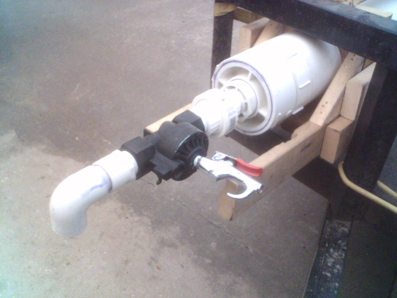

Its a coaxial barrel sealing piston valve. The piston is 2 3" endcaps with a rubber washer bolted to one end. It seals a 1.25" x 20' barrel, perfect for d cell batteries. The camber is 4" x 8' and is exhausted by a blowgun actuated 1" sprinkler valve.

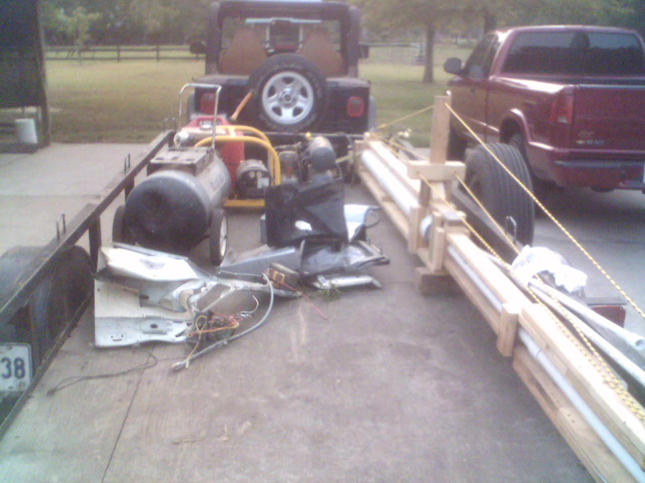

on the trailer is a generator, compressor, and the days victim: a microwave :twisted:
overall, it measures 24' and packs one hell of a punch

as far as distance i really have no clue, but damage wise, it will puch a clean cookie cutterhole through 1.5" plywood at 60 psi. i also tried to puncture that comprssor tank you see on the trailer at 60 psi, but large dents is all it will manage. When i find the pics i'll post em. At 90 psi it put a nice hole in an old car doo though, ido remember that!

And Jared, i'm not too confident on taking the pressure up above 100 on those diaphram valves arent they rated for 115? i'm really not surem but if they are, then i'll just have to turn my regulator up a tad :D

100 on those diaphragm valves aren't they rated for 115?
It would depend on what valves you bought...you should be able to look it up online but I have a couple that are rated to 150 psi... and didn't pay more then 20 bucks as piece for them...

Most sprinkler valves I've seen are rated to 10 bar, roughly 150 psi, so I'd be comfortable taking it to that pressure - and on a launcher of this magnitude, a few extra psi translates into a substantial gain in muzzle energy *hint hint* :D

Ah alright, I believe its a watermaster? I really don't remember, but I'll have to look into that. What brand are those valves you mentioned?
