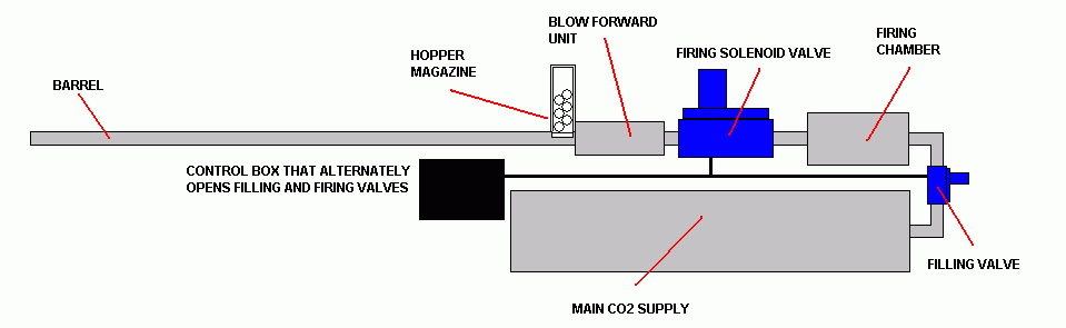

With the blow forward valve (as Clide used with his GB semi, and I used here and here - different configurations, but it's the same concept), as long as you're pulsing the air (I'm assuming firing valve closed - fill valve open the firing valve open - fill valve closed as an electronic sequence) you can have full or semi autopmatic fire. Using spherical projectiles such as lead balls you can feed from a hopper (in the same way paintball guns do) and potentially have it big enough to fire as long as your tank is emptied, without having to reload.

Thanks for the compliments, but I can't take all the credit, most of the ideas I use are either taken or developed from this forum. It's really more a question of being able to work with materials.
As to your idea, I would envisage something like the diagram below to be perfectly feasible as far as functionality is concerned. The question is being able to afford and put together the right components, it will take someone with a bit of electrical knowledge to develop the firing circuit for example - but with the right resources, I'm sure it can be done.
- co2auto.gif (6.25 KiB) Viewed 2043 times
