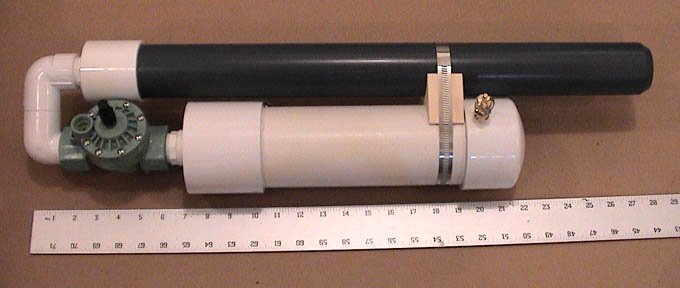

Amizingly clean, I love it. Joel always amazes me
<img src="http://www.spudfiles.com/uploader/uploa ... 980630.gif">

Where do u get the push button for the sprinkler valve?
while the gun looks good i think the chamber is unnecessarily large. The U-connector made from the two 90° adapters is way too small, making a bottleneck.
In any other cannon with a longer barrel this wouldnt be a problem, but the barrel is so short that there would be a hell of a lot of wasted air inside that chamber.
Anyways, it looks good so if u can overlook that small design error then its alright.
the bottleneck occurred way before the two 90 elbows... the sprinkler valve! there is no way around the bottleneck and it actually makes more sense to keep the same pipe size as the valve until you hit the barrel. also, how is the chamber unnecessarily large?
maybe you shouldn't start off your posting here with complaints about other, much more experienced people and their launchers...

whatsthe lil ,eddal thing at je end of the chamber called? isn' it where u pu in the air?
- Shrimphead
- Corporal
- Posts: 509
- Joined: Thu Nov 17, 2005 7:42 pm
Nope. That happens to be a safety pop-off valve. Basically if the pressure gets to high it opens so you don't risk blowing the cannon (and yourself) up. On the other side of the cannon there is a pressre gauge and a schrader valve to fill it up.

ohhhhh....how much are the scharader valves?
- Shrimphead
- Corporal
- Posts: 509
Like two dollars or something. Go to an autmotive store and get the pop-in tire valves. They are really easy to put in your chamber.

Joel doesnt sell the buttin vavle that he has mounted on the sprinkler valve, where could i get one of those?
PVC Arsenal 17
- Staff Sergeant 3
- Posts: 1762
- Location: United States
mcmaster has push-button valves.
