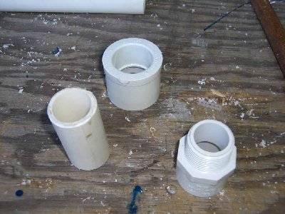

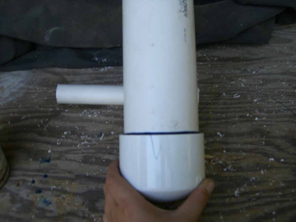

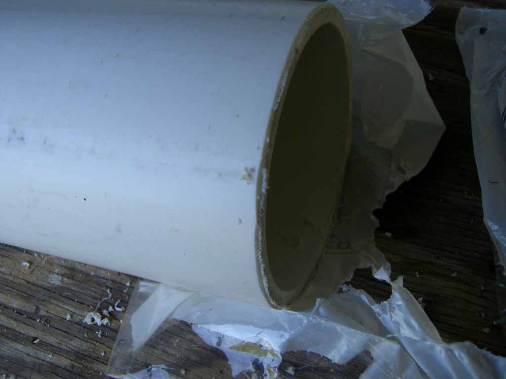

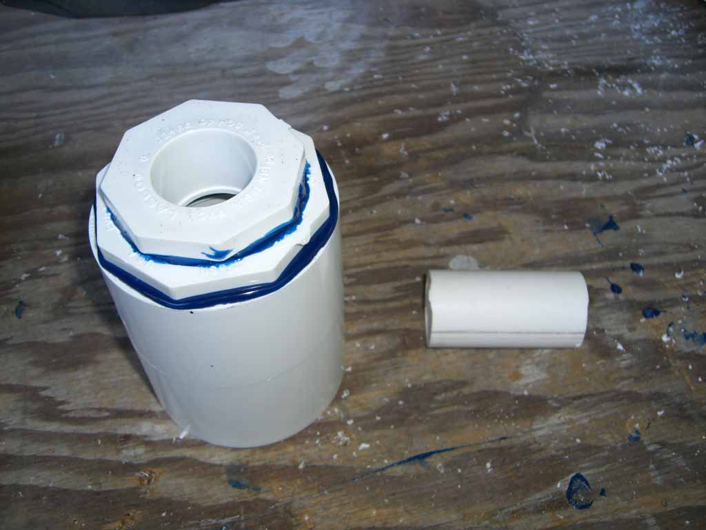

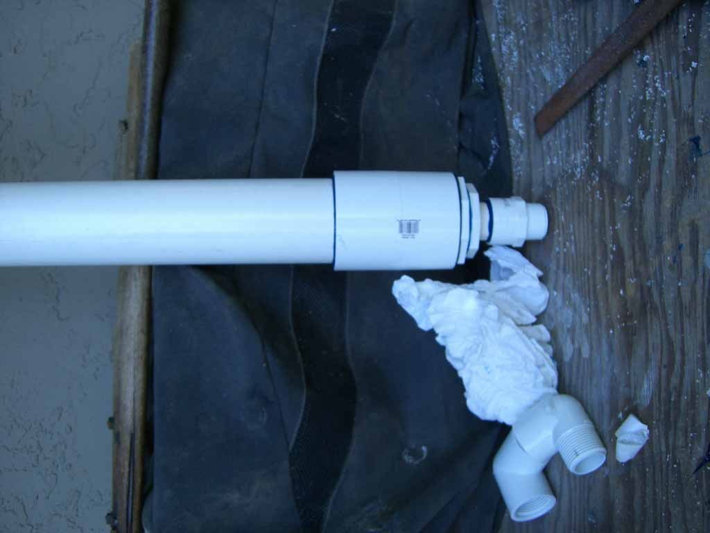

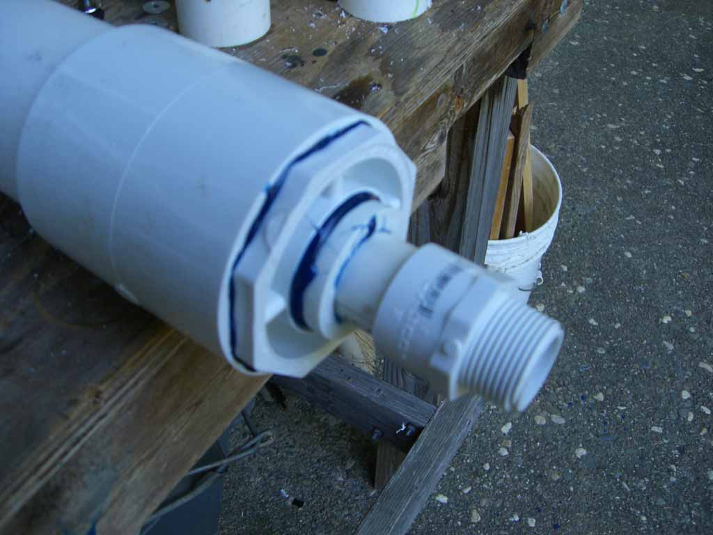

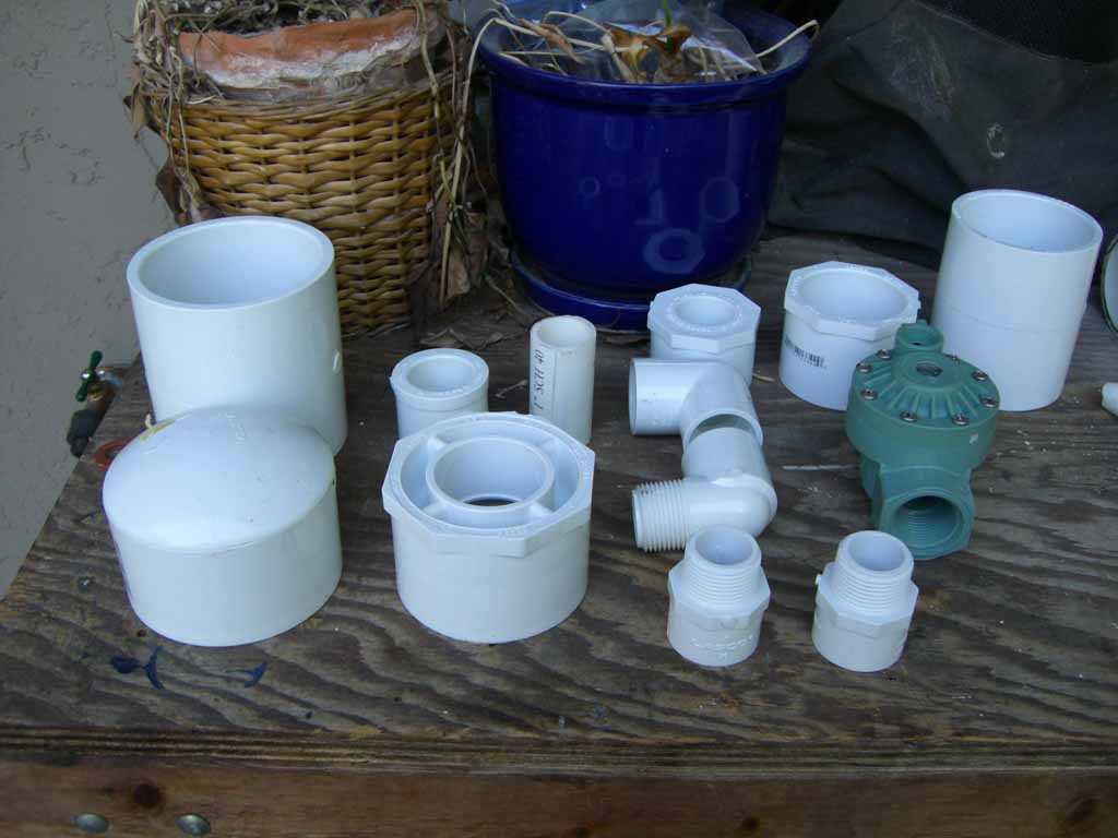

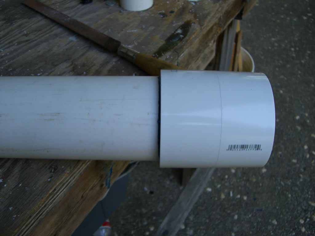

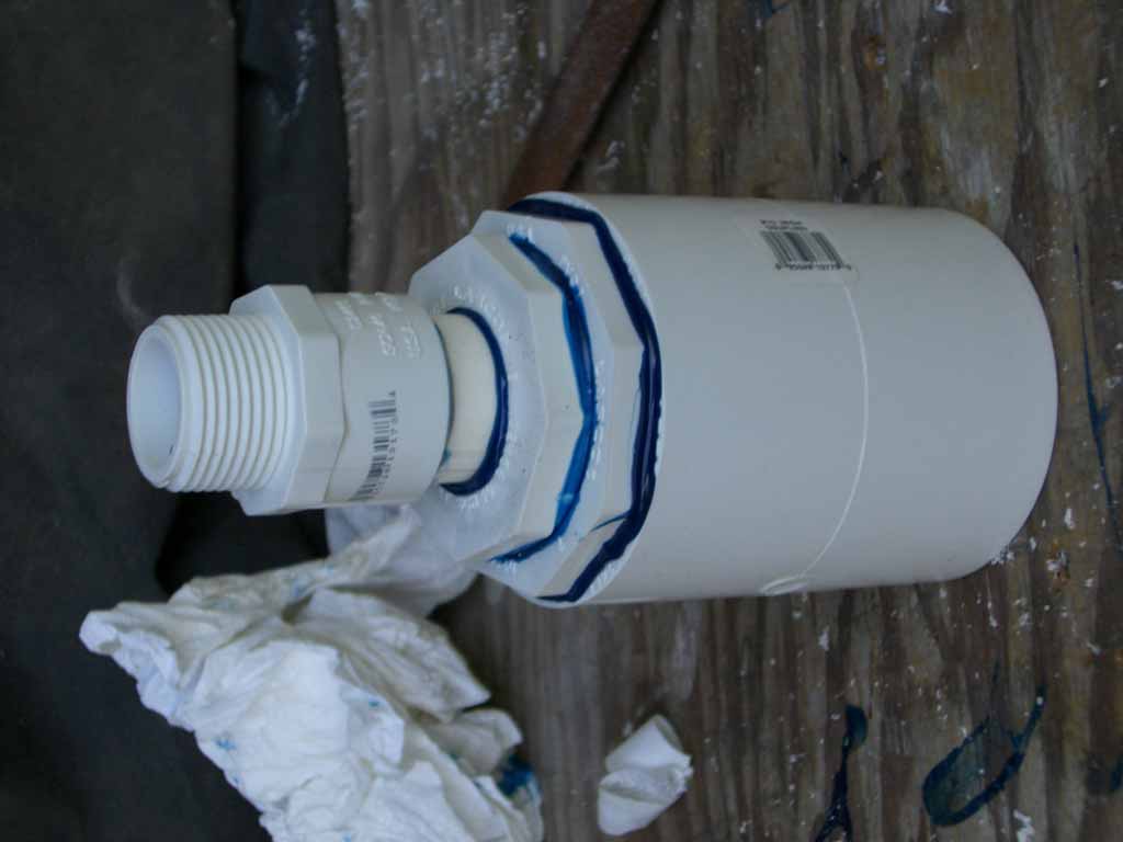

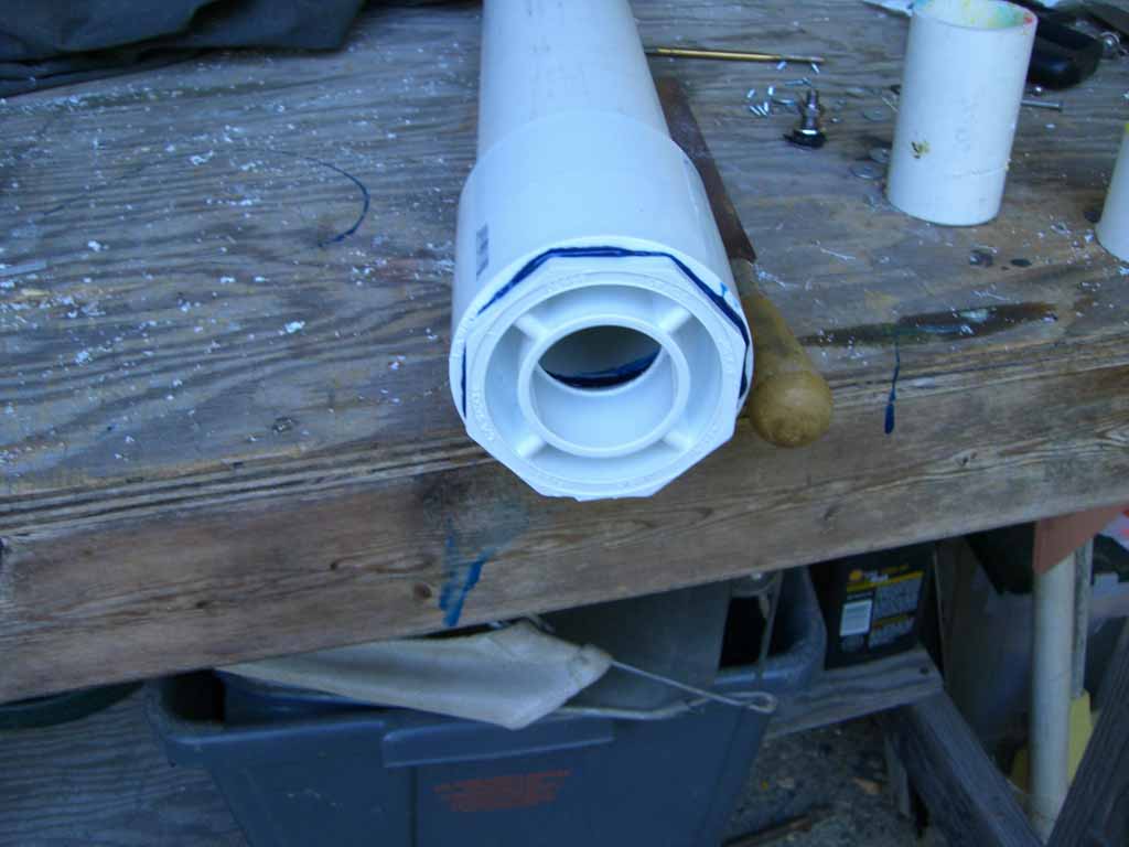

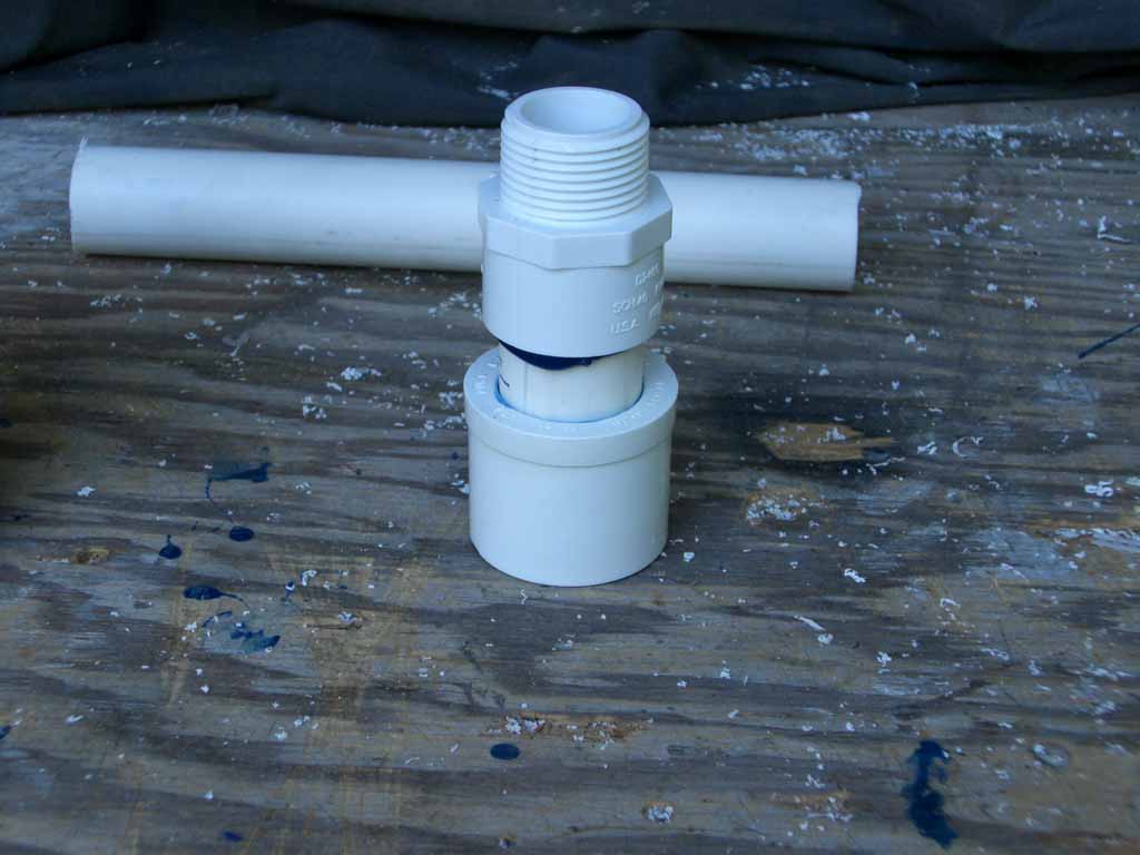

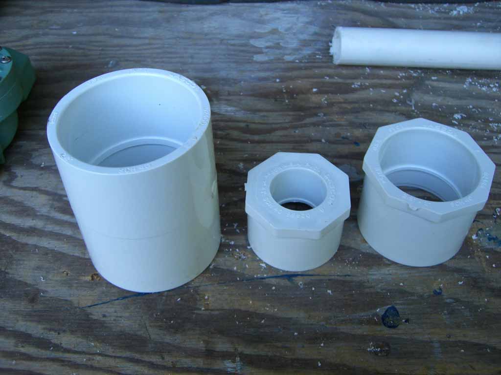

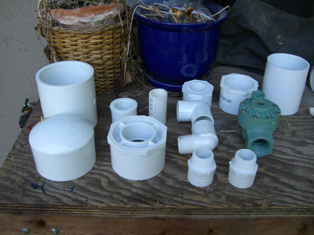

Alright so here it goes. Instead of spending $134.99 on Joel’s low power launcher, I am going to show you how to make one for about $100 less.
Materials:
1x 24” of 3 inch PVC sch 40
1x 24” of 2.5inch PVC sch 40
1x 3” coupling
1x 3” cap
1x 3” x 1.5” bushing
2x 1” male adapter
1x 2.5” coupling
1x 2.5” x 2” bushing
1x 2” x 1” bushing
1x slip x Mips 1” elbow
1x slip x Fips 1” elbow
1x 1” orbits water master modded sprinkler valve
1x 1-160 PSI ¼” NTP Pressure gauge
1x 1/8” NTP shrader valve
scrap 1” PVC
Teflon Tape
Tools (specialty)
1/4”-18 NTP tap
7/16” drill bit
11/32 drill bit
PVC Glue and Primer
START AT THE BOTTOM

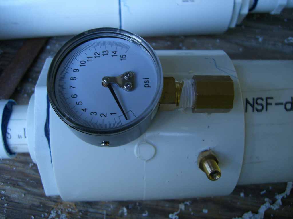

i want to see a picture of the whole thing, and why did you use a pressure guage that only goes up to 15 psi??

i used the 15 Psi guage because 15psi shoots tennis balls 75 yards, plenty far for dogs:)
also i need to get a gifferent elbow because the one i bought ans male and female threads where i only neded the male ill post pics soon though so dont worry

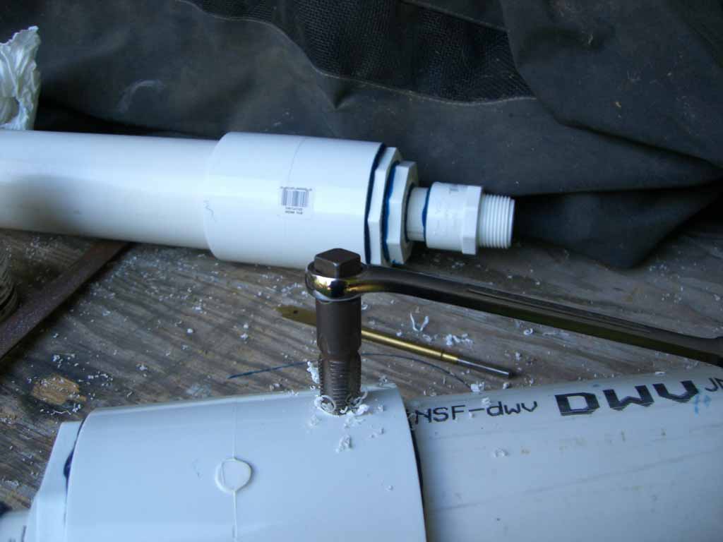

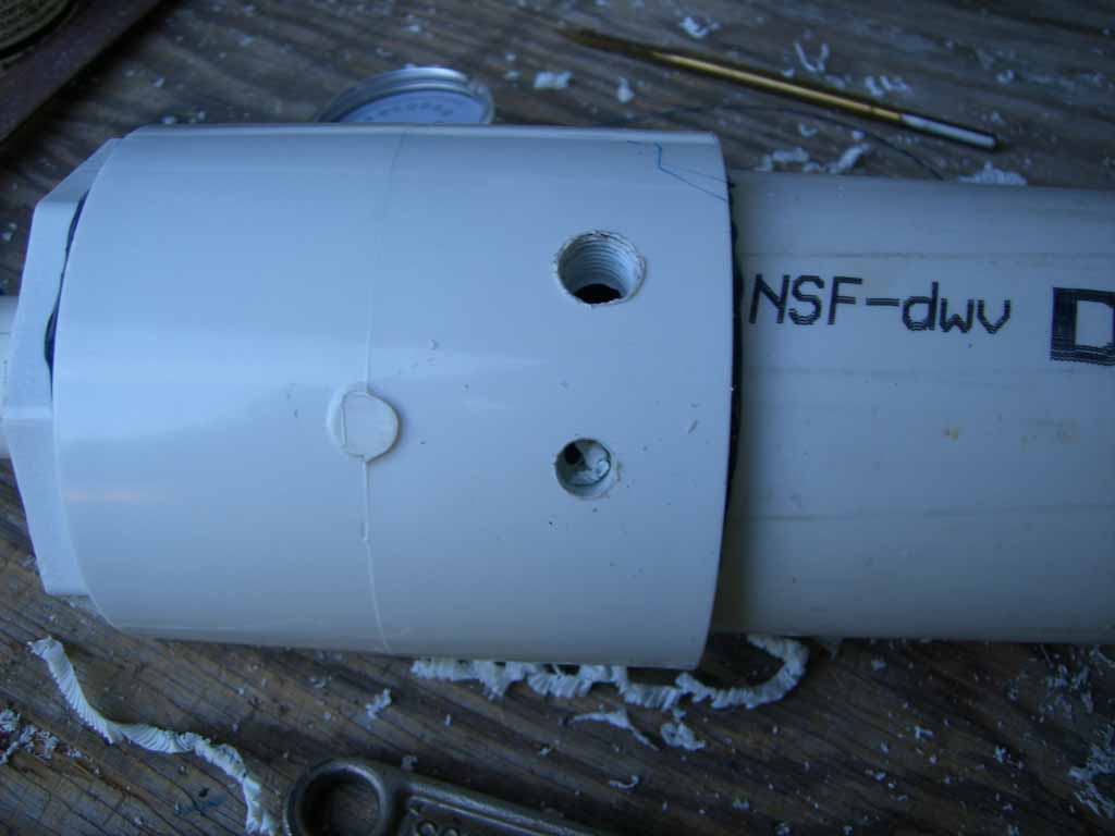

does somthing seem wrong with that drill and tap to u lol...Step Thirteen
Drill a 7/16 hole streight into the slace where you want youre gauge to be. then uaing youre 1/4" tap therad the hole. go in one turn and then out 1/4 turn to clear the threads.
a 7/16 drill is bigger than a 1/4 tap... when tapping you predrill the hole 1/16 smaller then the tap you plan on useing, not larger. so u put the wrong numbers for step 13. im a machienest so as soon as i seen those numbers i was like wtf??? hows that gonna work,lol
Obviously your not familiar with the NPT pipe thread.
For information on NPT threads, please refer to this article: <a href="http://en.wikipedia.org/wiki/National_p ... >WikiPedia Article - National Pipe Thread</a>
1/4" threads have a exterior diameter of .54"
