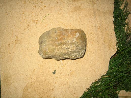

Broken grinding wheel that was my sealing face support
