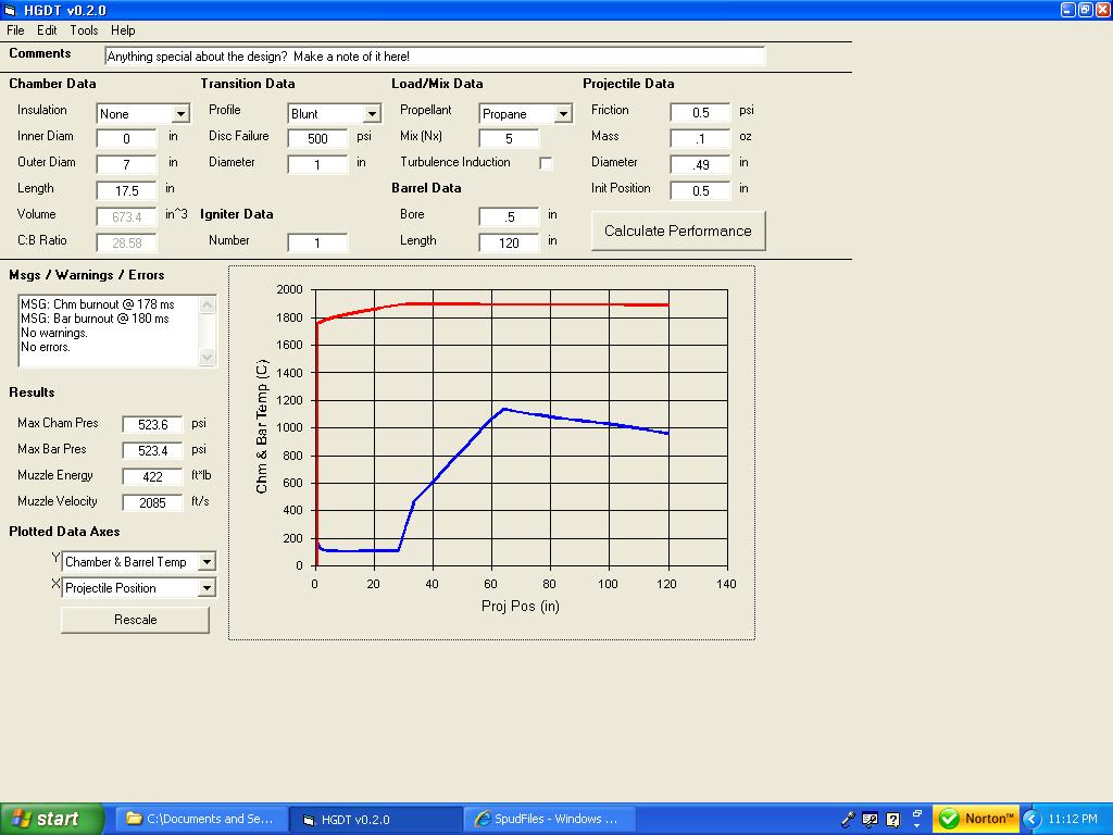

and what is chamber burnout?

Yeah, propane burns hot, ya know.
Chamber burnout = The point at which all fuel/air in the chamber have burned. Note that this is NOT the same thing as all fuel/air in the entire system.... When the disc bursts, unburned fuel/air is pushed into the barrel. This fuel/air is NOT burned at the time of chamber burnout.
Now, I'll give you three guesses as to what the meaning of Bar Burnout is.

And I'll bet that the reason the burnout messages came up is because your chamber is so ridiculously oversized in comparison to your barrel. Something to do with the fact that the gases haven't fully burned until quite a while after the projectile leaves the barrel.
probably 28.5:1 c:b ratioAnd I'll bet that the reason the burnout messages came up is because your chamber is so ridiculously oversized in comparison to your barrel.

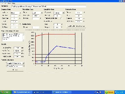

2 things: 1) what is ignition number? number of spark gaps?
2) why is there a blue line as well? Whenever i run it i only get a red line
