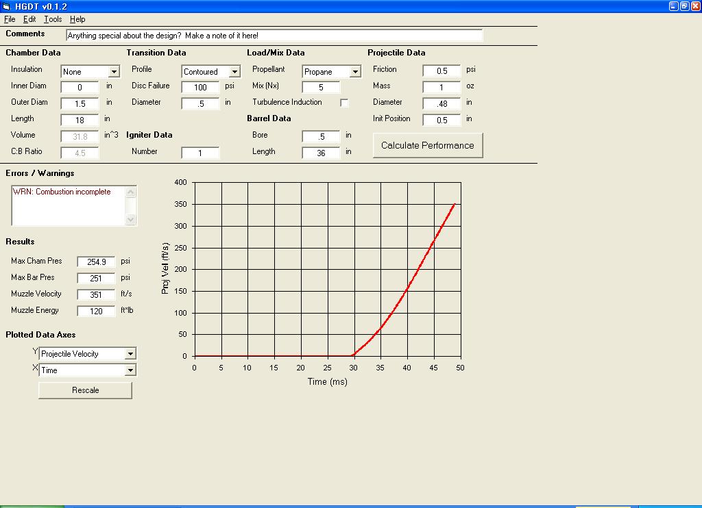

I get a message saying combustion incomplete. what would I change to get complete combustion?

may be the extreme low disk burst pressure..
set it at 340psi etc

pat123 wrote:I get a message saying combustion incomplete. what would I change to get complete combustion?
Alter the chamber shape or increase the barrel length.

You usually get that when you set the disks way too low. There's really no point of using 5x if the disk bursts at 100psi...
