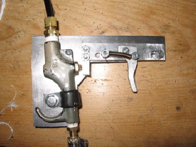

the reason i am posting this here is because i have a few problems that i've run into during planning. the first is the trigger. i could use a blowgun, but that is very common and i dont think it would make a very good triger for a rifle/shotgun that i plan on being accurate. any ideas are appreciated on that. also i just wanted to know what everyone thought about making the chamber out of 3/4 inch pvc pipe and the barrel out of a .40 blowgun.

I haven't used many blowguns in my time, so I can't be much use, although many people will swear by them. Myself, my favourite trigger so far is a slide/sleeve valve, although they are a little pricey.

Ummm, I think this might be of help.?
Edit #1 And this;
http://www.trackofthewolf.com/(S(nzh5rizwbdwwduvvgtsc1x45))/categories/tableList.aspx?catID=14&subID=142&styleID=483
Edit #2 :oops, you did say smooth bore didn't you.
Edit #1 And this;
ragnarock, i know it will never be truly accurate like any of my airguns. i am merely trying to replacate what the old airguns achieved. and after all, they did have smooth bores and used very simple valves of low pressure as well. specifically i'd be happy being able to shoot an index card at 10 yards. aside from that the real idea was to make a shotgun. i think some small sised shot would wreak kavoc on cans if i can get it up to speed.
to everyone else, thanks. i appreciate the thoughts. i will be posting my cannons here pretty soon if you'd like.
gippeto, i'm definately going to send you a pm. lol that gun you made is very simular to what i want to make.
