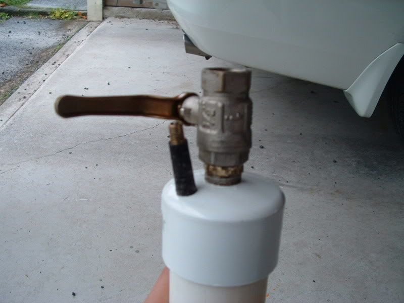

Yes I know that the Pilot and Fill Setup is not perpendictular... I dont know how but it got threaded wrong.

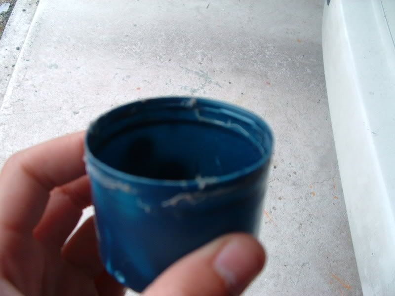

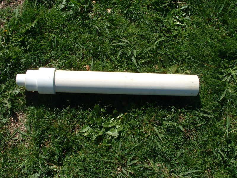

The gun without the end cap

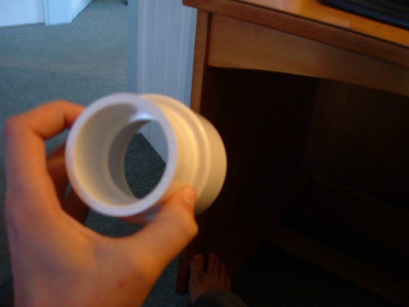

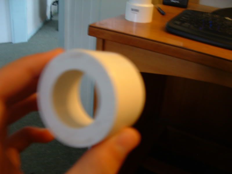

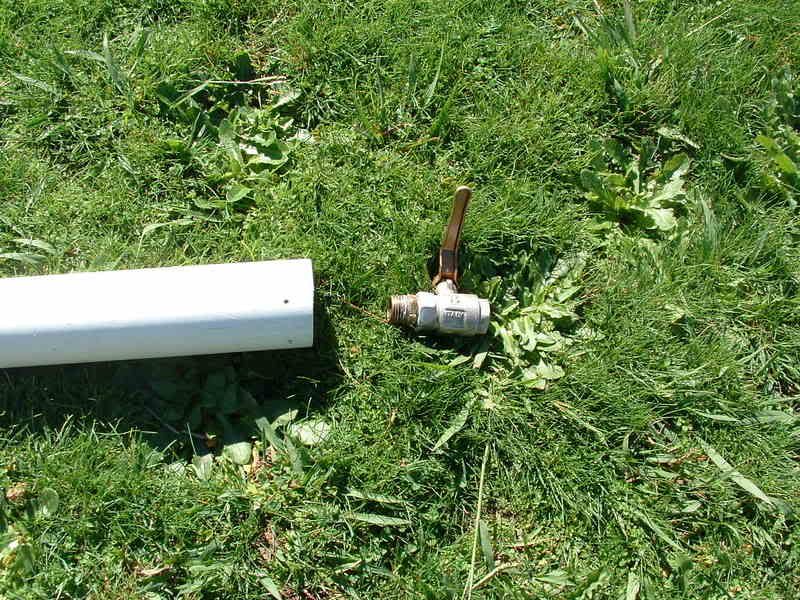

The pilot valve with the rest of the gun

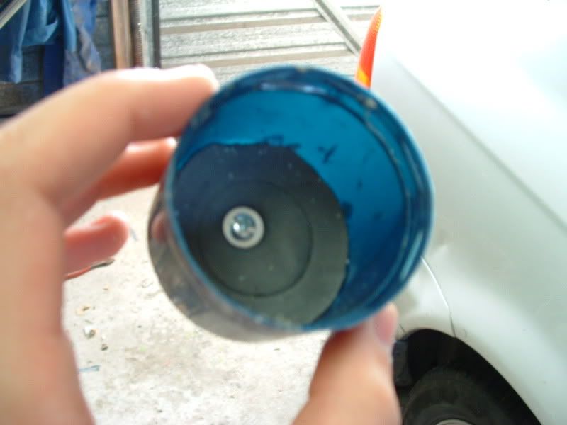

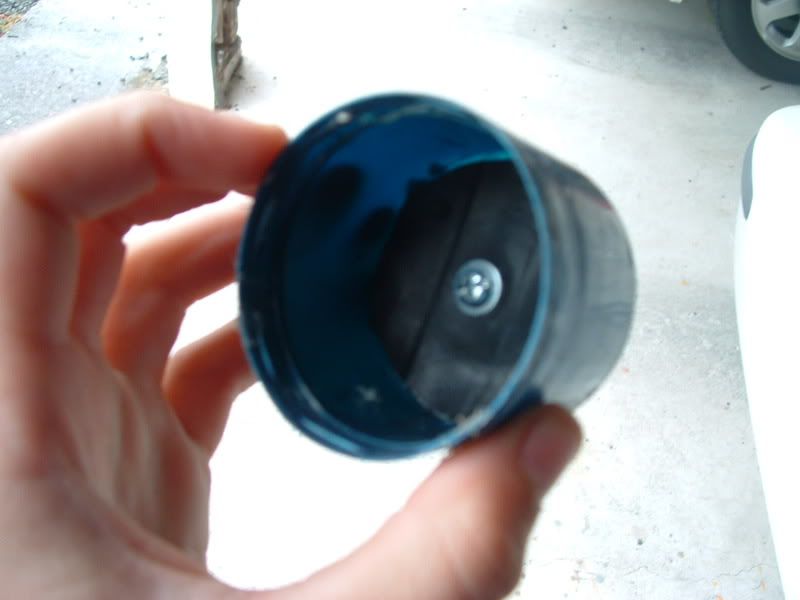

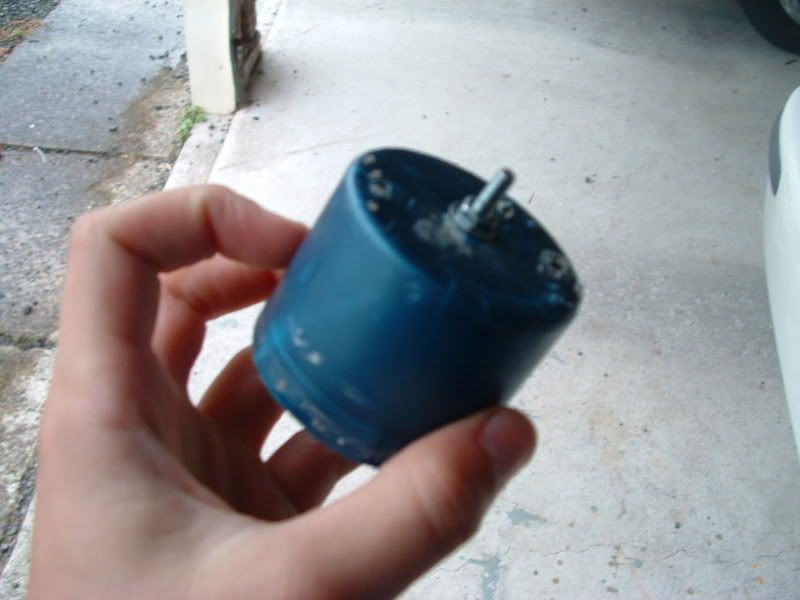

The piston it self with the neoprene sealing face
Have you got this gun working before?
What's supporting the sealing face?
You should probably reinforce the piston too, having it empty adds to the pilot volume.

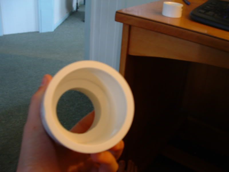

Also that reducer doesn't look pressure rated. Correct me if i'm wrong, but i've never seen one of those pressure rated though they kind of do look it.
Can you tell me what markings are on the fitting?

It is definatly pressure rated. the plastic is 6mm thick in the tinnest place :D The other reducer (you cant see it but it is inside the big one looks like a bushing and it is 8mm thick. On the big one it says: IPLEX pipelines 823.50.40 P0085040 50x40mm uPVC AS/NZS1477 PN18, and the other one says: IPLEX pipelines 824.40.25 P0054025 40x25mm PVC AS/NZS1477 PN18
I got these from a plumber who got them in from somewhere. I asked for pressure and they definatly look the part. The plumber knew it was for a pnuematic spud gun.
Yes I used to have this fireing all the time. What do you mean? The deoderant lid (BRUT brand) is the piston all on it's own and the sealing face is made of pencil case (I think it is neoprene). That may be why it isnt working currently, the piston used to occupy less space but I increased this siz incase something happened. I will try filling the piston when I get some more hot glue. Dont know why but some of the fittings are starting to leak :shock: It may be because they were glued with super glue then I took them off and re-glued.

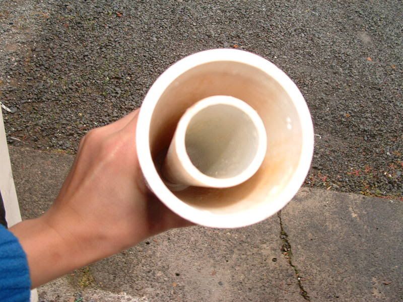

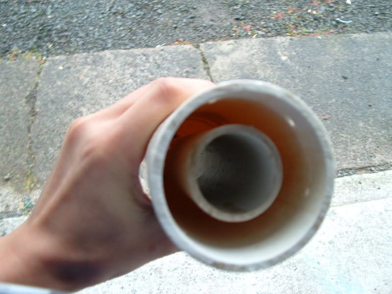

Here are the latest pics. Still no glue so I dont have a video yet.
Hope you like them! :D
Sorry about the blury pics, I didnt have a flash diffuser so I couldnt take macro phtos inside. :(
Okay they appear to be pressure rated. Did you use primer when gluing the fittings on?
Ha, it appears your piston is backwards...the sealing face goes on the otherside. And a plastic cap will need to be reinforced.

No :oops: I cant really afford it. I know that it isnt a good thing not to use the PVC glue but at like 15 - 20 for a small amount of glue, super glue is so much cheaper and as I have seen the fitting breaks before the glue does (I have had PRESSURE fittings and PRESSURE pipe snap when trying to remove the parts before the joint fails. This is ver re asuring to me. Is the piston backwards a bad thing? I have it working now :D. The hot glue makes an excellent seal with the PVC with the super glue holding the part on. I only go up to around 100 PSI even though I know the fittings and piep are rated for a minimum of 213 PSI. Finding neoprene is so hard for some reason, what are the washers called? When I went into my mitre 10's plumbing section the staff had no idea what it was (the lady I spoke to has been working there for a very long time and is a gold mine of plumbing information)
