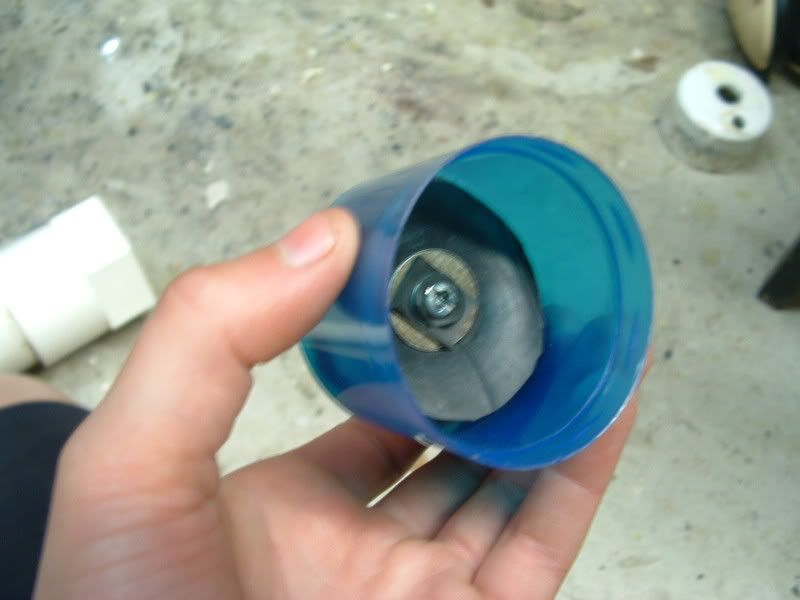

At last this thing is complete. I have learnt a lot along the way and this thing is my first and last until I leave university.
The Specs:
Chamber: 50mm Pressure PVC (No DWV in this cannon)
Barrel: 25mm PVC
Valve: Piston Valve made from a hairspray lid. The sealing face is two layers of bike tire tune. The rest of the valve is bulked out by a cister washer (about 6mm thick)
Pilot: 15mm ball valve
Fill: Shrader Valve
This whole cannon provide a great wealth of knowledge. This cannon was how I learnt to solvent weld, joined this forum, learnt about seals, pistons, and got a good feel for NZ price.

The less colours I can use on this the better... (As I have stated im no the richest person in the world...) I have got brass fittings at the pilot/fill end then leak... I have used teflon tape and tightend them. Any solutionas on how to fix it? This baby is great with water as the ammo, shoots the same range as a super soaker but instead of a stupid little stream it is a massive 1 inch blast (not quite a shot gun style blast.) Video comeing soon.
EDIT: And now I haveing problems with the sealing face. I use your run-of-the-mill bike innner tube. This gun rips holes in them (told you it was bad ass!). Any suggestions? I am trying to find a completly new face unles there is something I am doing wrong with the bike tire tube...

Most commonly people use neoprene rubber found at harware stores or mcmaster.com.
Also you can use silcone cases. Like the squishy things people put on ipods and wii remote controlers.

I have used neoprene from a stubby holder but ot no avail. Perhaps i should explain the problem... The gun now rather than ripping small holes in the face, it cracks the face and it slips off the nut. I have one more thing to try, I am going to try tightening the bolt. Currently I squash the face down and tighten with my finger. Would makeing it super tight help me? My Dad suggests getting a larger washer (The one I have has about 3mm clearence all around).
EDIT: I have tightened the bolt a whole bunch tighter and has fixed the problem. I once read here somewhere that you should tighten everything as tight as possible. This baby is awsome with water, Has a good recoil kick, and then the target is soaked (about a 5m diameter blast from about 4 meters away.
