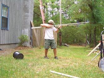

This is my first air cannon, it is very simple, with just a ball valve and is filled by a tire pump. It take about 60 psi and is quite powerful. I put an AA battery about an inch into a tree stump.

Nice job! Specs?
bigbob12345
Posts: 1516
Looks good for a first
But I would also like some specs and if possible a couple close up pics so i can see if you used DWV or not.

bigbob12345 wrote:Looks good for a first
Yes close ups please... :lol: at BB....

No DWV except for endcaps.

hmmm probably should get pressure rated endcaps especially if your going to take it over 60 psi

If I make another,better gun with sprinkler valve wiil use pressure rated fittings.

Specs:
I havent't measured exactley, so the lenghts might be a little off
Air Chamber- 11/2 in. PVC (about 4 feet long)
Barrel- 1/2 in. PVC (about 4 feet long)
Ball Valve- 1/2 in PVC

bigbob12345
Posts: 1516
Because you didnt give me close ups I had to take the one pic and zoom it like nuts and I have determined that yes you do have a DWV endcap but it looks like a you have a bell reducer too, its hard to tell because of the fuzzynes when its zoomed so i may be wrong.
But even if I am wrong YOU HAVE DWV :shock: :shock: :cussing: :protest: :protest: :violent1: :tongue2:

I looked and the encap is DWV but the reducing is pressure rated-that and its about an inch thick righte there.
Next time will include closeups.
