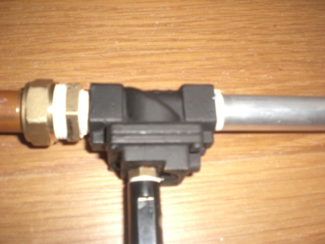

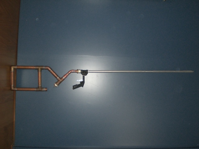

this is my marble gun :D
it use a sprinkler valve
the piping for the chamber is 28mm
the barrel is 16mm (marble)
I haven't shoot with it but I did some tests and the pilot valve starts leaking at 6 bar :(

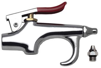

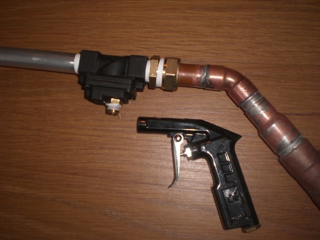

Nice gun mate. The problem is the blowgun you're using. They aren't meant to be used flipped around in that fashion. The Poppet valve in the blowgun when it's hooked up properly, uses the pressure behind it to push and make a seal firm against the blowgun lip. If the blowgun is flipped around, the poppet valve is only as strong as the spring behind it so it will leak at a cirtain point. The pressure will be too much for the poppet valve spring so just like a pop off pressure release valve, it'll give way eventually. At 30psi for example.
The solution is very simple. You need the inline style of blowgun that can be bought for a few bucks. I hope this helps mate :wink:

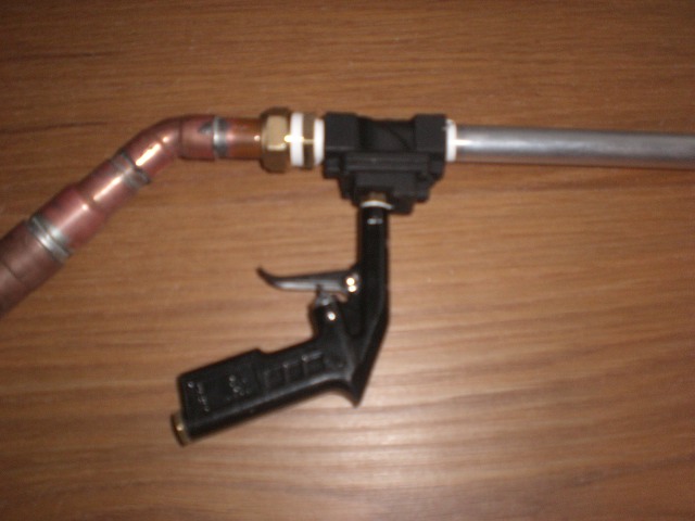

Or you could flip the blowgun over like so...

Yeah thats another idea aswell. 2nd Option is to just run a bit of hose from the bottom of the gun to the valve. There shouldn't be a great deal of pilot area.

I will just flip it around I don't know if that works

Yeah flipping it around would do the trick fine. Happy spudding! :D

I just tested it with the valve flipped around and it works :D
